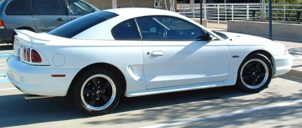

Maybe look into the FRPP B Springs. I just recently lowered mine with these springs and Tokico HP shocks/struts. The ride is acceptable and the stance is nice. Dropped more than expected, approx 1.5 in the front and 1.25 in the rear.
I think total I paid 150 for the springs and 250 fo the shocks struts. I was able to get alligned without CC plates. I did install off-set rack bushings to help out. The car rides good and the handling is 10X better. No bottoming out issues so far.
