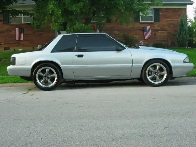

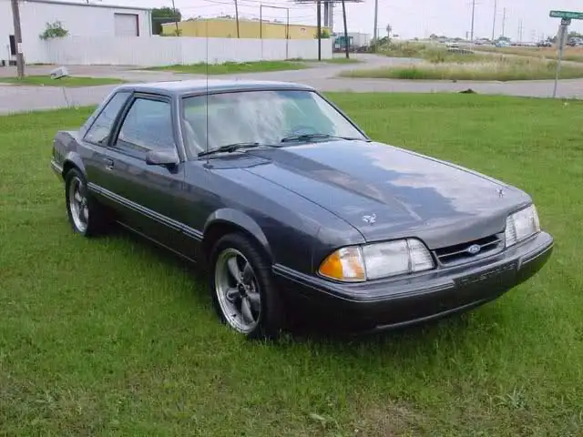

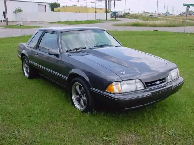

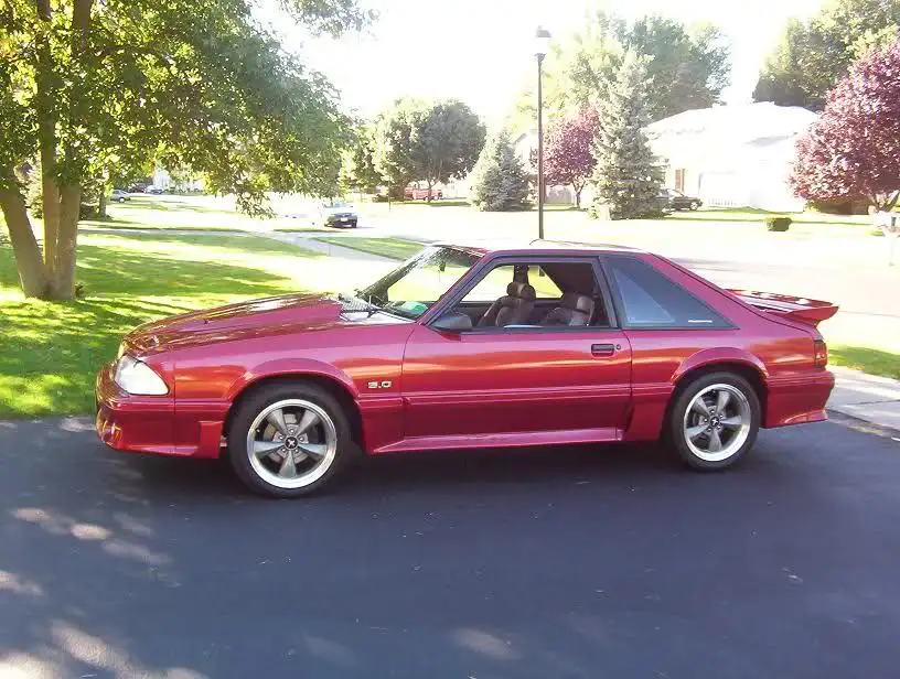

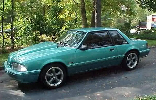

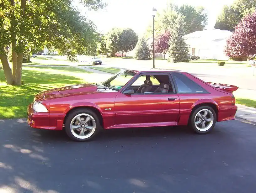

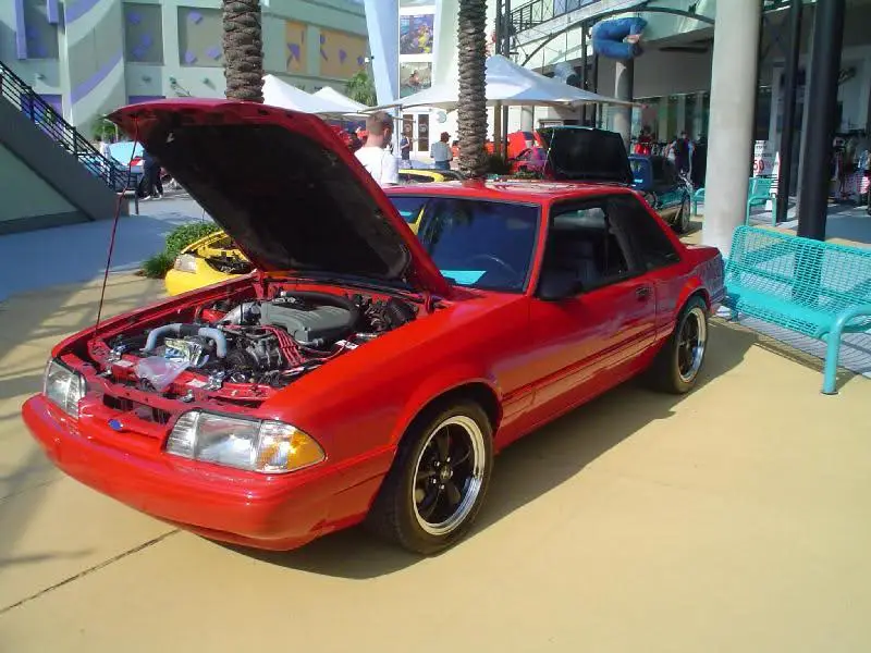

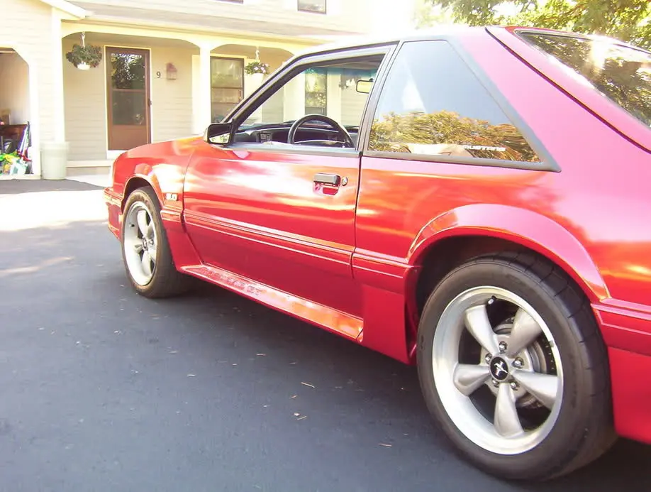

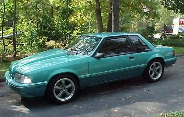

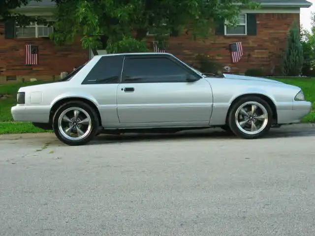

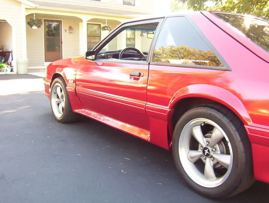

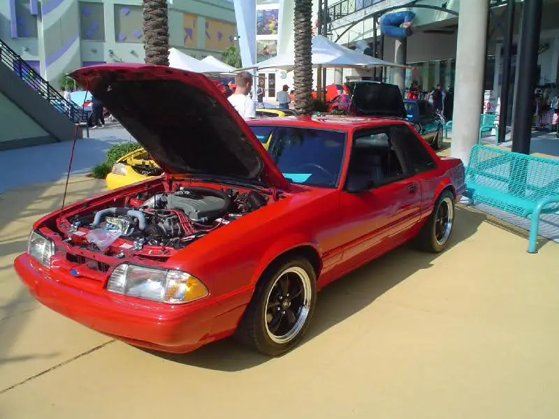

i used the SN-95 conversion 95GT spindles, rotors, calipers and then i used FMS 28spline 29 5/32 5lug axles the whole conversion took about 2hrs the back wheels sit in a little so spacers might be an option at a later date but they are fine for now here's some pics first couple is my car then next are some i have accumulated from other sites...

That red Notch with the black bullets is killer. Any of the Notches above are nice. I'm so pumped that I got a notch instead of a hatchback......i did just see some decent prices on Ebay for black bullet replicas if you're willing to have replicas...
