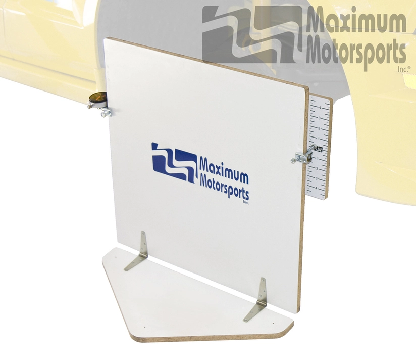

Okay, enough of the preaching. :) On the "other site", MFE did a nice thread/write_up of how he does his bumpsteer measurements.
But, since I those links get filtered, and it's still what he did, let's instead just go to the (IMHO) one place and company that so far hasn't decided to screw people by selling cr*p products and spreading pure and total BS and lies.
If people have to think about which company I'm talking about
Just go here: :)
Bumpsteer Gauge [MMT-4] : Maximum Motorsports, the Latemodel Mustang Performance Suspension Leader!
Instructions:
http://www.maximummotorsports.com/content/install/pdf/steering/MMTR-2-4-7r2.pdf
Oh yea, as I often say, do not take my word for it. What I said can easily proven or dis-proven. Yes, for a massive ~$200, people can easily post their results and prove that their stock_height or lowered Stang (without any other suspension mods) has no bumpsteer at all! :)
