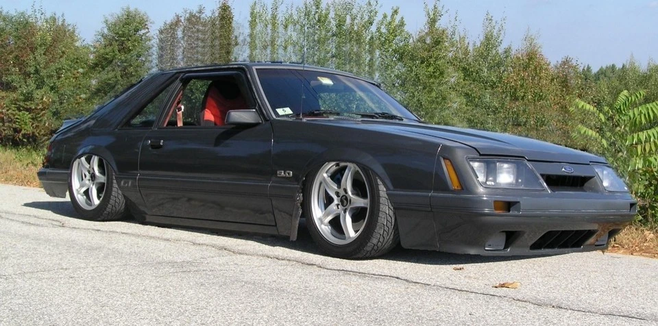

bumpsteer on 1.5 drop?
And, yes, ants have more ground clearance than my car.
