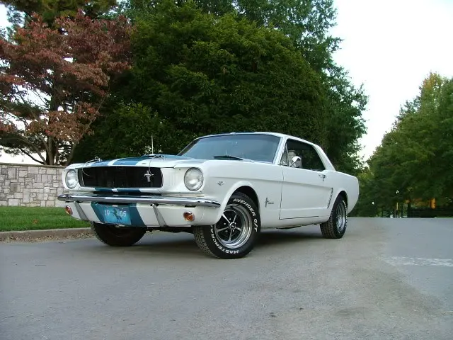

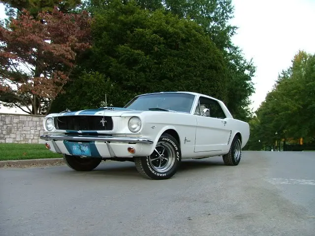

my favorite "stock" rims are magnum 500s
14's
