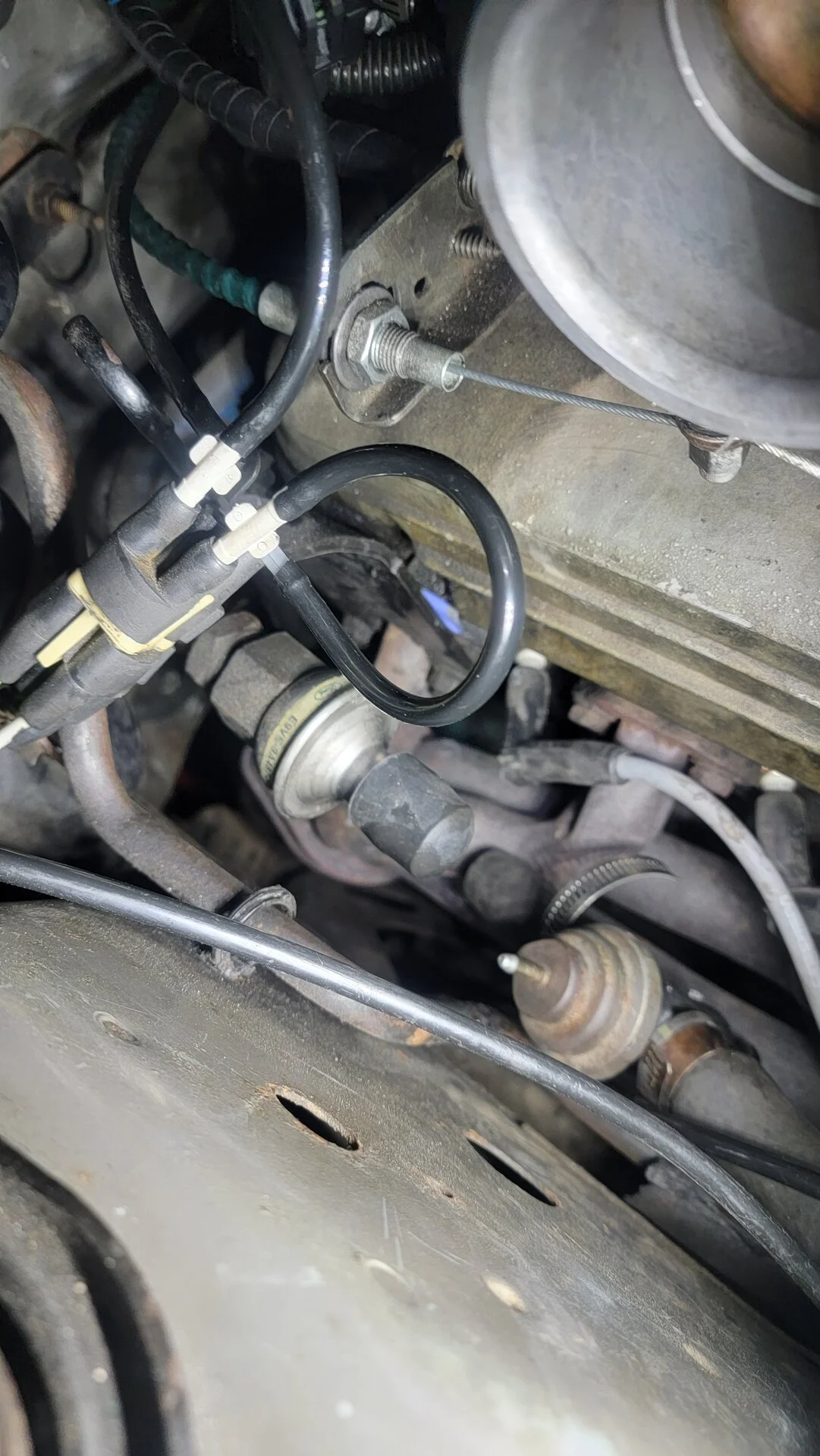

so the pipe on the back of the heads I can just cap it off at this big round thing going to the smog I'll see if it lets me post a pic and sorry I see it's a old post but this is were im at with being a 1st time owner and my vacuum lines please help me with this and I have a cap on the end to see if that's correct
put a hose clamp on it.
no cats right?
