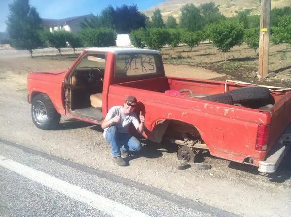

If you have drum brakes, and the C-clip fails, this happens.
With disk brakes, like said previously, the caliper bracket might keep the axle in....provided you aren't in a high G turn and overstress the bracket. :)
