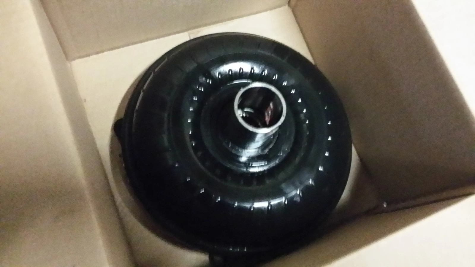

stall speed should be between 3400-3600. steve agree'd with me that going looser wouldnt help anything since i have such a short power band.

9 inches of billet goodness

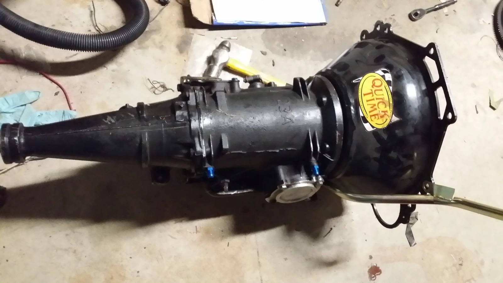

New bell housing is on... converter is fitted up with the trans and flywheel. Backing plate is fitted up also. Just need to get off my ass and pull the pilot bearing out and get the trans bolted up
