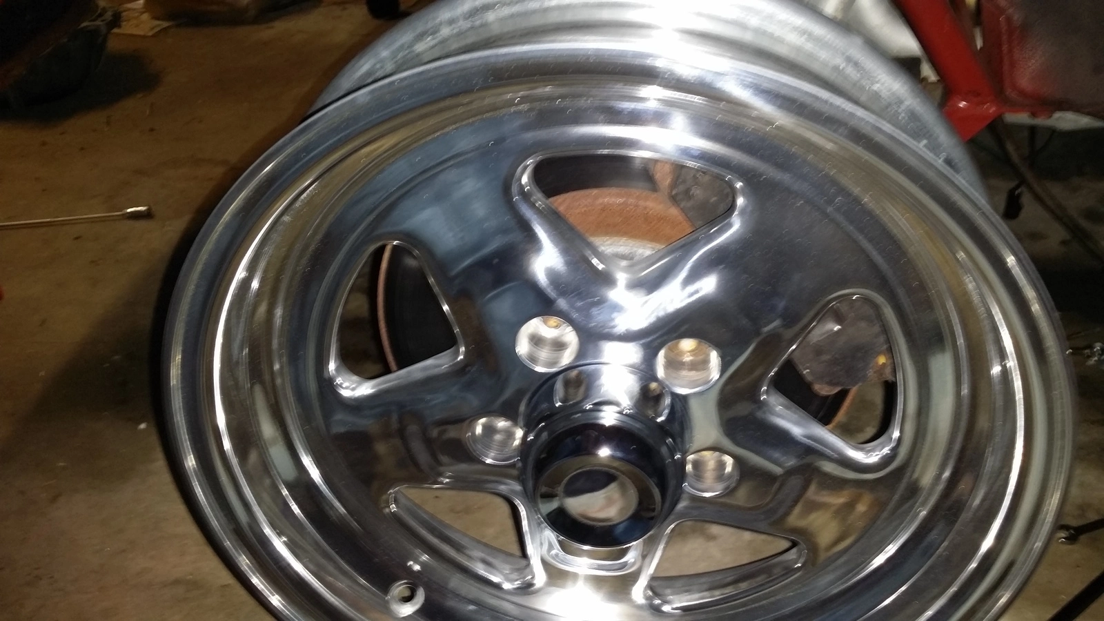

so a deal popped up that i couldnt pass up... so some of my trans money had to be moved to buy them
brand new in the box for a STEAL... gotta order lug nuts and 3" front studs still. oh and tires
