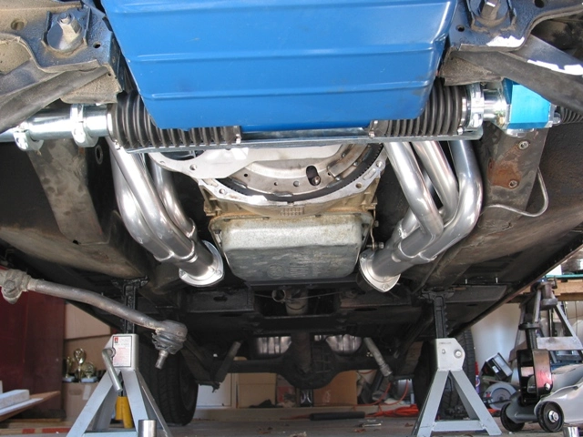

You may have trouble but will probably be fine. I put hedmann elite's on my 351W/AOD combo, they fit fine in my 67 vert.
http://www.edbert.net/randp.htm
Edbert, Great Pic! I'll take a picture tonight and post it to give you an idea. Do you think I can use my existing Convertor for the AOD? Again, its 1000 mi. old. The studs will line up onbviously with the flex plate (if I can use that(can I?)) but will the Convertor slide onto the tranny shaft?

They are hedmann elites, part number is for a 351W swap, they bolted right in, took me less than an hour for the pair. I did this the weekend after helping a buddy get long tubes into his 2001 WS6, THAT job took 12 hours and much cursing :bang:
My 8qt pan is slightly lower than my long tubes, and they are not for "low clearance" situations. Also, if you are doing this in a 65/66 you MAY have clearance issues, but a 67-70 will have tons of room.
OK, I'll rephrase that, if you use hedman part # 88300? , 1 5/8 primaries, you are going to have problems...

Mine were #88300, for use in a 64-73 Mustang, 260-302 CID.
Gotcha, I was worried there!
The 351 has a taller deck height (duh) which causes the exhaust ports and the header bolts to be higher in relation to the chassis. This necessitates headers that take that into account. Get a set of swap headers and you'll have tons of room in a 67-70.
