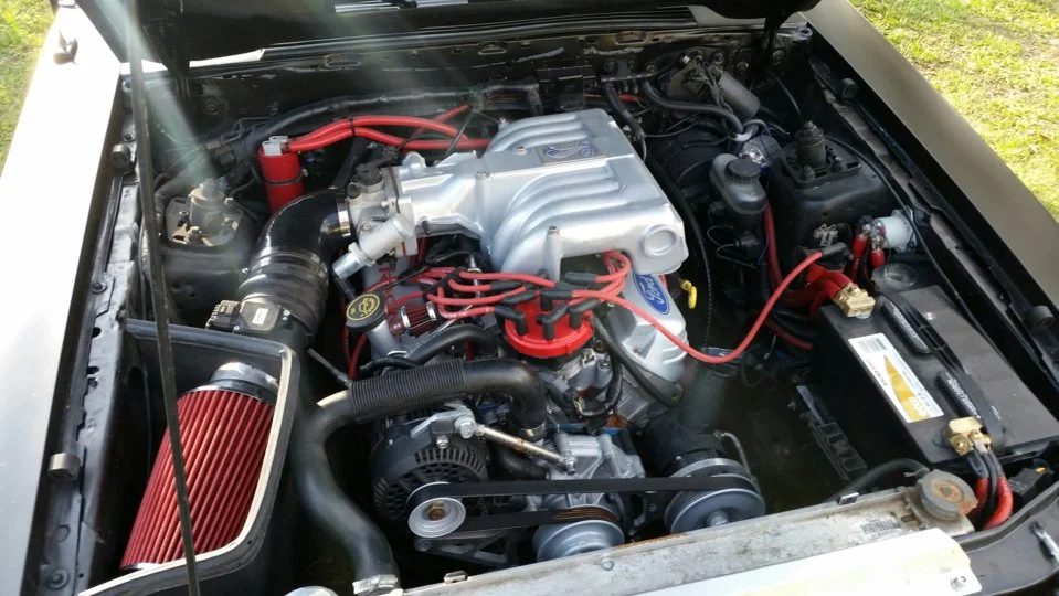

Jrodstang87 said:
That's what I thought about injectors. I will be going with a custom ground cam. And the intake may be switched for a trick flow. That's not definite. But that's a pretty solid combo, and I assumed I would definitely need 24# injectors, and I planned on going with a 255 pump.
If you are going with a custom cam, I would get 30# injectors and at least a 75MM MAF. No sense in maxing out your injectors and it gives you room to grow.

  • #22
^^ x2 on what Mike said.
Also look into a edelbrock RPMII or Holley SystemaxII. Best efi intakes for what you're wanting to do. I just sold all my stuff(80mm pro-m,30#inj,systemax intake,tfs 11r heads,custom cam). I didn't get to see the end results but the cam guy and dyno tuner I was going to use expected around 400hp and 11sec et capability while still being relatively mild/daily drivable.

mikestang63 said:
The 94/95gt MAF is 70MM
Get rid of the U/D pulleys. They are not worth the 5 hp at 4000rpm in exchange for worse cooling and heating
Any aftermarket CAI is really just for looks as the stock airbox is a factory CAI. Add a k&N filter and it will flow just as well as a fenderwell unit. ( full disclosure I have ran afermarket CAI's on all my N/A cars as they look better)

Jrodstang87 said:
Interesting concept on the pullies, but with a stock fan, I don't have cooling issues yet
has nothing to do with the fan. U/D pulleys slow down your water pump by 10-15%, making your cooling system work harder and less efficient. You won't notice it as much on a stockish motor.

Jrodstang87 said:
Wow impressive. I was under the impression that with 30# injectors the computer isn't really capable. That true? I would like to get some driving possible without a tune.
If you get an aftermarket MAF "matched" to the injector size, it tricks the EEC by adjusting the MAF signal voltage. You don't need a tune for THAT issue. You MAY need a tune after an HCI swap for other reasons.

My thoughts,
When you first convert the car, get a stock maf (someone will probably give you once for free) and run it with 19's and make sure all is good. I'm not saying go WOT, just get it to run and idle properly. If the maf swap doesn't go right it will be one less place to look for the problem, and trust me, people have problems.
Second, Look into an Anderson ford NA power pipe. Yes you are going to have to recut a hole in the engine bay, but if you don't and you build a heat shield and every hole is closed up, where exactly are you going to get the fresh air from?
You can get the one that goes into the fender right in front of the shock tower.
If you use the power pipe get an 80 or bigger pro m.

I have a speed density 88 GT mostly stock with bolts ons including pullys. I was running a little hot even with a 160* thermostat. Put in a new water pump, alum. Radiator with royal purple and now in 60* weather it runs nice and cool, won't go over 160*. We will see how it is on hot summer days. In the next month I am adding a ported Cobra intake, GT40p heads with trick flow springs and 1.7 rollers, 255lph fuel pump, Cobra grill insert, and a bunch of other stuff. I plan on going speed density but supercharge at the same time so it will be big bucks for big MAF, injectors, computer, and new heads. That will have to wait till next year. Since we are both speed density I have to ask: how well did yours idle and run?

For the same cost of the maf conversion you could do an aftermarket ecu.
That would allow you to do whatever you wanted to and remain SD. It's not an option if you have to pass inspections, most people don't want to program for the smog pump and egr but I could make that work if you went that direction.....
If you do, I suggest a mega squirt pnp unit. Or you can get a diypnp if your not scared to do some soldering it's not difficult.
I will extend the same offer to you that I do all other members here, I can help you tune the car. This system is even capable of Coil on plug or coil packs if that's your thing.
I still think the heat shield would work well you will pull in cold air from the headlight area, do you really want to cut a hole after all the work smoothing the bay?

Jrodstang87 said:
He'll no I don't want to cut that up. I like the idea of getting air from the headlight area. I would love to do a DIY PNP bit I thought that would require lots more money than a MAF conversion. Last in looked anyway, that may have changed
You can build your own for 450ish.
That's what a few of us did, no maf needed never have to pay for a tune. Hell with an 80$ software upgrade you can get the tune close then let it auto tune while you drive.
The only other consideration would be the need for a wb. A good mtxl will cost 150-180$ on ebay.
