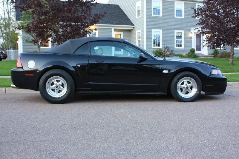

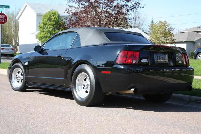

Here's a vid of my 03 Centennial Edition with stage 3 Comp Cams, stock manifolds, Bassani offroad X pipe, magnaflow 2.5" piping and 2010 GT 500 mufflers (and a Vortech V2SQ SI trim)...
YouTube - ‪03 Mustang Comp Cams XE274H‬‏
My ceramic long tubes go on this month :)
