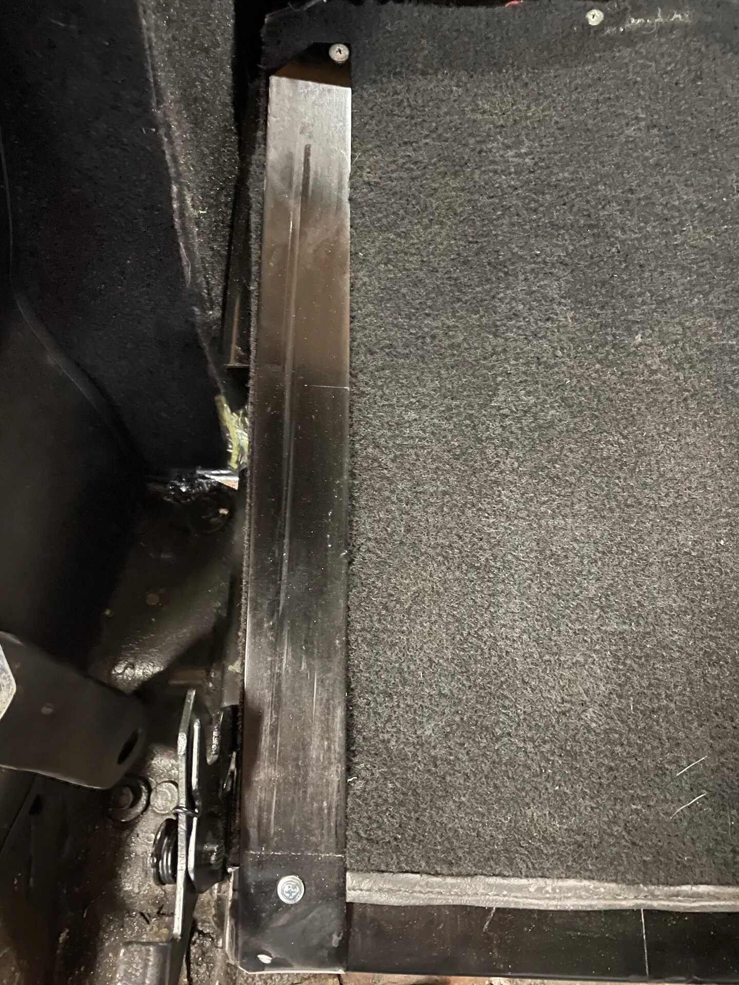

OK fellow II owners. I’m going to start out with an apology from the beginning. I am so sorry. Now in my defense, I am 52 years old and my memory isn’t what it used to be. I’ve built many cars in my years and I tend to forget some of my “good ideas”. Anyway, I finally figured out/remember what these pieces are for. Many, many, many years ago, I built these pieces out of thin anodized aluminum for this car. They are used as sliders for the rear seat folding mechanism. As soon as I started installing the carpet over the back of the seat back bracket, I remembered. Like a light bulb turning on. Anyway, if anyone has the same issue I have with this car and my Cobra II, you may want to do this. Every Mustang II I’ve owned had an issue with the folding rear seat getting hung up on the carpet when putting it back up right. The panel that is supposed to glide on top of the carpeted back panel of the seat always gets hung up on the carpet itself. Most of us just lift up slightly on the panel and then it slides just fine. Well I wanted this to be a one hand operation and there for created these sliders.

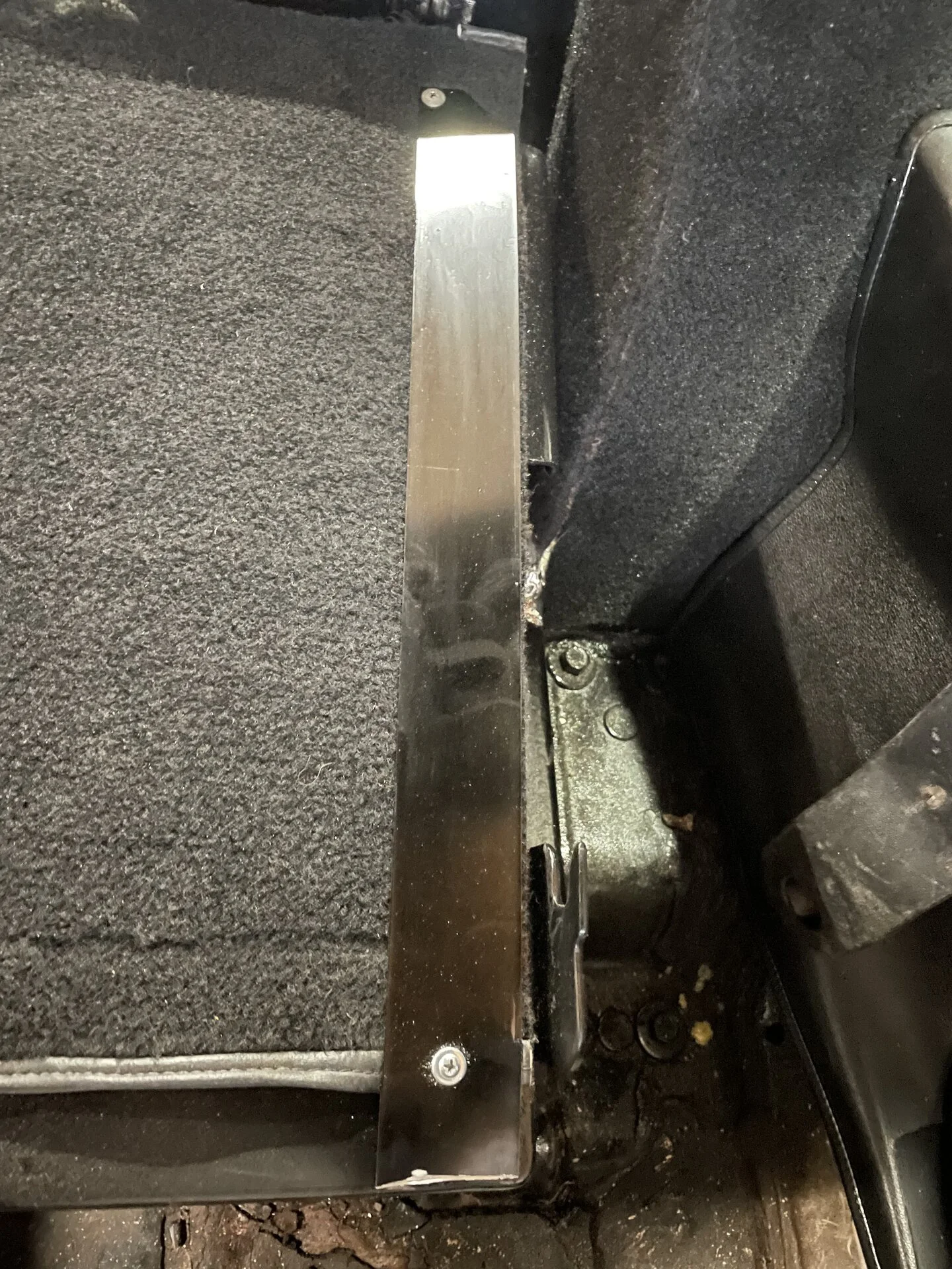

Again these are made out of thin anodized aluminum. You just simply drill a hole in the bottom of the slider to align with your current existing sheet metal screw that holds the bottom of the carpet down. Then you drill another hole at the top to hold the top of the slider in place. There’s not an existing screw for this. So you’ll be asking your own. You want the aluminum sliders to be along both outer edges of the carpet

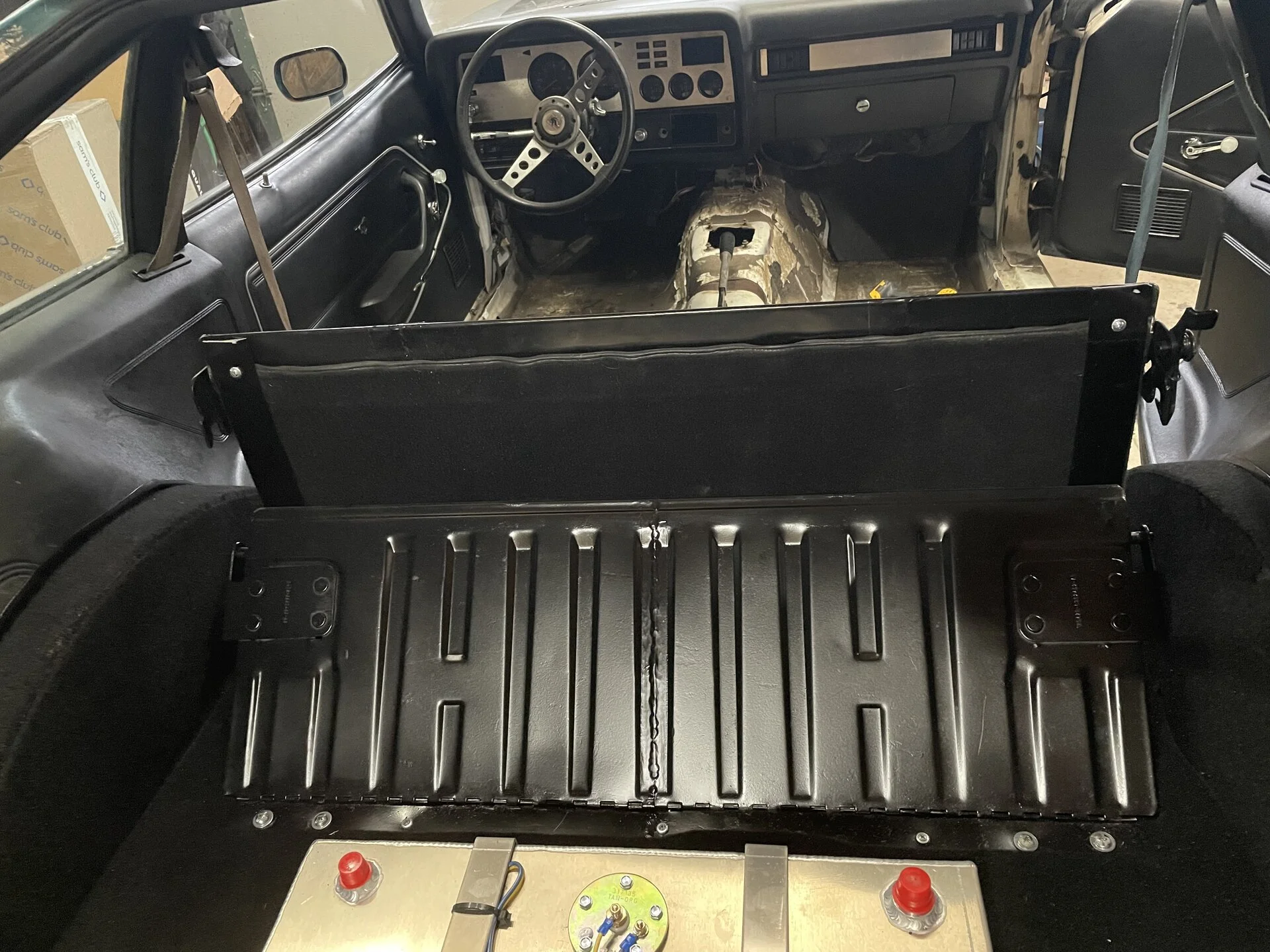

Here’s what it looks like folded down. Now keep in mind I don’t have the seat cushions installed yet. So my bracket doesn’t lay flat yet. And the rough cut upper edge is covered by the seat cushion itself. But you can see how the sliders are installed.

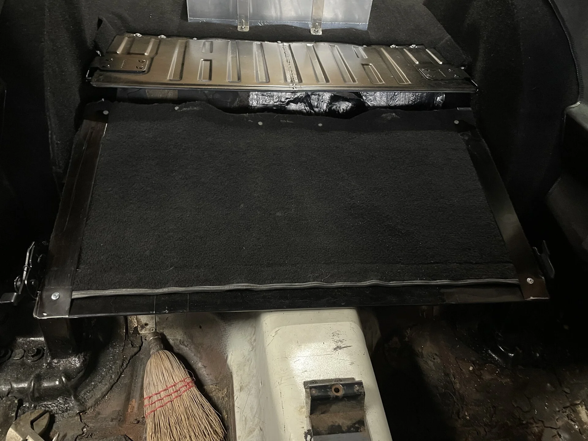

Here’s a shot from the back with the seat half folded. This should help explain the concept.
I slightly, not even enough to notice, bent the corners down on the fold down support bracket so they are the only points of contact. And they ride on the anodized aluminum sliders. Nothing touches the carpet. This makes the seat folding up and down process extremely smooth. Literally a one handed operation with no hang ups or binding. It also preserves that piece of carpet from getting worn out, bunched up, and eventually torn like they almost always do. If you are having issues with your rear seat binding or hanging up when trying to put it back upright after being folded down. This is your solution.
