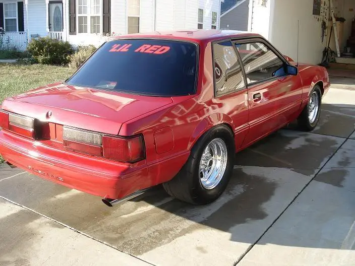

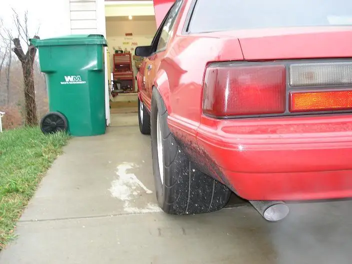

what to do to fit these on a fox? also, does anyone make a 295/50/15 drag radial? i have 15x10" prostars with 6.5" bs.
Another view
wow! thanks for the pics! those 325's look wicked on a bad ass coupe! few q's for ya:Yes, if you use a big enough hammer.

That coupe posted above I believe belongs to Brent Davis from turbomustangs, I pretty sure it has a homemade mini tub and the tires are M/T 325/50's. To do it right you have to mini tub it to run 325's.
