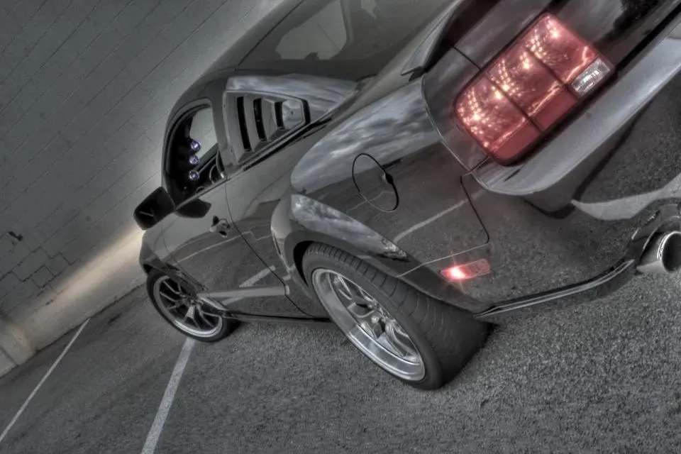

flyboy86 carried over his new edge wheels to his S197 and although the rear wheels/tires stick out a little bit, they work and he loves them.
Oh yeah!! lovin those!
yeah I think they will fit too. If they scrub the shocks Ill just get some spacers (any idea on how to calculate size if I ever do need them?)
Im really excited now!!! I talked with one of my friends and he was pretty sure they would work too!
i don't think you'd have to worry about anyting on the inside. i'd be more concerned with the fender in tight turns and such, and going up driveways. cause its gunna stick out more then the correct wheels for these cars. but liike the picture kooldawg posted, it looks like it fits pretty damn good.
