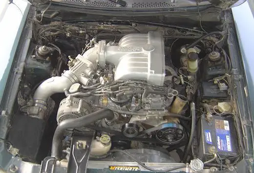

These are some reference pics I took at a junk yard last year for my last project car. Not the greatest but maybe they will help some

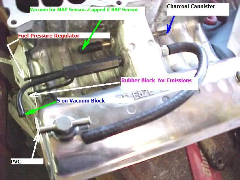

ok lets try this,
in red where does the vac line from the map sensor go to? does the fuel regulator feed from the manifold vac tree like i have it and the same with the egr valve.
does the line in this pic for the canister plug into the top of the throttle body?
what do i do with this bulk vac plug since i have no smog?
MAP vacuum line goes from sensor to the bottom of upper intake to the large vacuum port next to the hex shaped vacuum manifold.
The fuel pressure line is correct.
The vacuum for the EGR can be hoked up like that since you don't have any smog.
The line for the charcoal canister goes under the bottom of the upper intake to the port in fort of the MAP sensor.
You need to plug all the vacuum port on the vacuum block.
