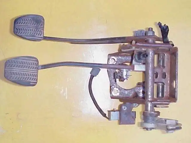

I need to install my bullitt pedal pad on my clutch. I got the other 3 pedals on with no mods, but the clutch pedal needs to be modified.
I noticed the pedal is held on the shaft by a nut at the end. Can I easily remove the nut, and slide the pedal arm off? Is it that simple?
I know I need to unhook the clutch safety switch as well.
Does anyone have a pic of the clutch pedal assembly outside the car for a clear view of how it all hooks up?
Thanks
Ok, how bout this? Could I just unbolt the pedal from an sn95 and install it on the fox assembly? Would allow the pad To mount up correctly with no trimming
The nut I am talking about is on the top of thenpic
You know Mike, I think you may be onto something! I never thought about swapping the pedals. I would think even if Ford changed the pedals a bit, they would have left the top mounting part the same, the clutch rod and lever, for all fox based cars. Do you have a SN95 pedal assembly? I could try and pull one from my local pick a part and see. Actually, we could just check to see if the quadrant assembly is the same Ford part for Fox and SN95 cars. LMK.
I don't have an assembly now. I only just thought of this last night. Right now, local boneyards are mud pits so i gotta wait a bit before i head over due to going during lunch @ work.
I figure it would be as easy as unbolting that nut, and just sliding the pedal arm off? :shrug:
If that's the case, i'd rather swap arms. My clutch pedal is the pedal i use the most, so i want to make sure the bullitt pedal stays on there well without cutting or glueing
