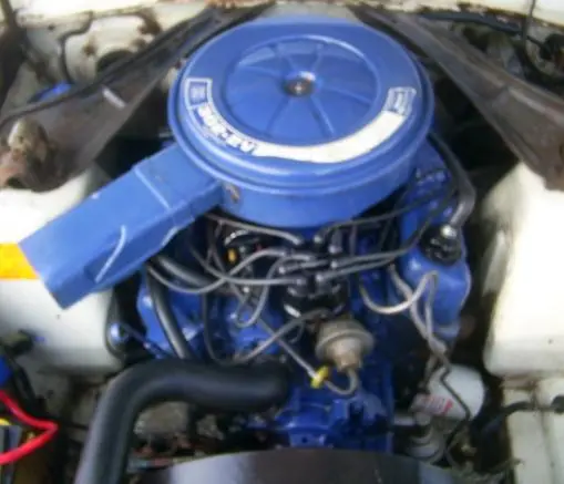

Added a pic of the 302.
Doesn't look like much.
I want to keep it that way... no matter how rad it gets in the future.
I have added Duraspark and swapped the 1850 for a 650 DP since this pic, but it still looks very much the same. The dizzy is single can now is all.
