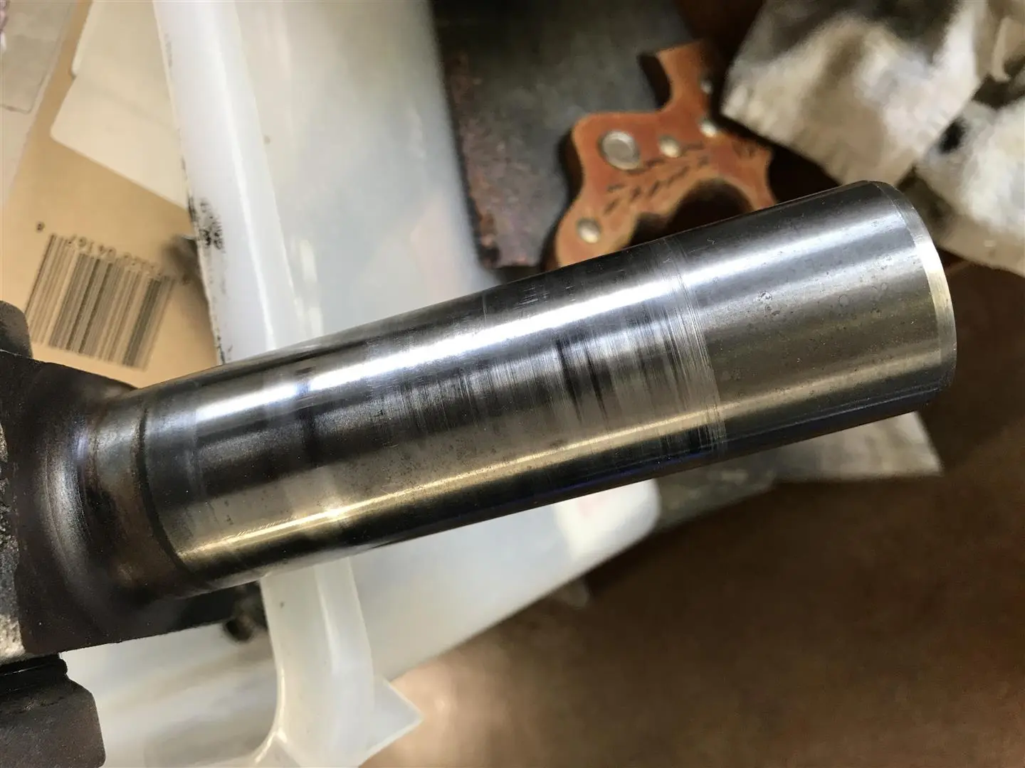

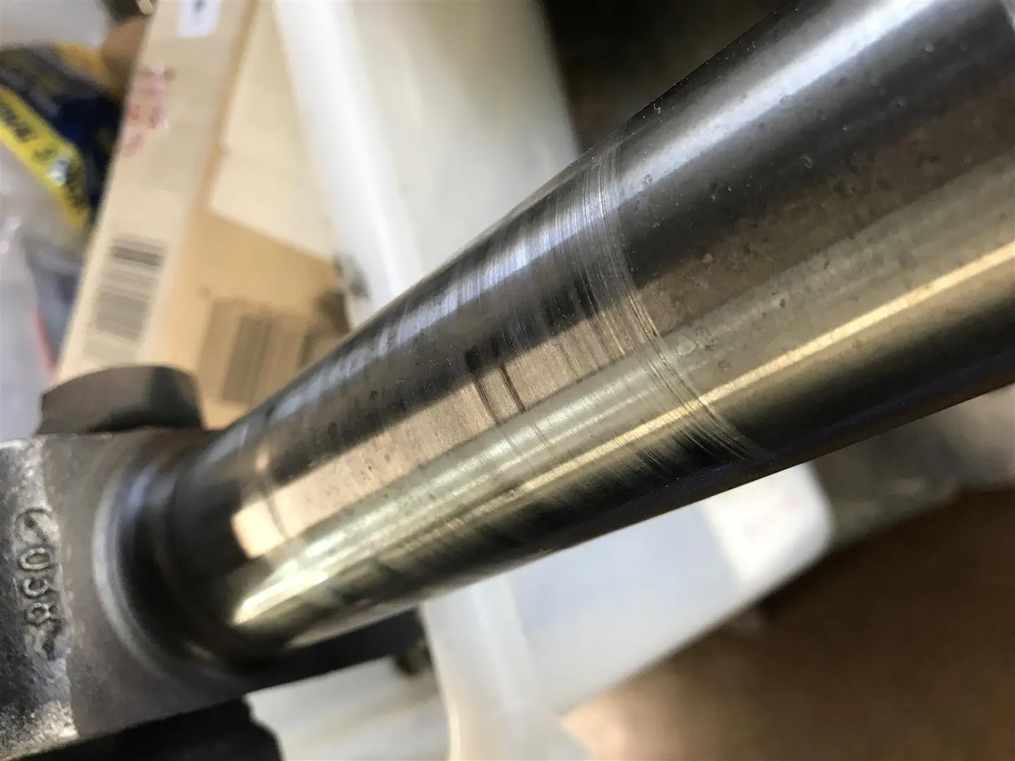

  • Removed the DS. I inspected the u joints and they feel smooth and tight. No noises when moving them by hand. Nonetheless, I took the DS down to a shop to have them replace the u joints for good measure.
  • The tailshaft yoke did have some wear and scoring. The shop is going to smooth that out as well. Picture attached. Does that wear look normal? Didn't seam TOO bad to me.
  • While the DS was OUT of the car and with it up on jacks, I started the car and ran it through all the gears. ZERO NOISES. This tells me it's something with the driveshaft itself or the tail shaft yoke.
  • While at the shop, the owner said it's imperative to also replace the tail shaft bushing and tailshaft seal, stating the tailshaft bushing would be worn just like the tailshaft yoke, which does make sense. (like I said, the tail shaft yoke didn't seem that bad in my opinion, but what do I know!)
  • Thoughts? Is it indeed imperative?
  • Could it be that when the tranny was recently rebuilt, they replaced the tail shaft bushing, and the squeal I'm hearing is the tail shaft yoke attempting to cut new grooves into the bushing?
See attached pics of tail shaft yoke...
