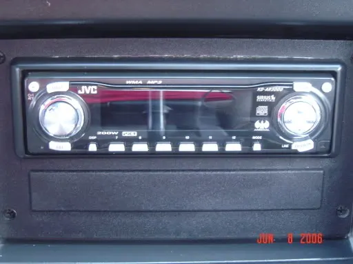

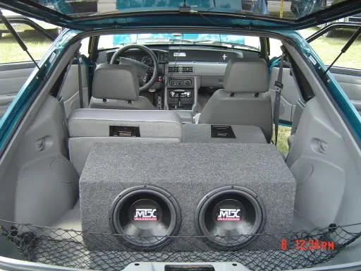

Yes, the factory amp is not doing anything now, running all 6 speakers off of my JVC KD-AR3000. I also have two 10" subs, but they are running off of a separate amp.
