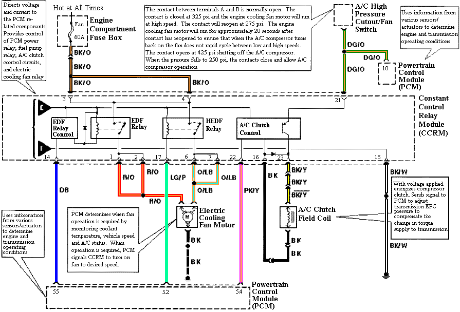

Were it me, I would start with a wiring diagram so that you can map the sequence of events that cause the fan to go into high speed. You shouldn't have to run many traces if that's the only problem.

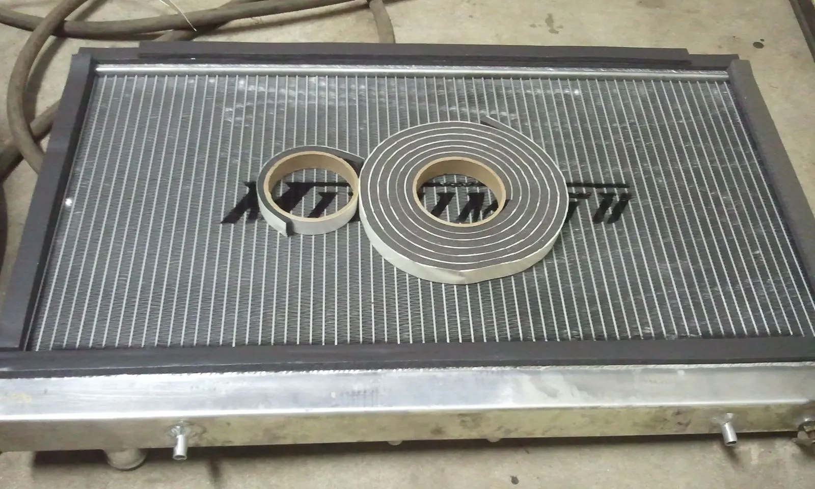

One other thing that comes to mind is sealing the air gap between the radiator and the condenser. I saw that you said you changed radiators out. Folks often neglect that little detail. You can use the adhesive foam weather strips that you would find in any hardware store. The path of least resistance for air is the gap between these two surfaces... Sealing that gap will ensure air is being pulled through both heat exchangers.
Diagram courtesy of www.veryuseful.com

Do you have any pictures where you applied it to? Like what areas exactly?
This image is from a different car but you get the idea. Apply the weather strip around either the condenser or radiator so that there's no air gap in-between. This forces the air to go through both vs. being drawn from the gap at the outside edge between the radiator and condenser.
