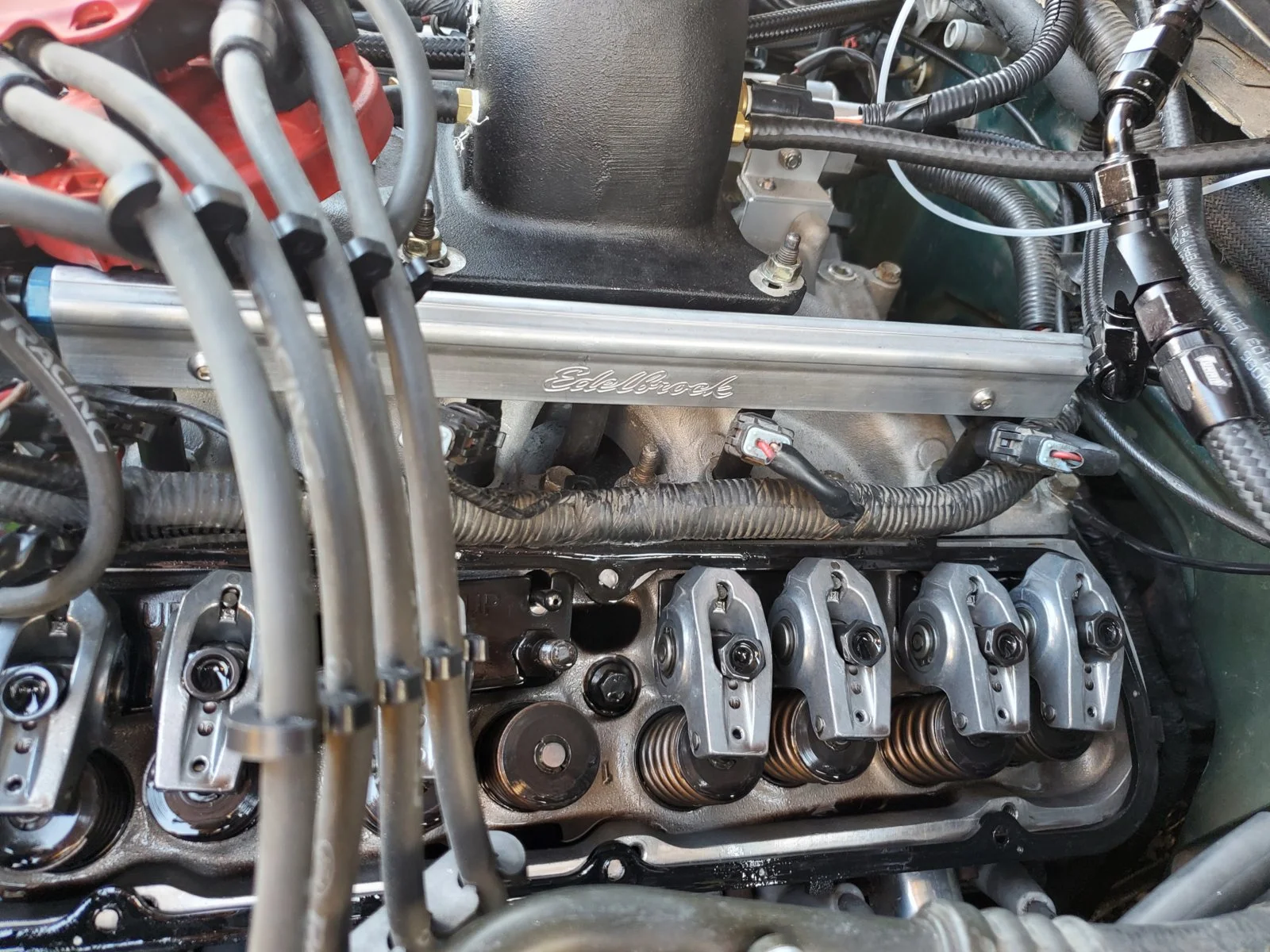

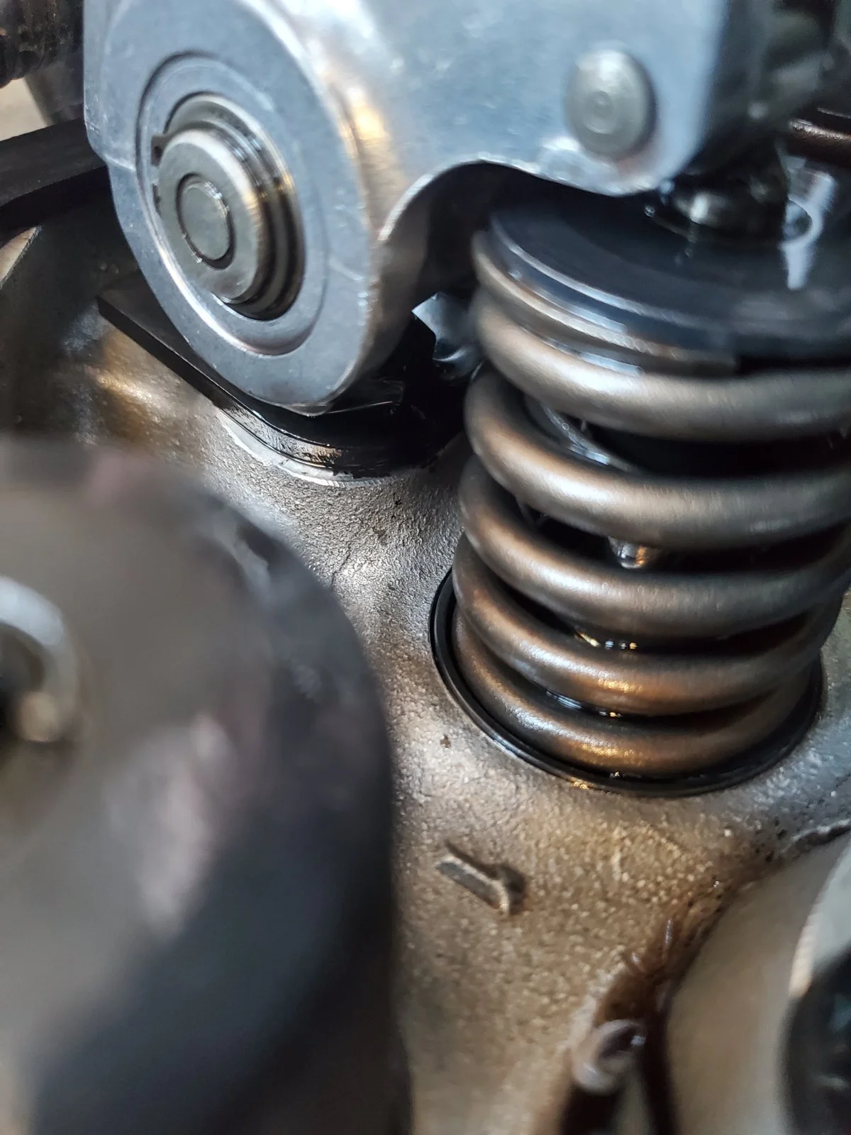

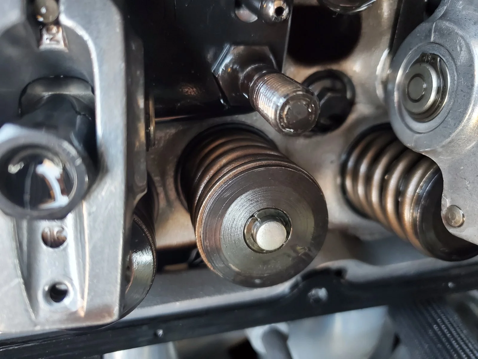

One thing you can do is pull a rocker and look at the weat pattern on the stem. If it looks like a star pattern and looking beat up it’s float. If it’s a nice and uniform sweep then you’re good.
How much boost is the engine actually making? Usually the float issue doesn’t happen under 10lbs unless your springs are barely adequate anyways.
