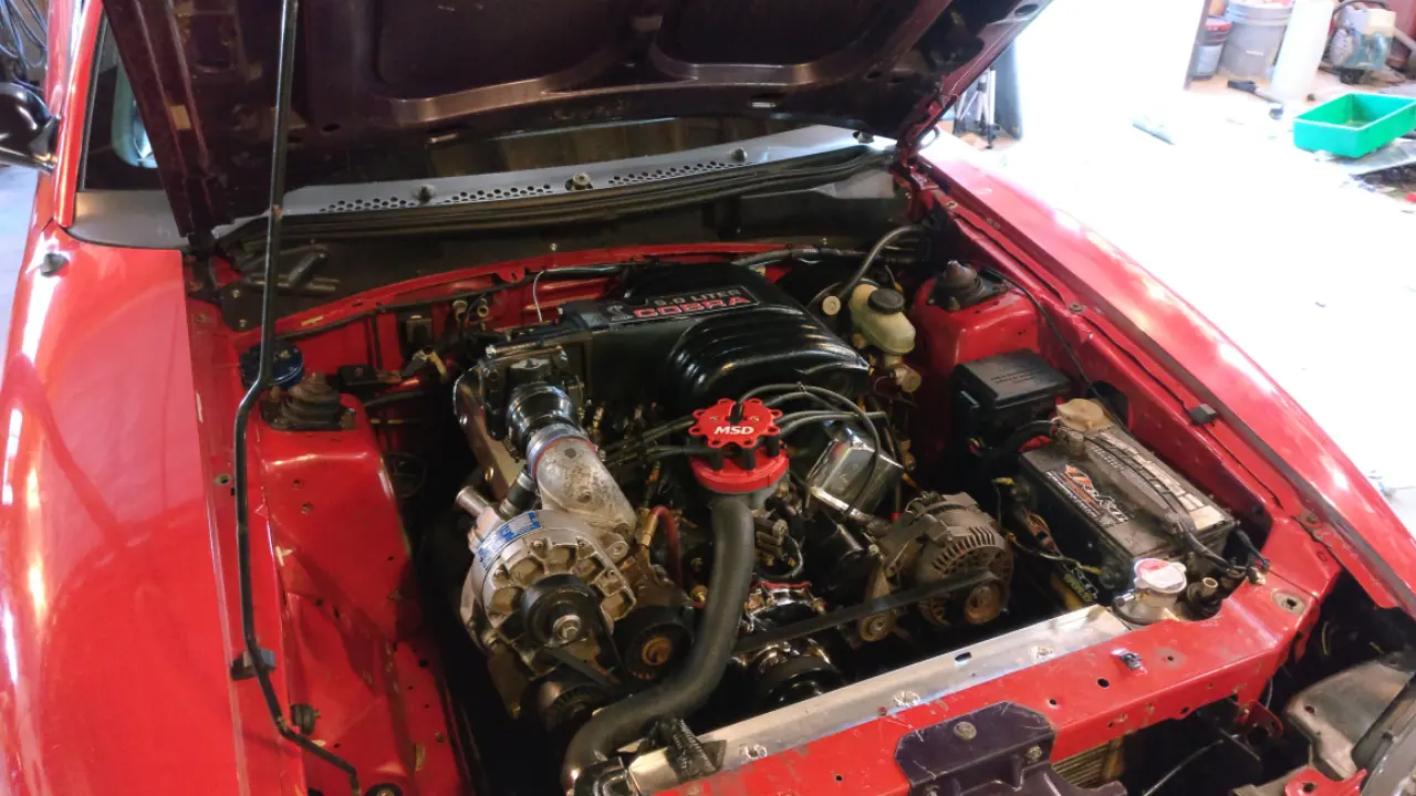

Here's a pic of the intake setup on the car maybe someone knows what year car its off and maybe that is where some of my problems are stemming from. I guess ill try to keep an eye out for a sn95 intake and throttle body and maybe that'll make some difference.
And yes i know that's the wrong intake plaque
When I bought the motor the guy gave me the intake and said the 90° elbow was so it could be used on a sn but I haven't seen any others like it. I fabbed the blower up there when I built all the brackets just because it was the easiest spot for it

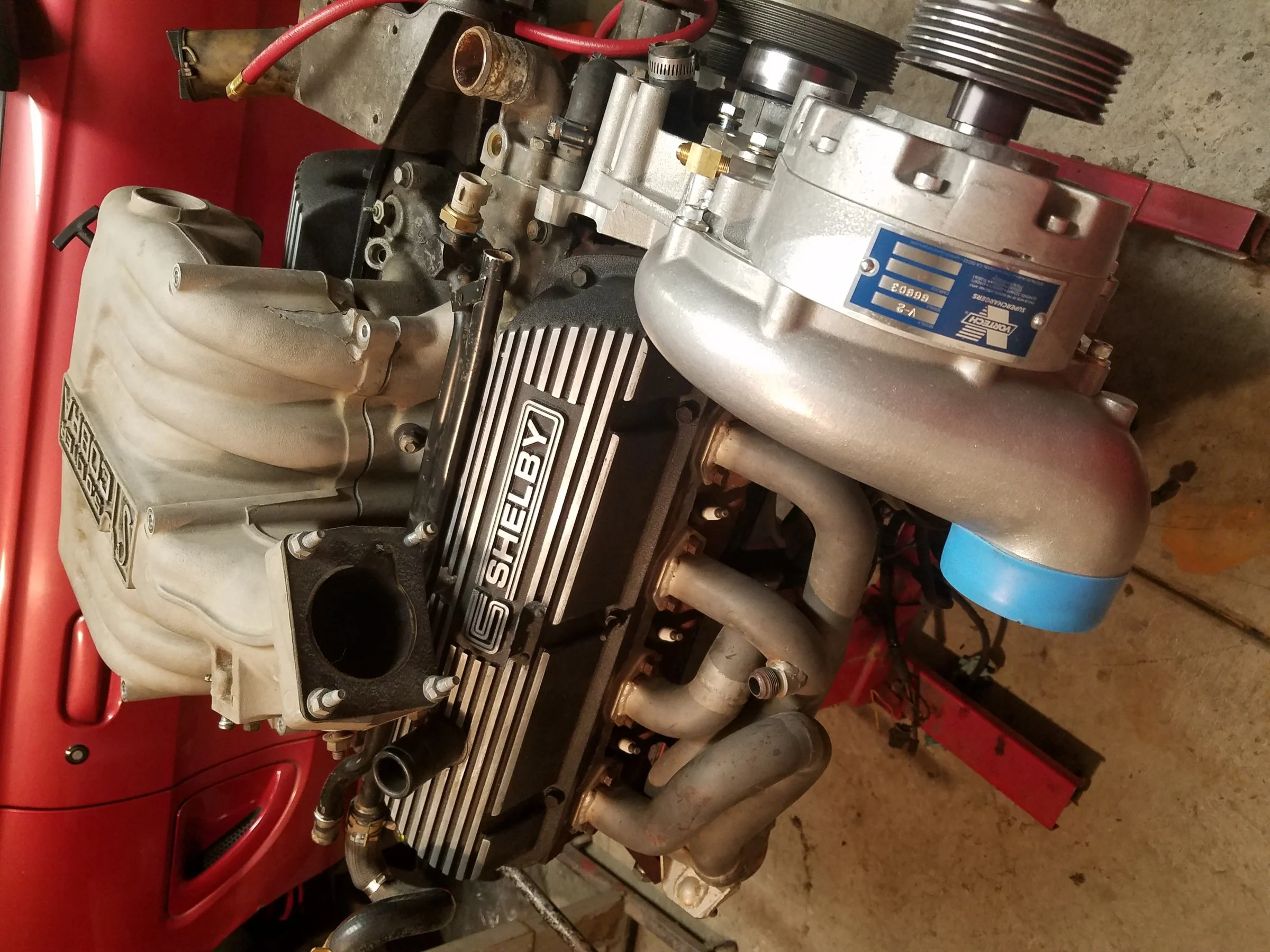

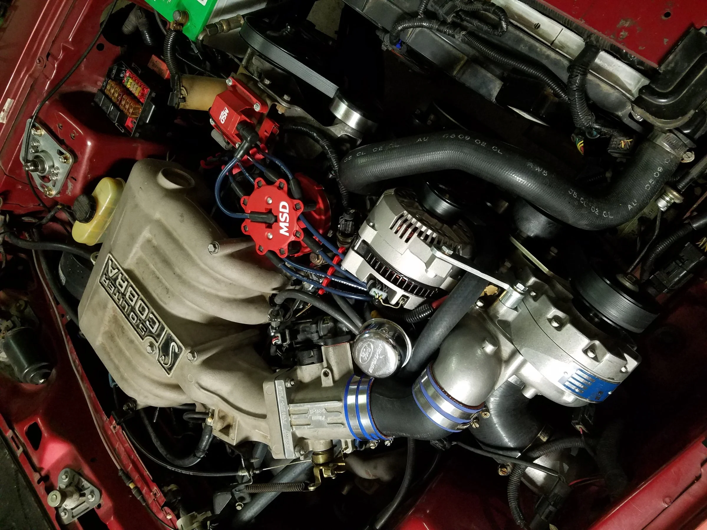

I kinda just went through all this, but the stuff was all sn95.. however.. I had to clock my s trim head unit quite a bit.. You may have to take the head unit off, take out the alan screws, and CAREFULLY rotate the unit so the outlet rotates towards the pass. side.. I don't know where yours is already set, but I had to move mine literally like almost 4 or 5 inches, they slide quite a bit.
Here is a shot of mine for reference.. (minus strut tower brace bc I was painting it lol)
Look how the vortech sat prior to me clocking the head unit
PS those are REAL 1968 ish Shelby covers.. and for sale. My 1.7 rr's were tapping the inside of the baffle (old style, different location) ever so slightly and I didn't wanna mangle real authentic pieces. So they sit in my closet.. Maybe someone could use em?

Maybe I'm misunderstanding you but what would clocking the supercharger do to make a difference with the car not running right with the TPS?
