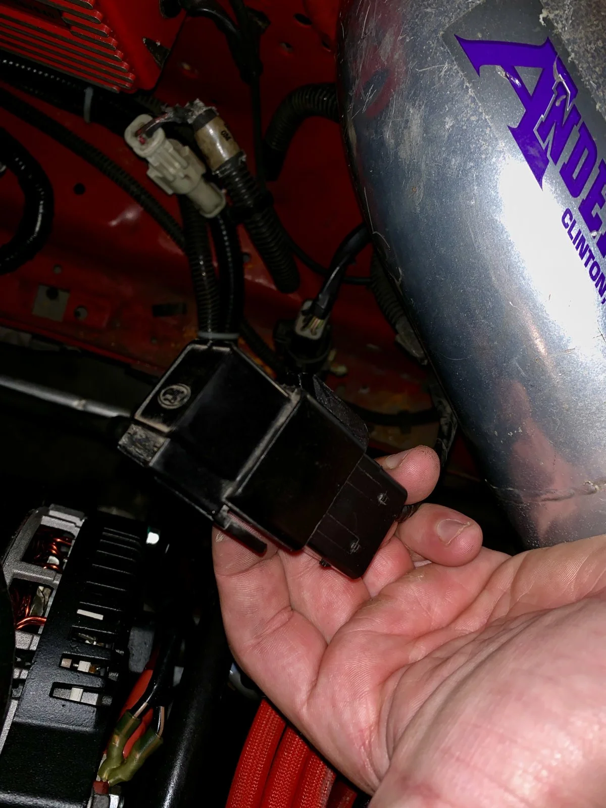

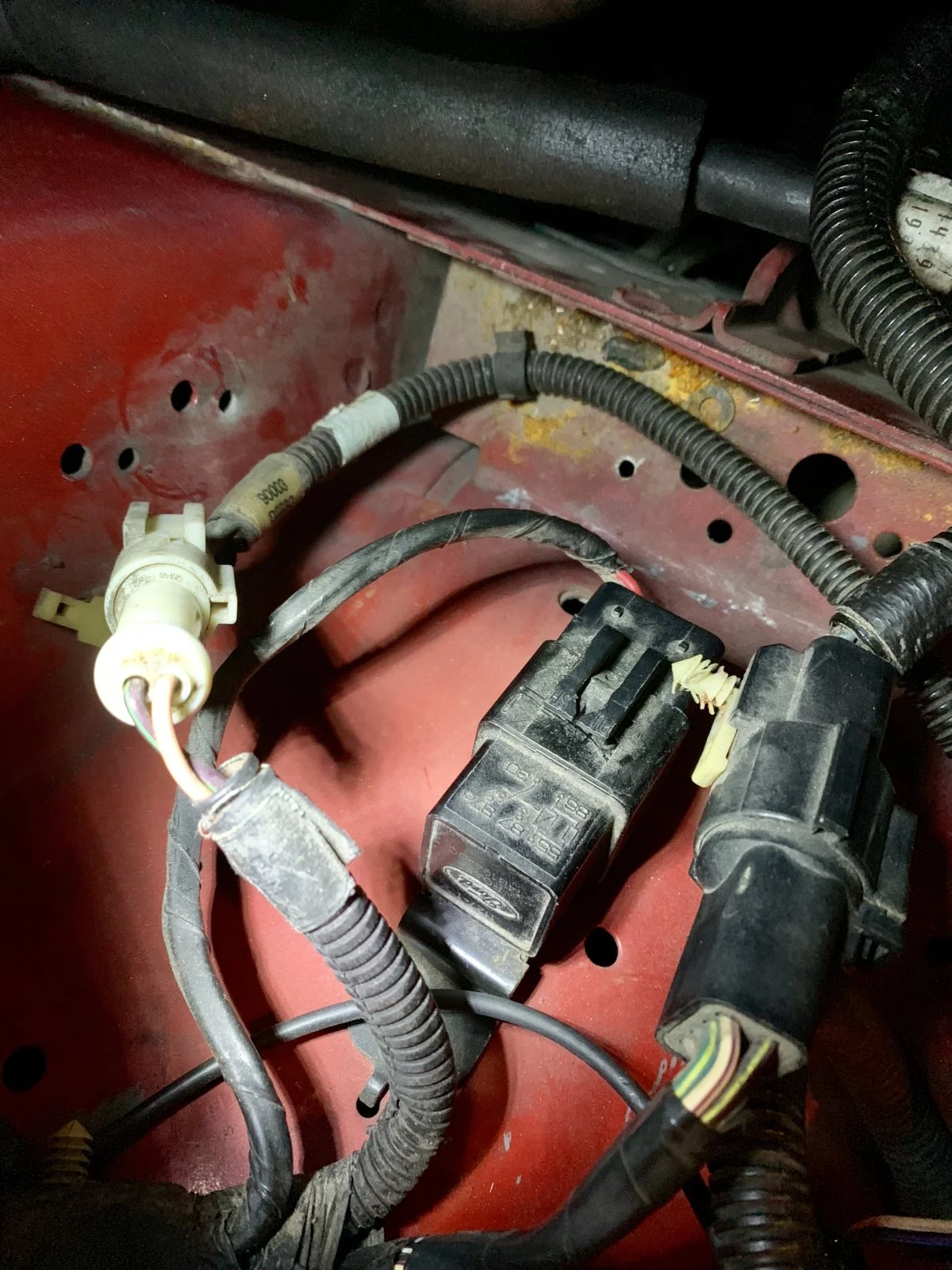

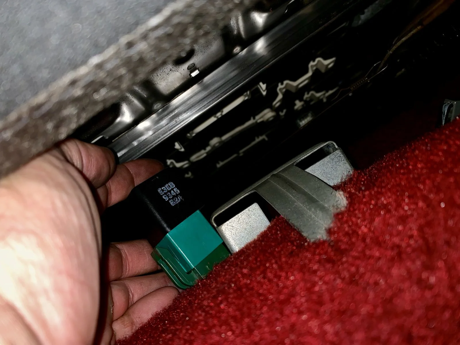

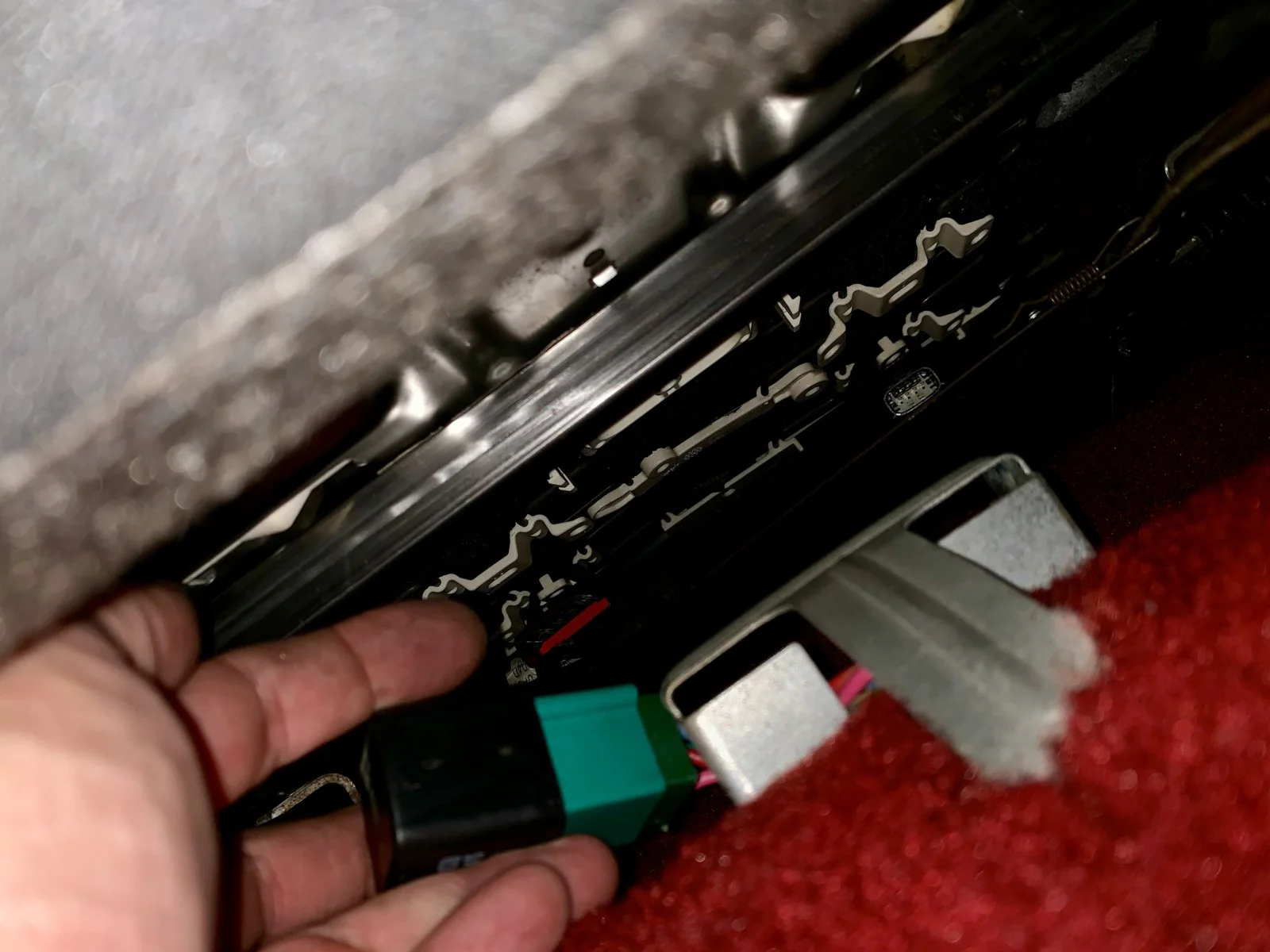

Ok I’m confused, bought the relay but looked where the mass air used to be and saw this black plug relay thing. I also checked some videos on YouTube and a guy on there with a 91 as well had a video but he was showing his fuel pump relay as under his drivers seat? I looked and I also have this relay under the little metal thing beneath the seat which kind of has the same little slide thing to keep it in place. Is that right? Here are the two pieces I am talking about. Or maybe neither are correct haha
The one on the inner fender is the WOTC... is used to cut power to the ac clutch when you are accelerating.
The fuel pump relay always has a green connector.... and the main feed wires are pink with black stripe in all older fords.
Edit; almost always
Did a few of them make it into 92 models? Mid year would be the start of the 93 production year. I could see how a few might have got the newer harness.
Joe
Yes sir, they used up what they had left then moved on to the harness with both relays by the maf on the harness.
So if it’s the one under my seat then what is that other one in the engine bay? Just so I can know what it is.
Edit; almost always
Like mentioned above the other relay is the wot cutout relay for the ac clutch.
