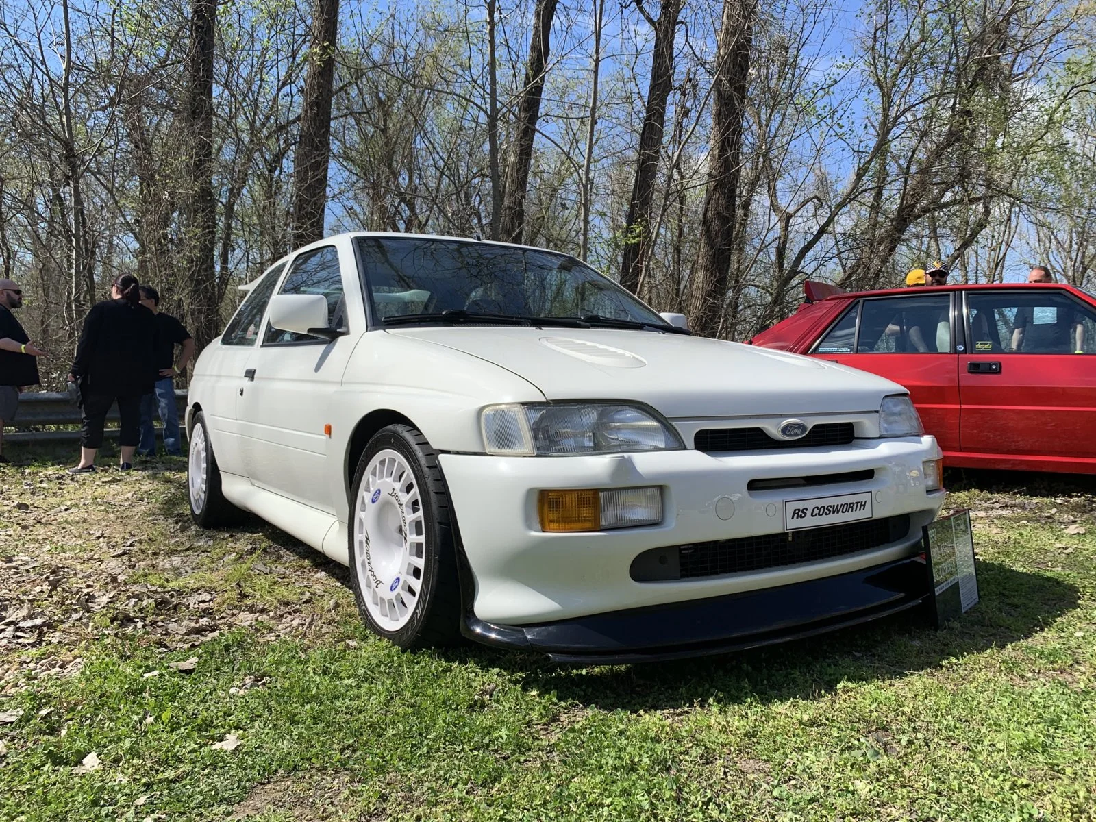

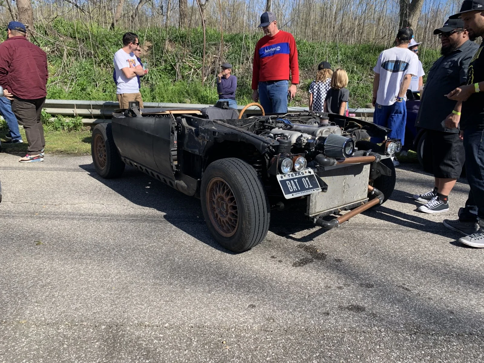

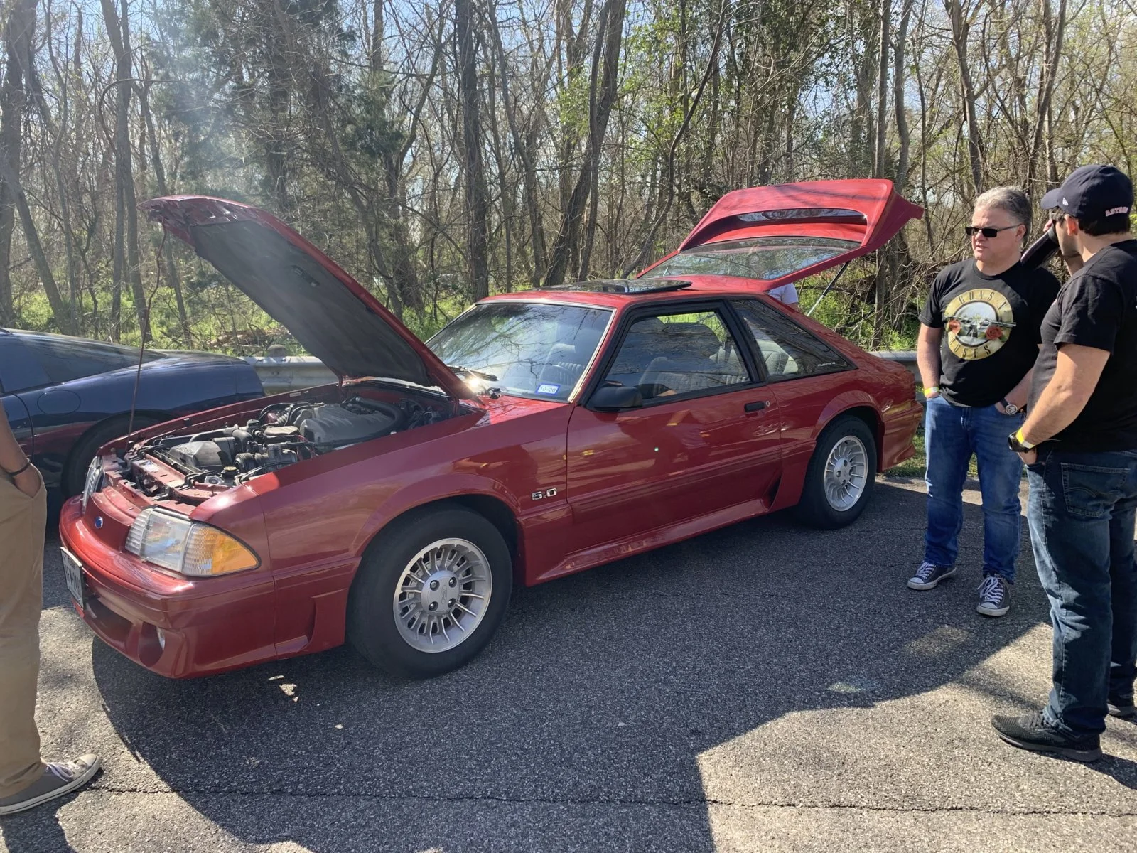

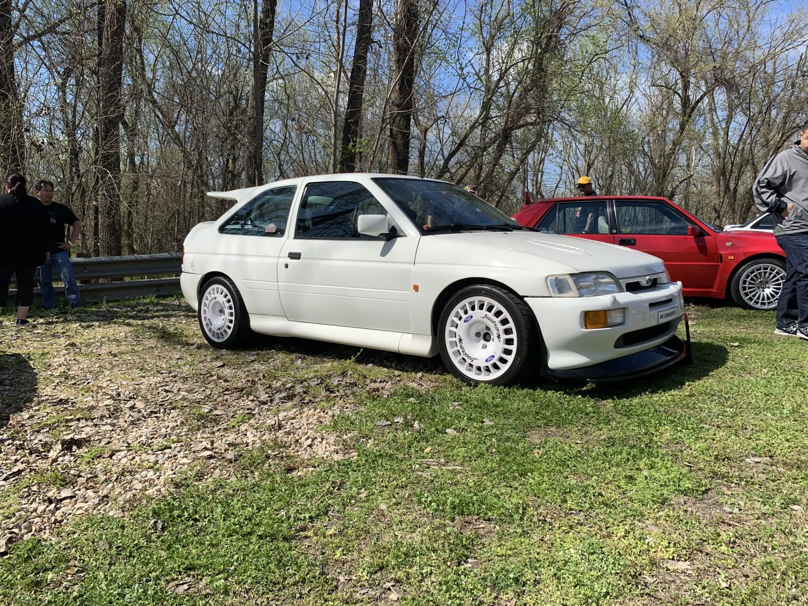

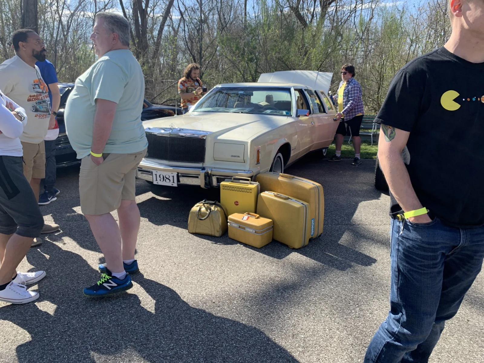

This meet usually has a good fox body turn out. Can’t talk for the other Radwood shows they do but I would think there has to be some that turn out at each show. It’s a really fun show, some cool cars and some that I was like wtf is this bc I’ve never even seen before.

Awesome pics. Thanks for sharing. Sorry about the issues with your car though.

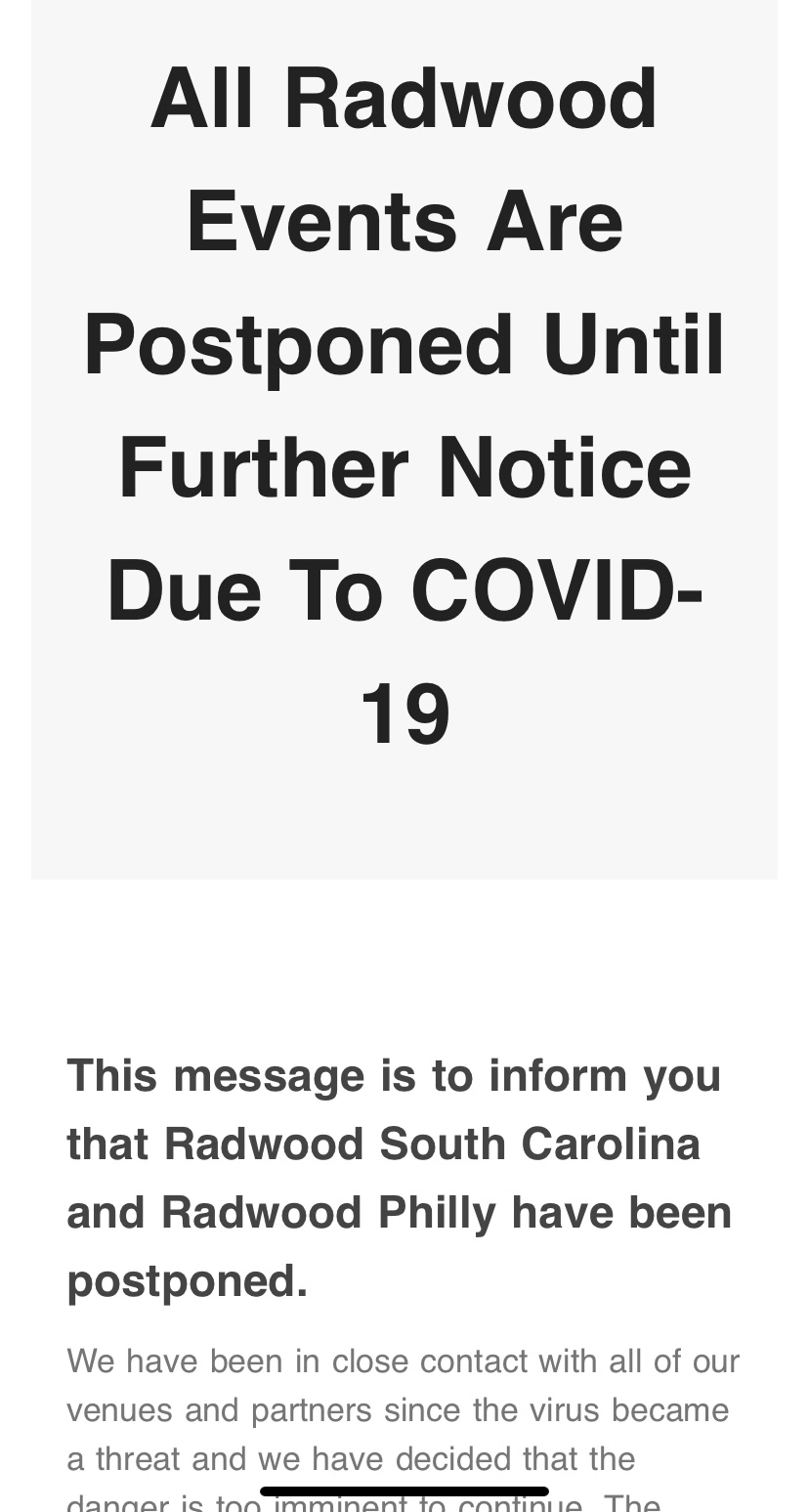

I’m hoping to attend Radwood Philly next month if I can get my horn fixed and pass a safety inspection, lol.
