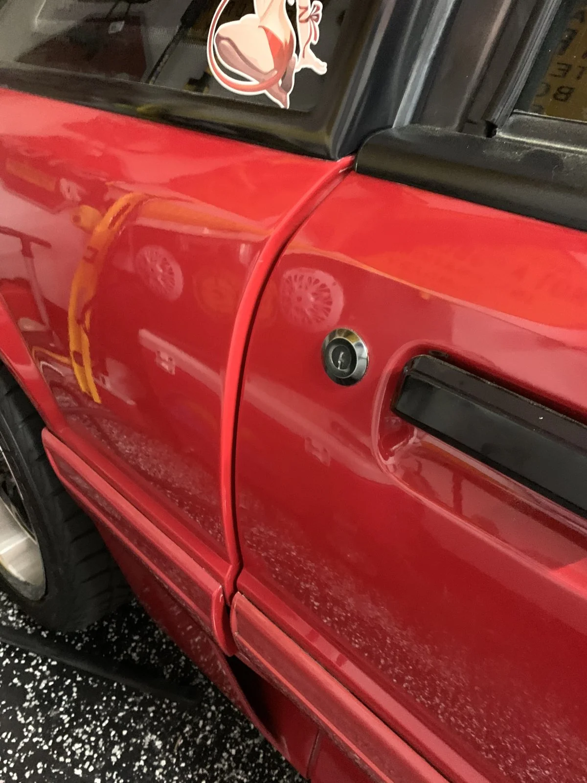

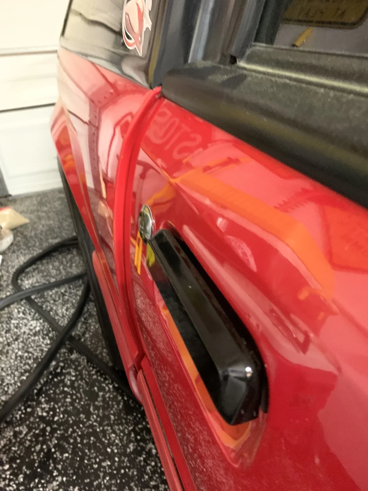

So let me get this straight here, current situation is weather strip is out on passenger side. Both doors had no striker bushings so I installed one on the passenger side, again no weather strip in currently. Replaced striker back to where it was, closed the door and this is where I am. Now at this point the door is latched and way in. Am I suppose to adjust the whole striker bolt further back so when I close the door it’s flush? As it is right now I can not open the door unless I get inside and pull the handle and shove the door open. Now for my drivers door, this one doesn’t stay open which I’m taking is the bushing, so unfortunately as I stated in the other thread I already have the new WS installed, tried adding the striker bushing and well everything was off. Here is what I noticed which is my sweet rendering I added just to make sense of what I’m trying to spit out make sense so the door of open and I push and pull there is no play, if I lift it or up and down there is slight play, being when I lift the door up or moves up just a little. I’ve never had to close the door with the lift procedure though it’s just always closed nicely.
