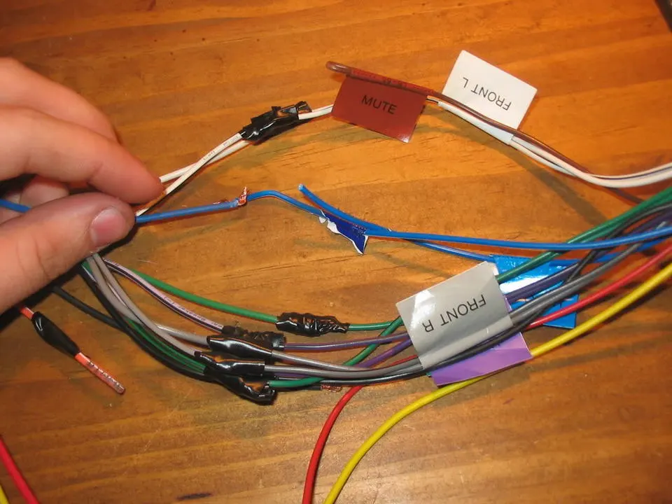

Hey Ryan, The blue wire your hooking up in the picture. What is it going to? Do you have a power ant? If you do not have a power ant or an aftermarket amp You do not need to hook up any remote wires or power ant wires. Just cap em off.

this is the 2nd headunit.....im not spending 20 bucks to have a place test it, im gonna mess with it some tuesday afternoon.
i know for a FACT that the harness from the head unit to the car is hooked up right, ive had 3 people look at it and try it and they got the same thing.

you have something funny going on and i doubt its the twist and tape of the wires. if you do it right you will have no problems, ive done that on tons of systems and have never had an issue with any of them, flavadave can vouch for it. solder is the way to go though.
if you dont have an amp in there, get a multi meter and check for shorts. the only thing i can think of that would cause a pop, then nothing would be a short/ground issue.
