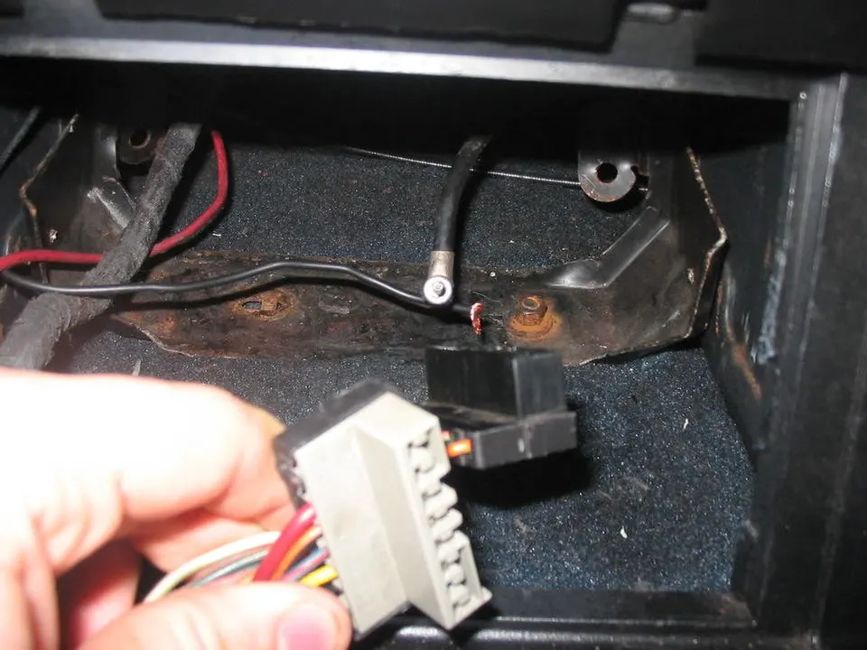

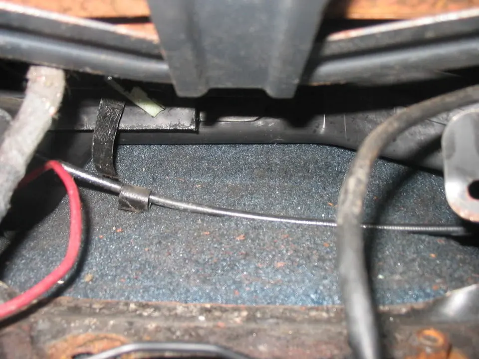

i have the radio out, i see no AMP there what so ever! its not on the floor pan behide the radio just empty spave there, there is a metal bracket there and nonthing else!
If the amp's out, then you still gotta hunt for that connector that the amp used to plug into, then. If there ever was an amp there on your car, you'll find that connector back there somewhere. You'll probably have to dig around for it. Who knows, it might've gotten tucked away when you had the dash out to do the heater core...? :shrug:

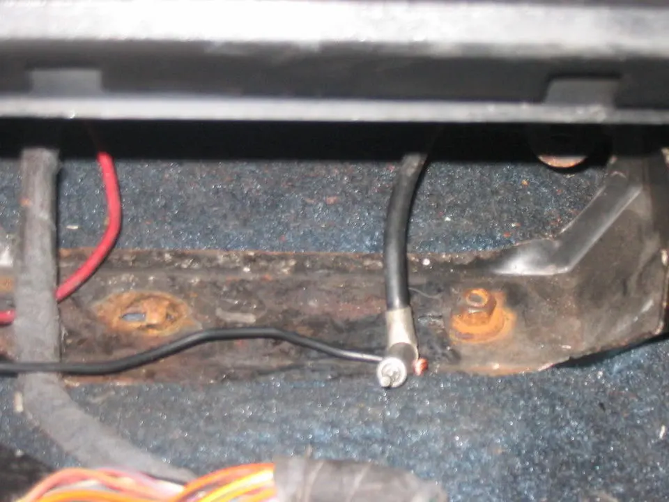

heres a pic...i dont see any amp?
black wire and red wire you see are the ground wires i have running to the dash frame.

The fact that you still have the bracket sitting in there means that there WAS an amp in there, so you do, in fact, have the premium sound package that I keep yammering on about. I guarantee you, if you dig around under the dash and keep looking, you WILL find an extra connector hanging around there looking all lonely-like and begging for a mate. Buy the correct wiring harness adapter so you'll have a reference for what kind of a connector you'll be needing, and keep hunting.
Only other possibility I can think of is if someone monkey-rigged the whole friggin' car and just clipped the whole damned connector off at the end for some reason, or Frankenstein'ed the car by piecing multiple interiors together (no offense to Frankenstang, of course ;) ), but otherwise, there SHOULD be a connector back there that you need to wire your stuff to, and that will do the trick.
As for why the stock Ford radio works and the aftermarket one doesn't ... I dunno. But again, I had the exact same problem in my '89 notch, and buying/wiring in the premium sound adapter harness was all it took to get sound through the speakers. I think that, even though you have wires going to the speakers from the other harness, you still have an open circuit somehow with the other connector that the stock amp used being disconnected, and so it shorts the setup out (hence the "pop" you get) when you turn it on.
EDIT: Why are you running a separate wire for the power and ground? Dude, the stock wiring harness has your power, ground, and constant battery right on there. You ARE using a wiring harness adapter ... aren't you?

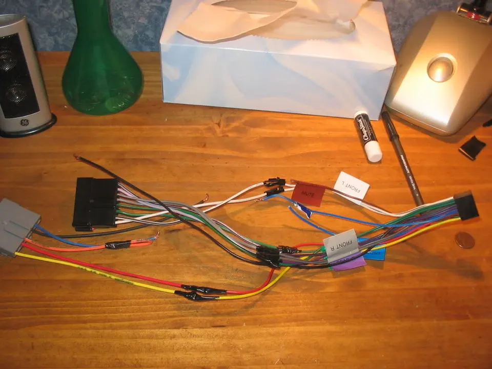

ya i am! i orderd the harness for preimum sound it only came with 2 connecters the big black one nad big grey one!!!!!!!!!!
i cant get it to work through the factory wiring so why not run a new power wire, new ground, and new speaker wires! this why i bypass all the stock factory **** and save my self a whole lot of trouble, when i had the dash out there was NO lose wires or connectors hanging around anywhere!
i went to best buy today AGAIN and asked to see the harness for the premium sound and non premium sound..he hands me one bag that says 88 mustang harness premium sound/ non premium sound.....there hte same harness, i asked if there WAS ANY other type of amp connecters and he said let me check checked his inventory and then the computer and said NO.
so whatever piece your talking about id sure as hell like to see a picture or something!! because i am totally lost!

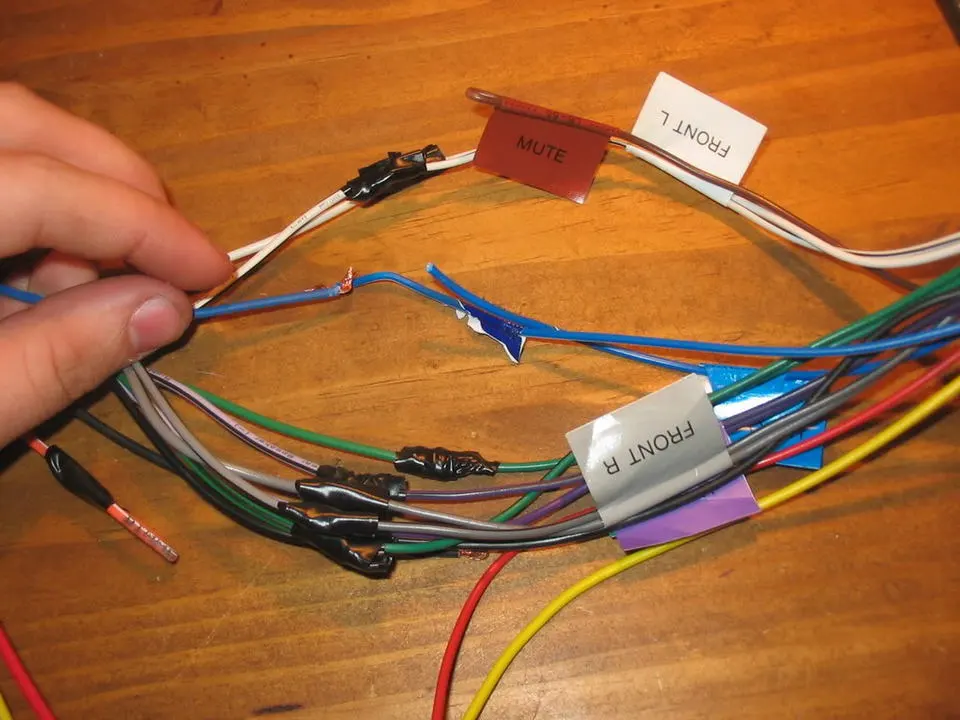

this is all i have in the way of wiring...the one from the new headunit and the 2 from the harness kit!
this is the same harness my dad used to hook his cd player up too!!

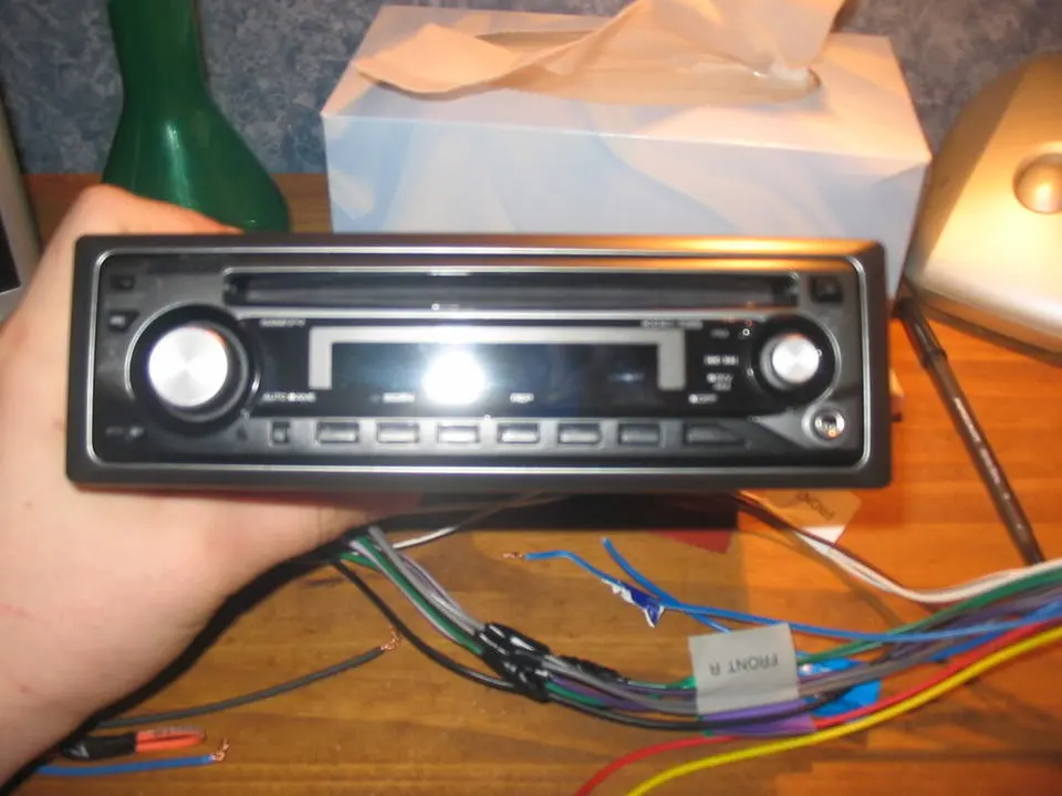

the cd player

Ryan, first let me say I wish you all the luck possible in getting your cd player working. I pulled up crutchfields' site, put in 88 mustang convertible with 6 speakers and got this link, hope it helps you. It shows 3 plug ins for premium sound.
http://www.crutchfield.com/S-2GQ4HqJH8Sg/App/Product/Item/Main.aspx?I=120705006
Click on the Read More part of the item description. It goes into detail. Here is what it says:
Crutchfield custom wiring harnesses are lifesavers! You'll save many steps when installing an aftermarket receiver in your car. Simply splice the color-coded wires on your Crutchfield harness to the wires from your aftermarket radio — and do it in the comfort of your home without having to struggle with splicing wires behind your dash. (Most of the wire splices can be made on your work bench or kitchen table. Soldering is best, crimping is also very popular — see "Accessories").
Next, plug the Crutchfield harness into the harness that you removed from your factory radio.
Read More
Since you didn't have to cut off your car's original radio connector, it's easier to put the factory radio back in when you sell your vehicle or return it at the end of the lease. Just plug the factory radio back in and keep the aftermarket radio! Best of all, the harness is free with most of the receivers Crutchfield offers! 30-day warranty.
Connections:
Note: Two speaker harnesses are included — one is used if you have a factory amplifier, one is used if you don't. If there is no ground wire in the factory harness, you'll need to make a ground connection between your new receiver and your car's metal chassis.
12V constant power
12V switched power
chassis ground
power antenna turn-on
dimmer
left front speaker +/-
right front speaker +/-
left rear speaker +/-
right rear speaker +/-
