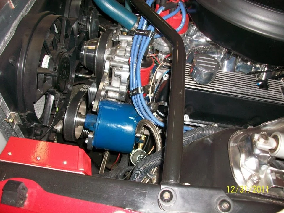

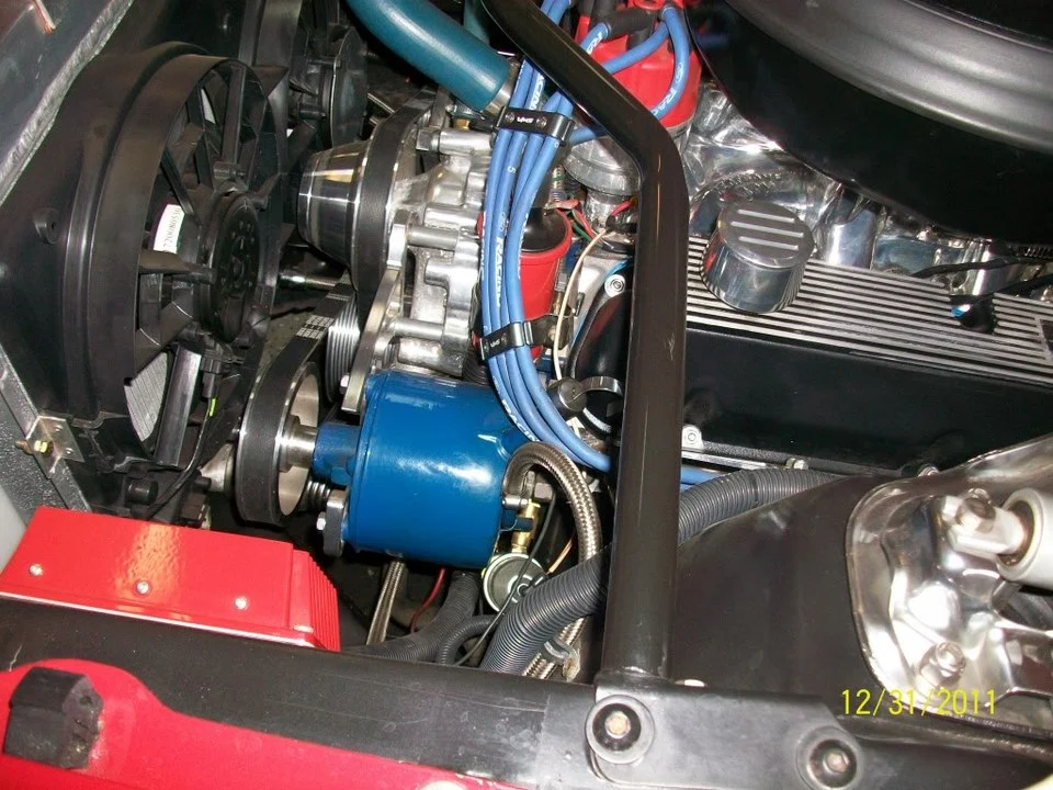

I've got an electric in my 70 - its a mercury mystique that fits the radiator nice. Had to fab up a couple mouting points with aluminun metal strips. But no big deal.
