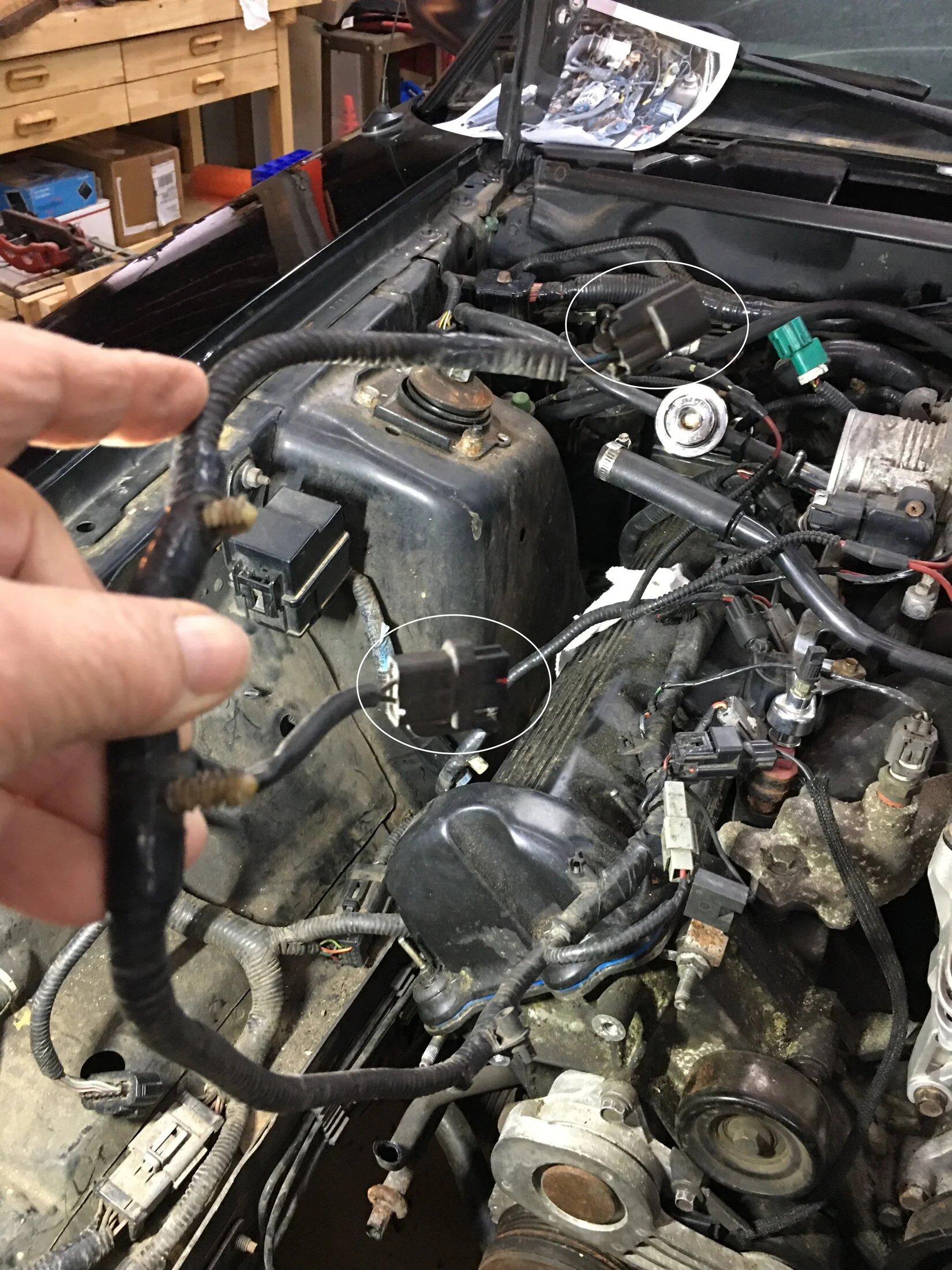

I'm holding one part of the harness with 2 connectors and no apparent place to connect. In some engine pictures I've seen this end wrapped around the front of the valve cover and running back above the exhaust manifold. I don't have anything in that area to connect to. Hard to see but there is a connector along the harness between the first two plugs that has an extension cable plugged into it. The extension goes nowhere and has a different connector at the other end.

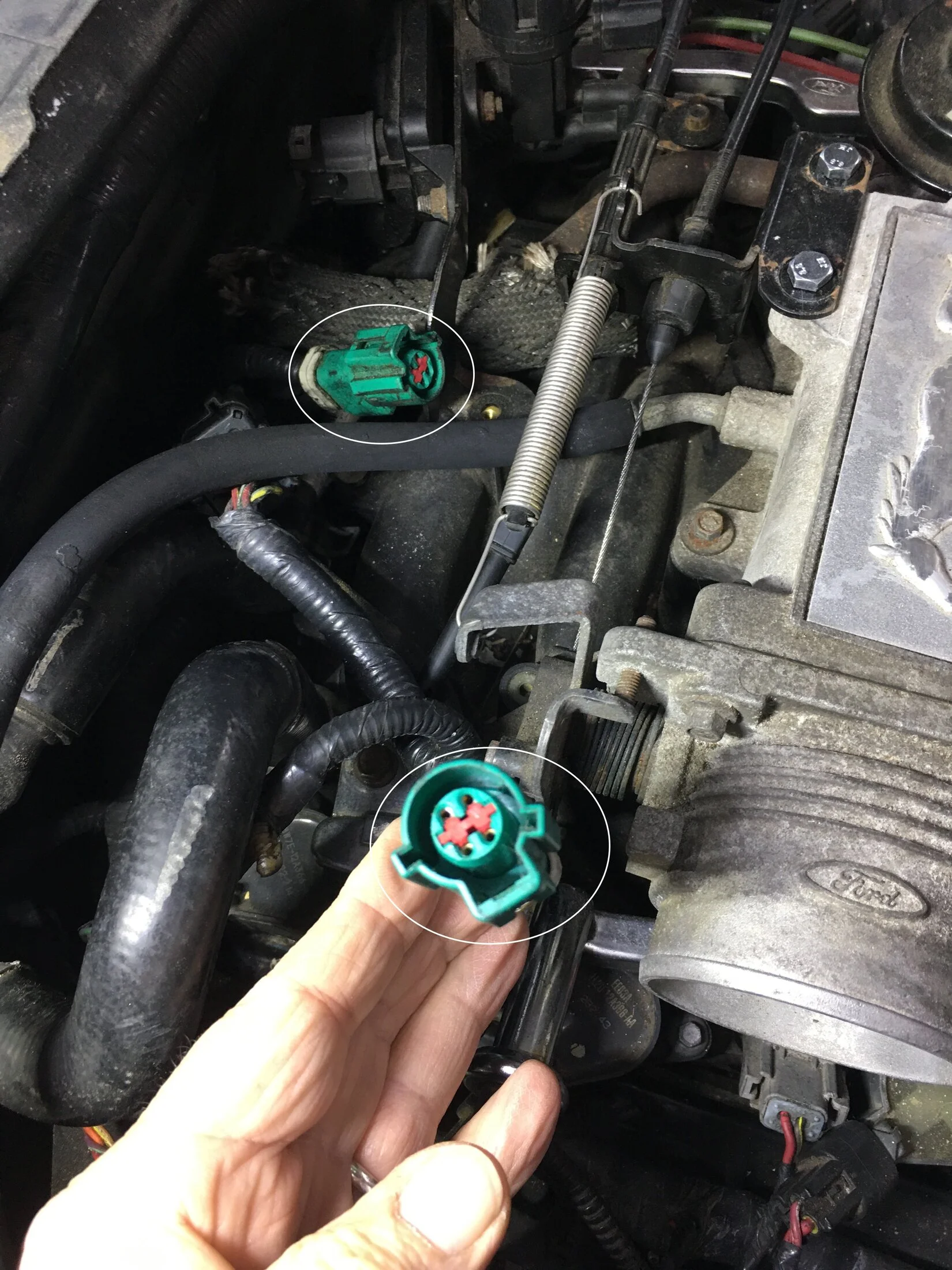

The other picture shows 2 greenish plugs that are near each other along the top of the firewall. They're both the same gender and nothing to plug them into. I wonder if they're meant to plug together.

Figured it out. O2 sensors point to the sky because the harness is flipped at the firewall. Part of the harness should be 6-8 inches lower and run across the top of the bellhousing attached to a harness retainer.
Have to disconnect everything at the back of engine (hoses etc) and untwist it. Can't snake it under all the connections
