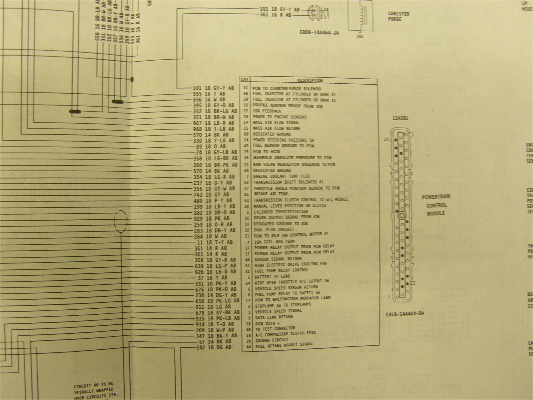

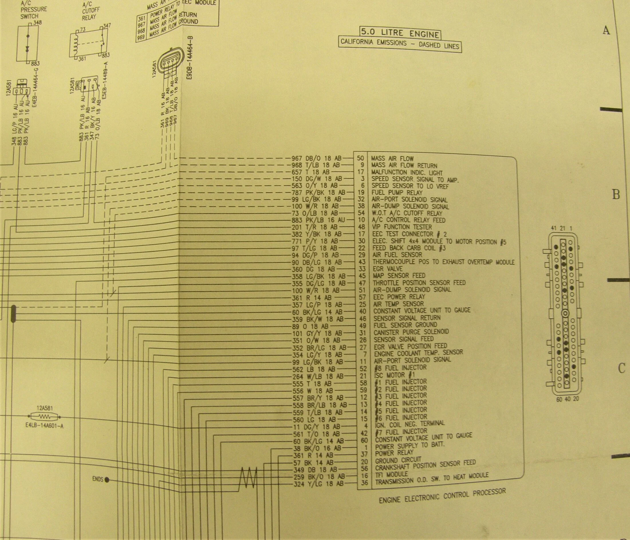

Here's the ECU pinouts for a '93 2.3 4cyl and an '89 5.0 (I don't have an '88 but they should be the same).
