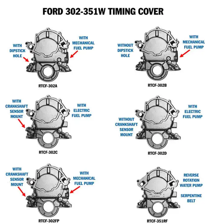

The easiest thing for me to do was buy the matching timing cover instead of looking for doable parts.
Here is a chart of Timing Covers for reference. The stock FI 5.0 cover is the one on the bottom right (reverse rotation, electric fuel pump). Notice the D's. If you dont have the backing plate with just holes in it for the water ports (for standard rotation WP) , you will have water leaks. (mob, Great write up on your link BTW)

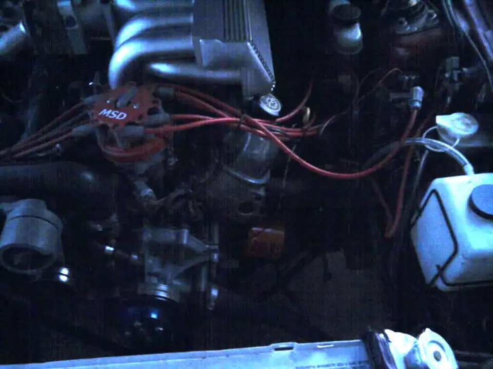

I guess instead of a cw water pump, i should just put a delete pulley in there so the belt makes better contact with the pump. here are some pics of how it looks now

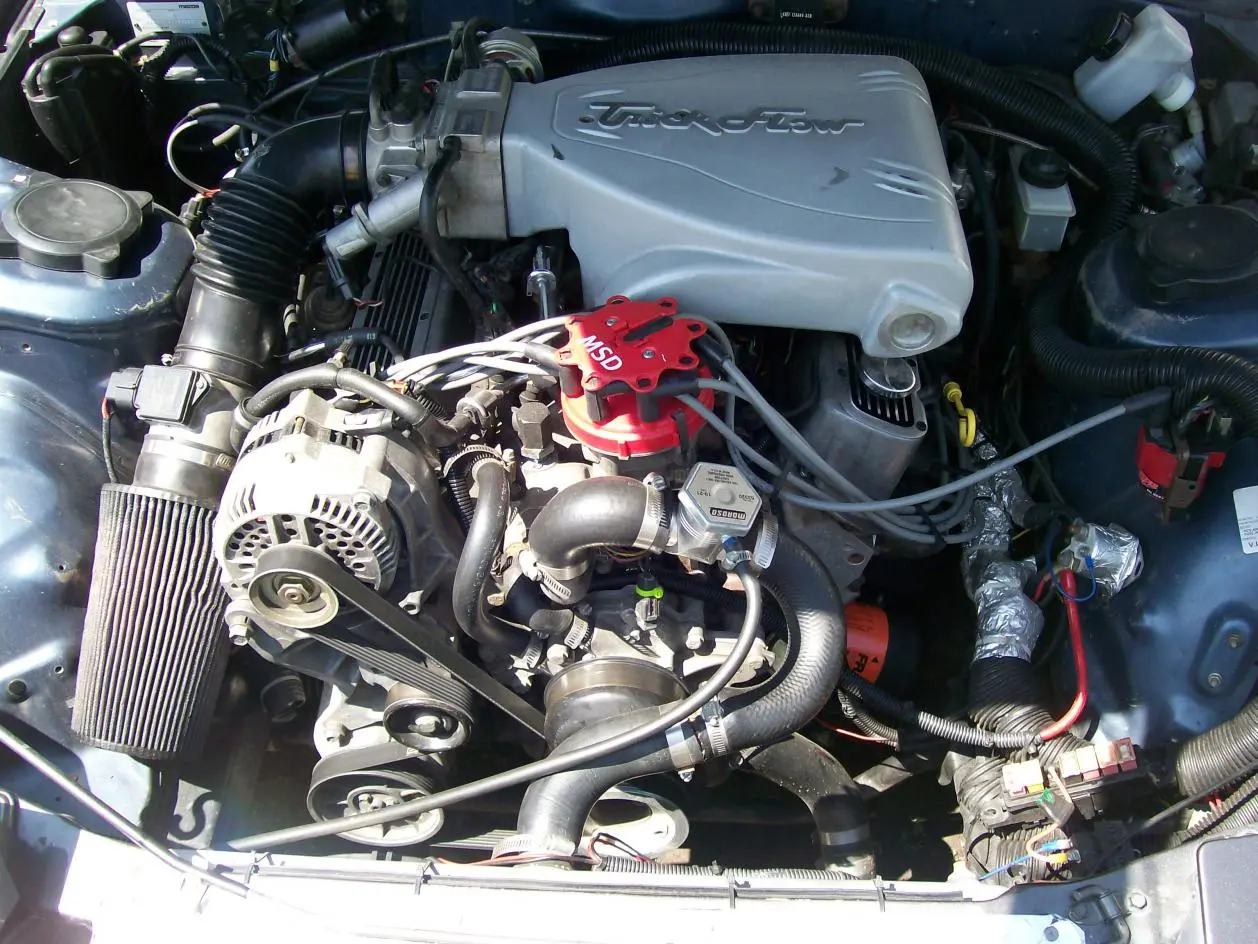

ok, I have never seen the tensioner down in that position before, I have read about some ppl changing and moving it around. That is not alot of contact for the WP. If the tensioner is back in the stock location (pushing down on the belt just to the right of the alternator). You can kinda see the way mine was in these photos.
I know this is a bad pic, but you can kinda see my routing.
