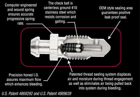

Also, speed bleeders make the job much easier :nice: they are $5 per caliper.
The Speedbleeder part numbers are as follows...
94-98 Mustang front---------------SB3824
99-04 Mustang V6/GT front-------SB1010
94-04 Cobra/Bullitt/Mach1 front--SB1010S
94-04 all Mustang rear------------SB1010S
Dimensions --- thread size / overall length, in.(mm):
SB3824----------3/8 x 24------1.29 (39.89)
SB1010----------M10 x 1.0-----1.35 (34.44)
SB1010S--------M10 x 1.0-----1.23 (31.35)
