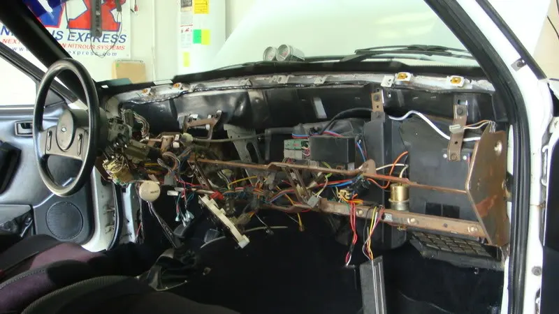

You don't need to touch the wiring. The dash "skin" just peels off the frame. The A/C ducts come with it, but for the wiring you just push it back into the dash and the dash will come out without any of the wiring.
Basically once you remove the "skin" this is what you are left with. The wiring and metal frame stays.

Cool deal, that should be simple enough. I was worried about having to pull wiring and breaking some of the plugs. It's only 26 years old lol.
