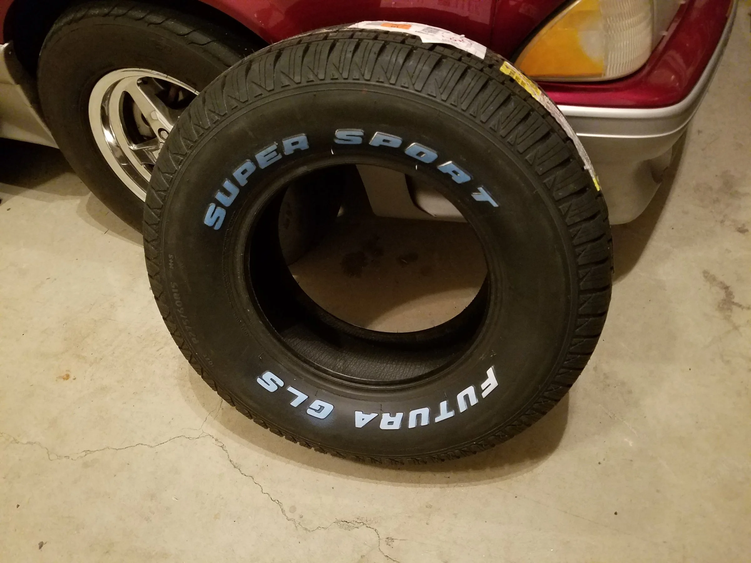

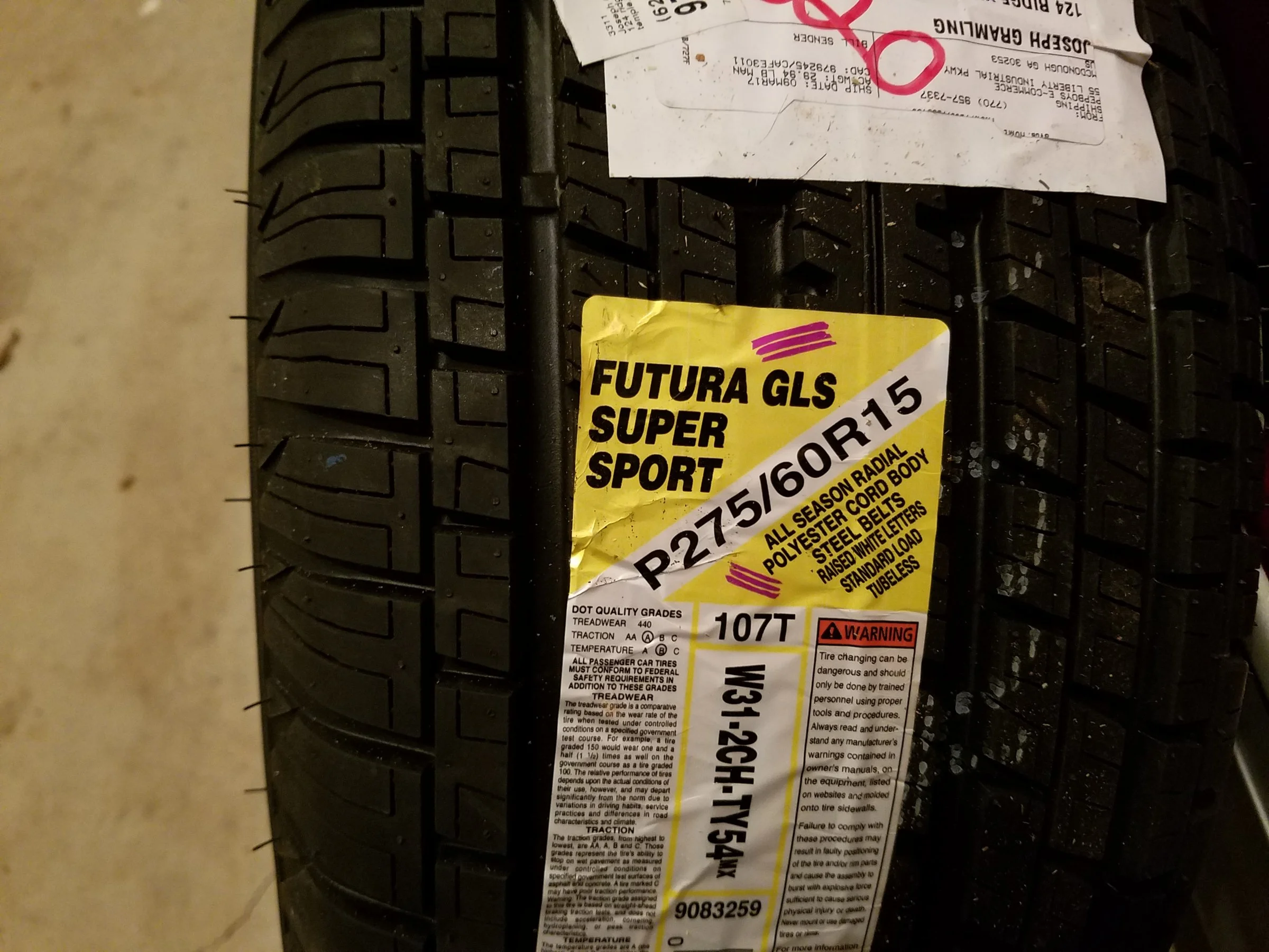

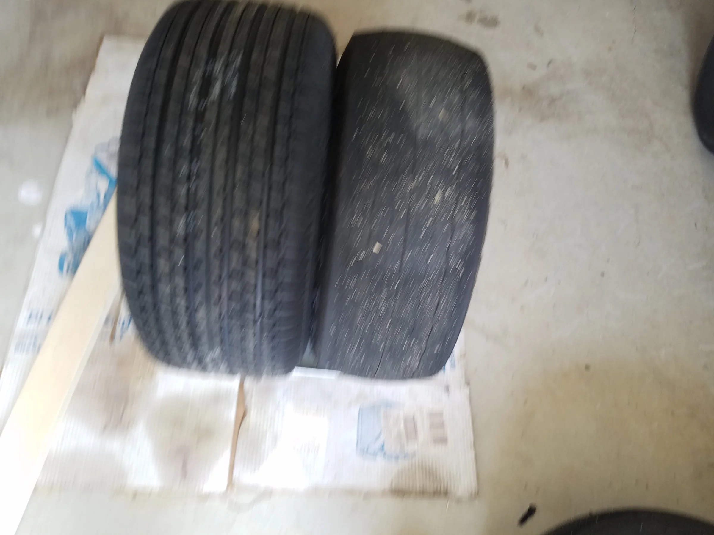

So this year I am changing directions a little. I am going to pull the ET Streets off the car and replace them with these 275/60r15 Futura Sports I got today from Pepboys ($98 each). My plan is to put the NX kit on over the summer, along with a progressive nitrous controller. There are a few hard tire events at tracks near here and I am going to work towards competing in these events. With the tires being the weak link, coupled with the progressive controller, I am hoping that my trans will take less of a beating.
Here are the tires that came today. They are a 440 tread wear rating and are 28" tall as opposed to my 26x10.5 ET. Streets. I am hoping that the added height will aid in the traction department. I still need a progressive controller and a few small nitrous parts to make it happen. The nitrous probably will not happen until July.

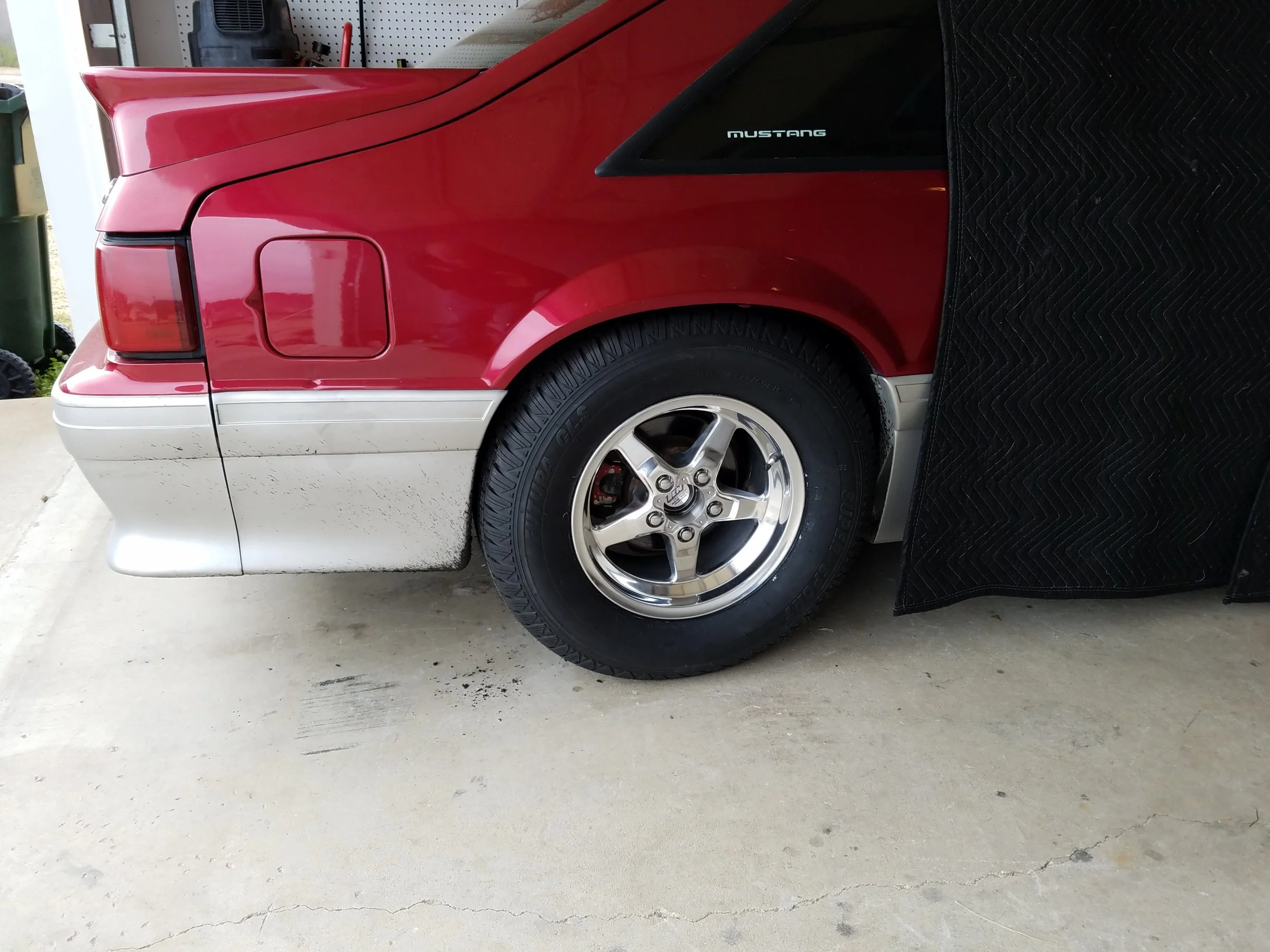

I ended up going with another set of 15x8's with 5.25 bs. Originally I said I was going to go with a 15x10, but I am glad I didn't. Plenty of clearance inside, I did have to remove the quads. I think I am going to have to roll the outer lip. With my 260 lb butt sitting on the hatch, the lip is probably a 1/4" from touching the tire.
I know 275 tires are considered small in the racing world, but they are easily the biggest tire that I have ever had on this car. They really suck up the wheel wells.
Joe
So the driver's side is rubbing. I ordered a fender tool and it will be here this weekend.

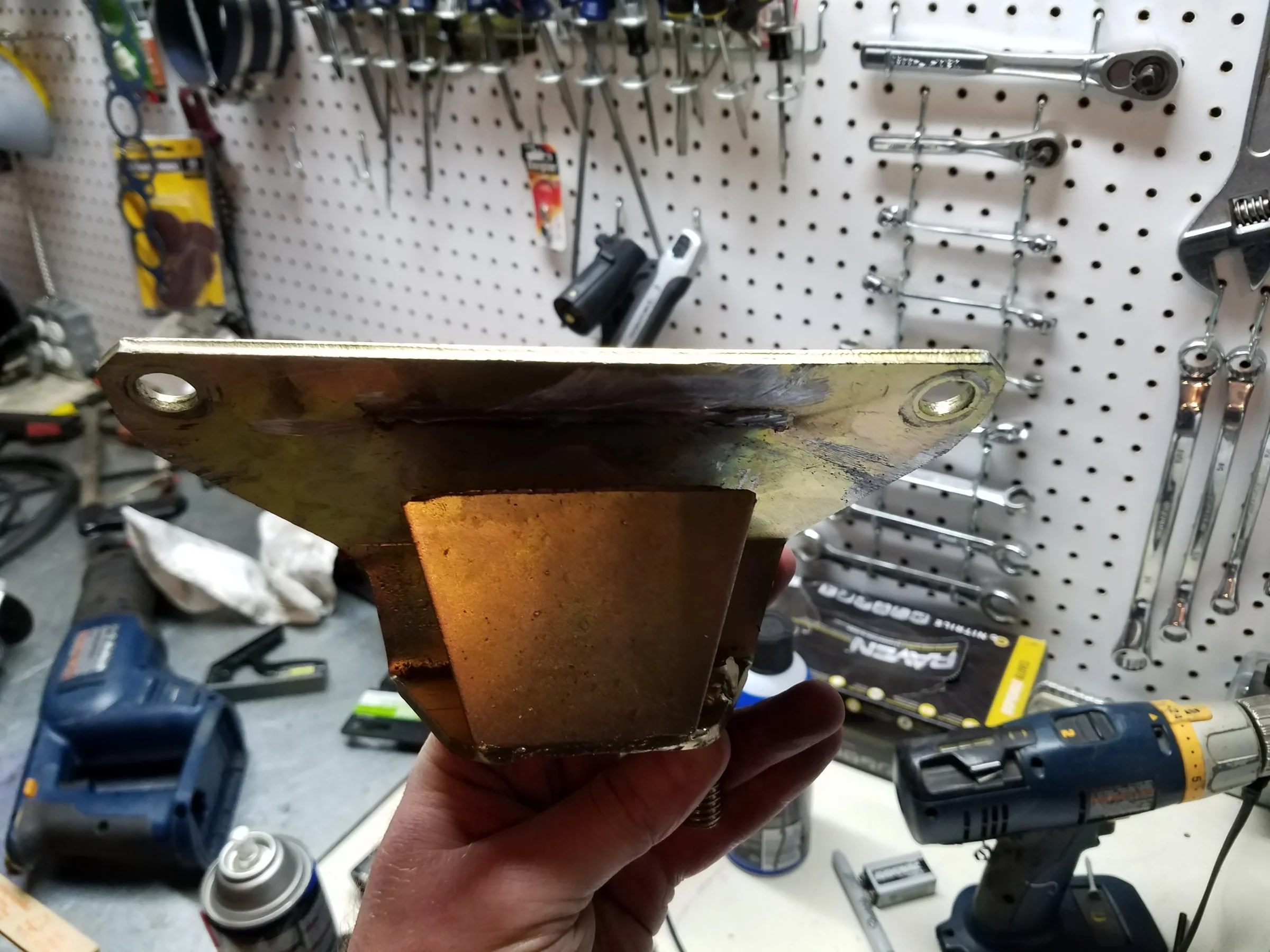

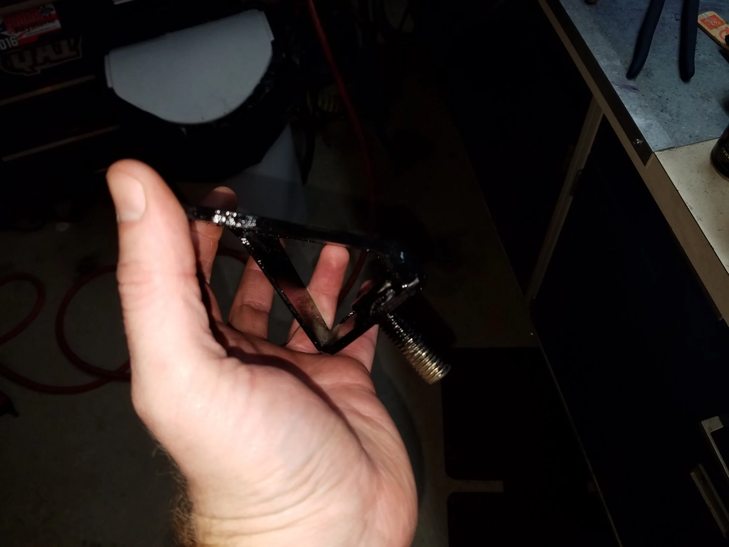

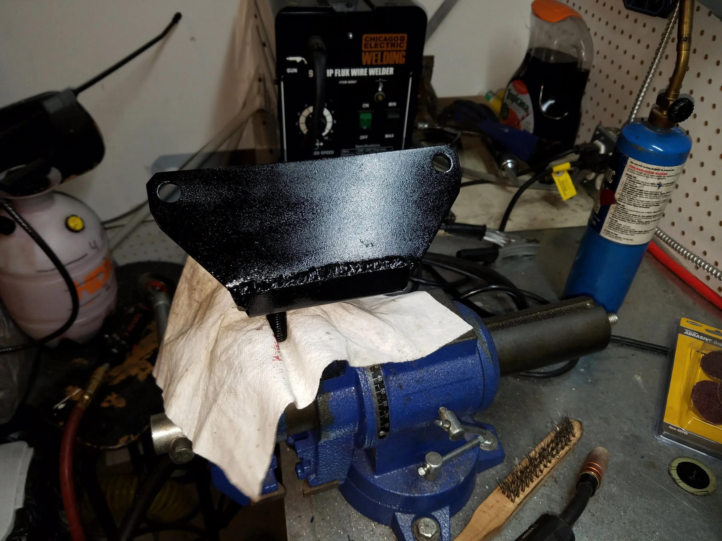

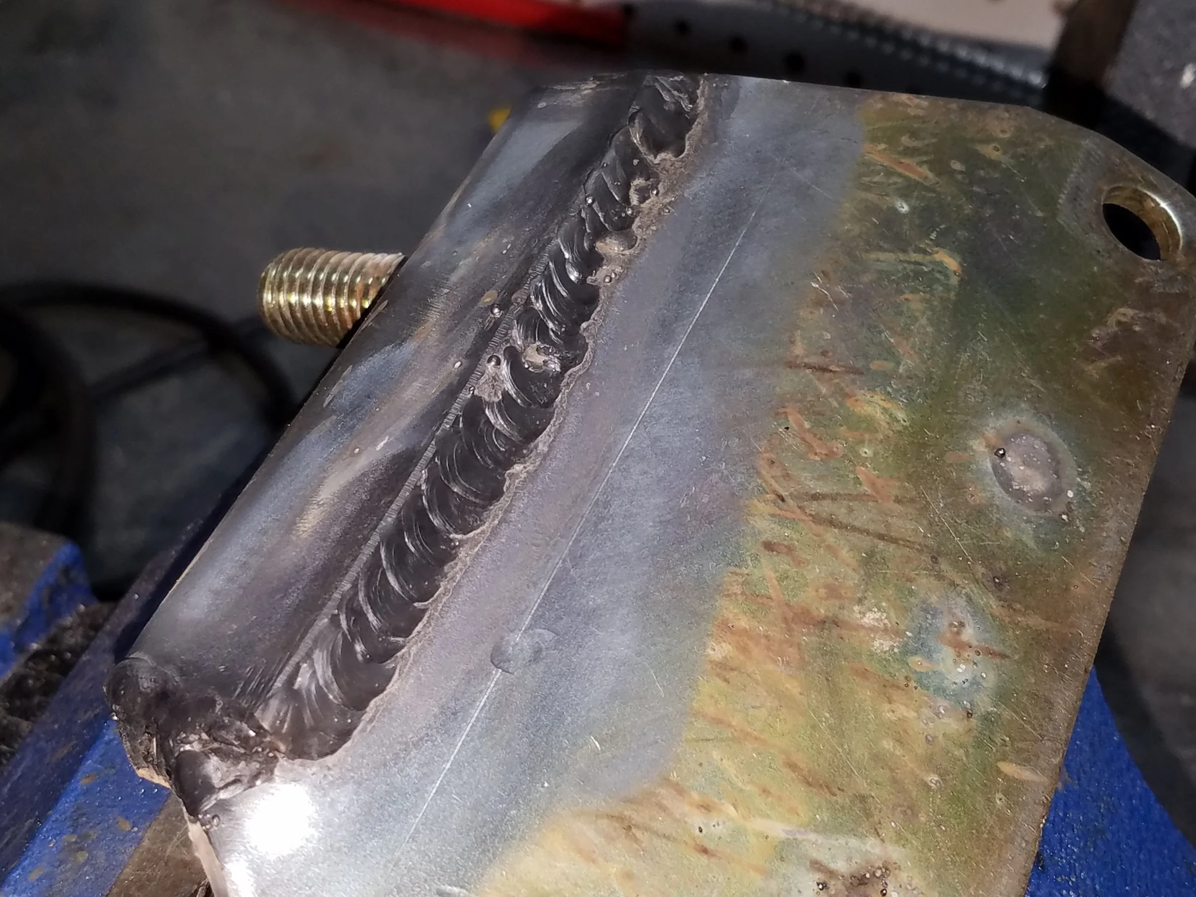

I don' have the funds to order the rest of the nitrous stuff at the moment, and I don't really need it at the moment. However, I had tried test fitting the NX spray bar and the intake wasn't going to clear the hood. I have looked around at drop mounts and all I can find readily available are for a 351 conversion and drop the motor 1.25"...which calls for a host of other changes. So what do I do? I went out on a limb and decided to modify my $35 CJ pony parts solid mounts.
I got one side done, cutting .5" an inch out of it. Don't judge my welding, it was done using a $75 harbor freight Flux welder. It definitely dropped the engine and my steering rack is hitting the headers now. In fact, I think I may be a little over .5" lower. I am going to do the passengers side and see if it tilts it back the other way. If not, I will make some spacers to raise it back up just a bit.
Joe
