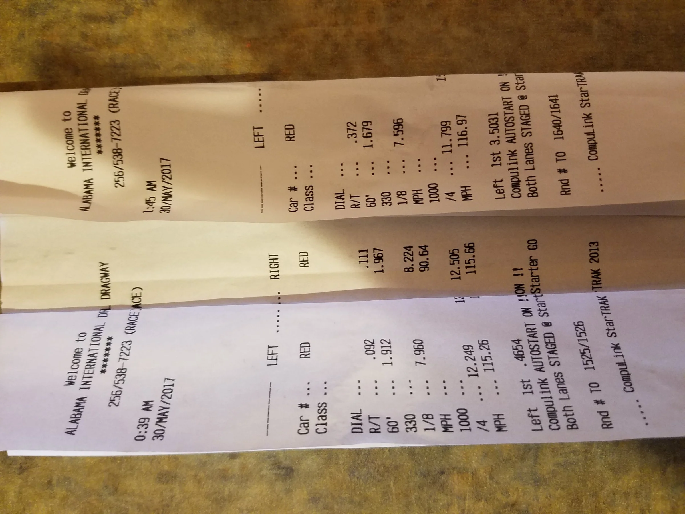

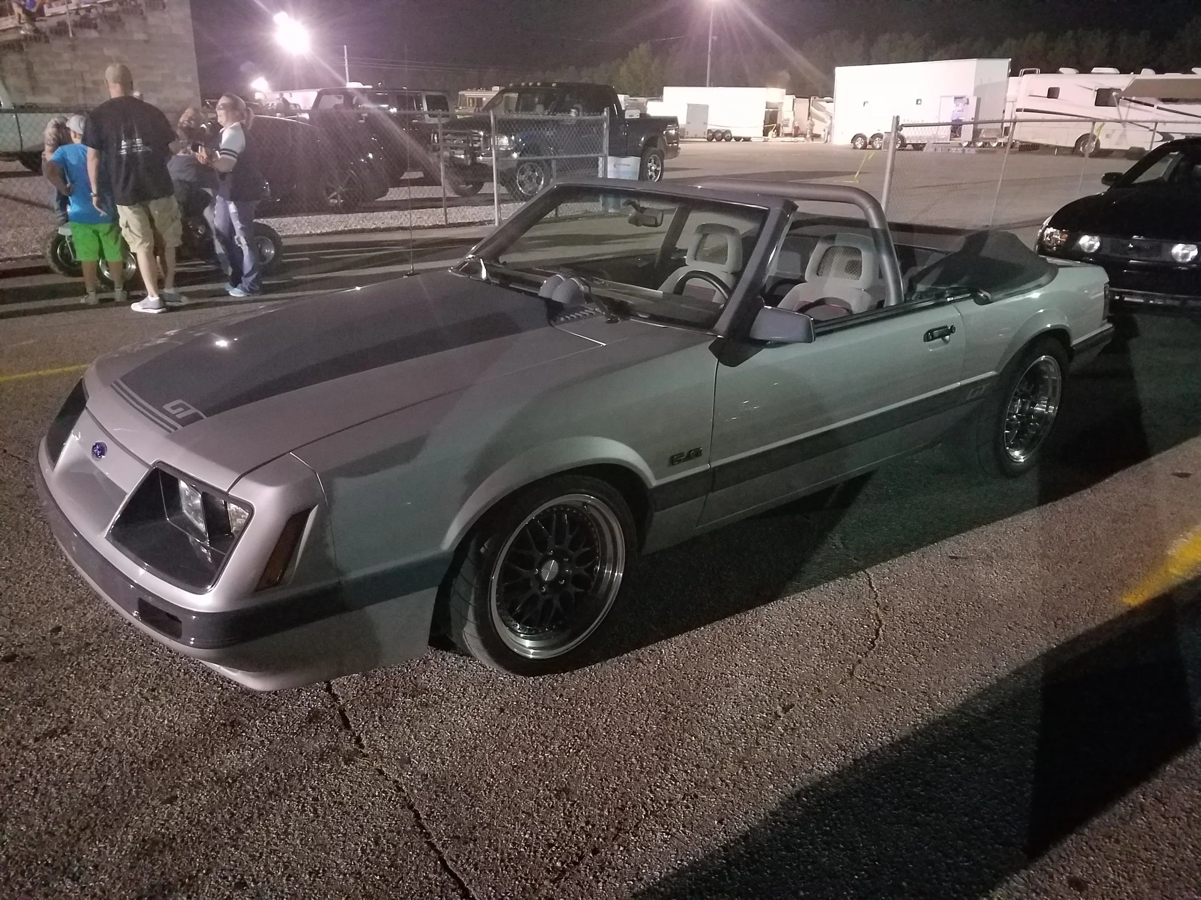

Made it to Steele Alabama last night, to the Alabama International Dragway for some test n tune. Track Wasn't great and the crowd was large. I had ran the car n/a with a few goals in mind that I felt would put me in a contender position with the all season tires.
1) a 1.8x 60ft
2) a 7.9x 1/8 and a 12.2x 1/4
1st pass out I was against a beautiful 85 with a 672 rwhp terminator swap. 1.91 60ft, 7.96 and 12.24. I was extremely excited because this is with no changes other than launch rpm (1600).
2nd pass a wrx red lit on me and I got excited and spun the tires. Went 1.97, 8.22 and 12.55.
3rd and last pass I was happy, so I threw the ET streets back and let it go at my usual launch rpm, 6k. It spun bad, I shifted early and went a 1.67, 7.59 and 11.79, at almost 117mph. A new PB.
I normally cut 1.5x 60fts and have run a best ET in the 1/8 of 7.45 with a 1.57 60ft. I was .1 slower on the 60 and .14 slower in the 1/8. If it had gone a 1.57 like normal, I think I it would have been an 11.6x pass.
Couple of pics attached and will do vids later.

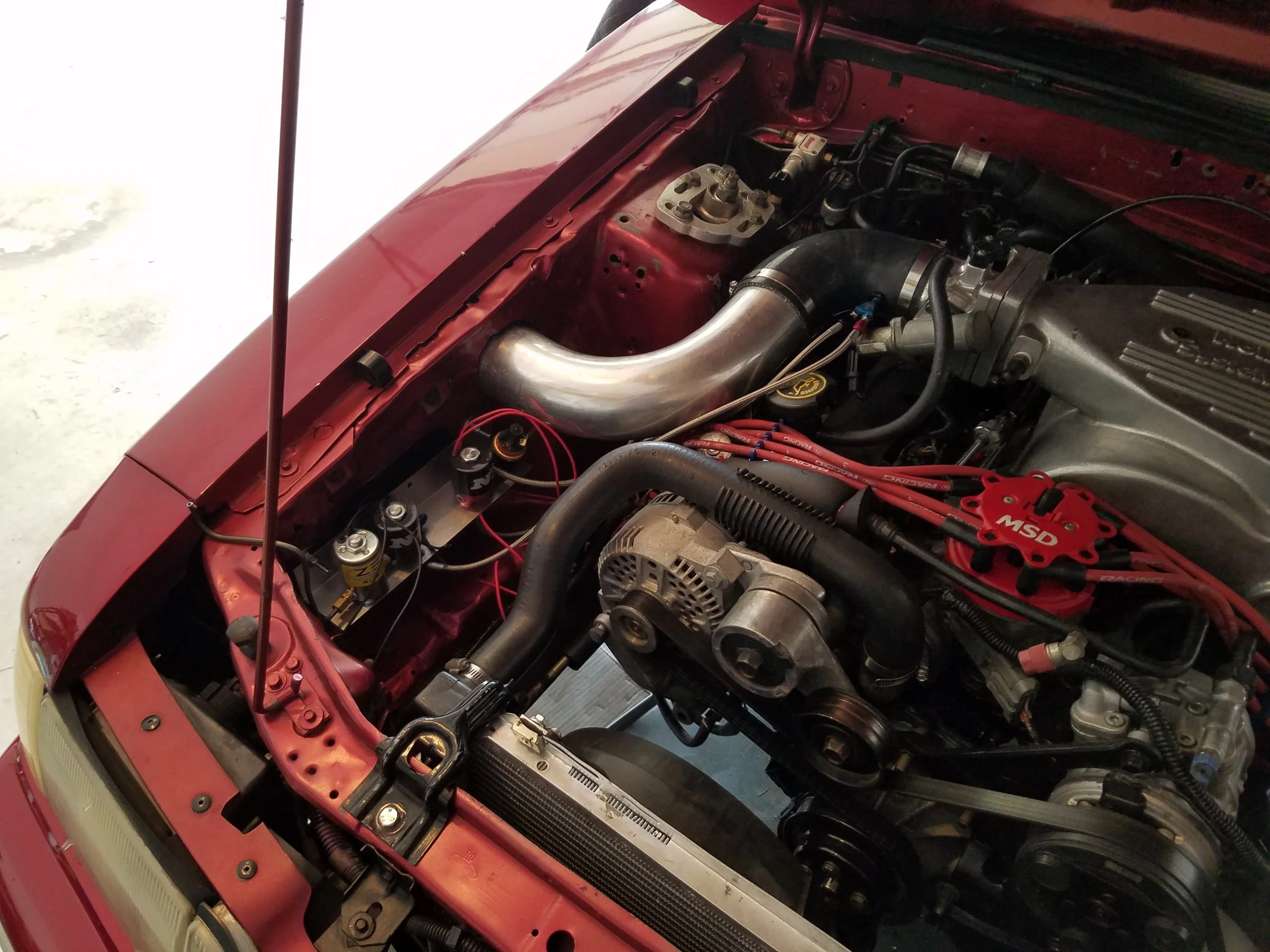

It will be next week before I can continue with my install, but I will continue. I apparently picked the worst time to do a nitrous install, because the while country is in a shortage due to a plant explosion. Atlanta motor speedway is apparently flying it in from out of the country. No one has it around here and said it would probably be the end of the year.
Joe

Ok, so I finally got the bottle filled, at a cost of $75! I am going to the track Friday night but wanted to try it out once to make sure it was working.

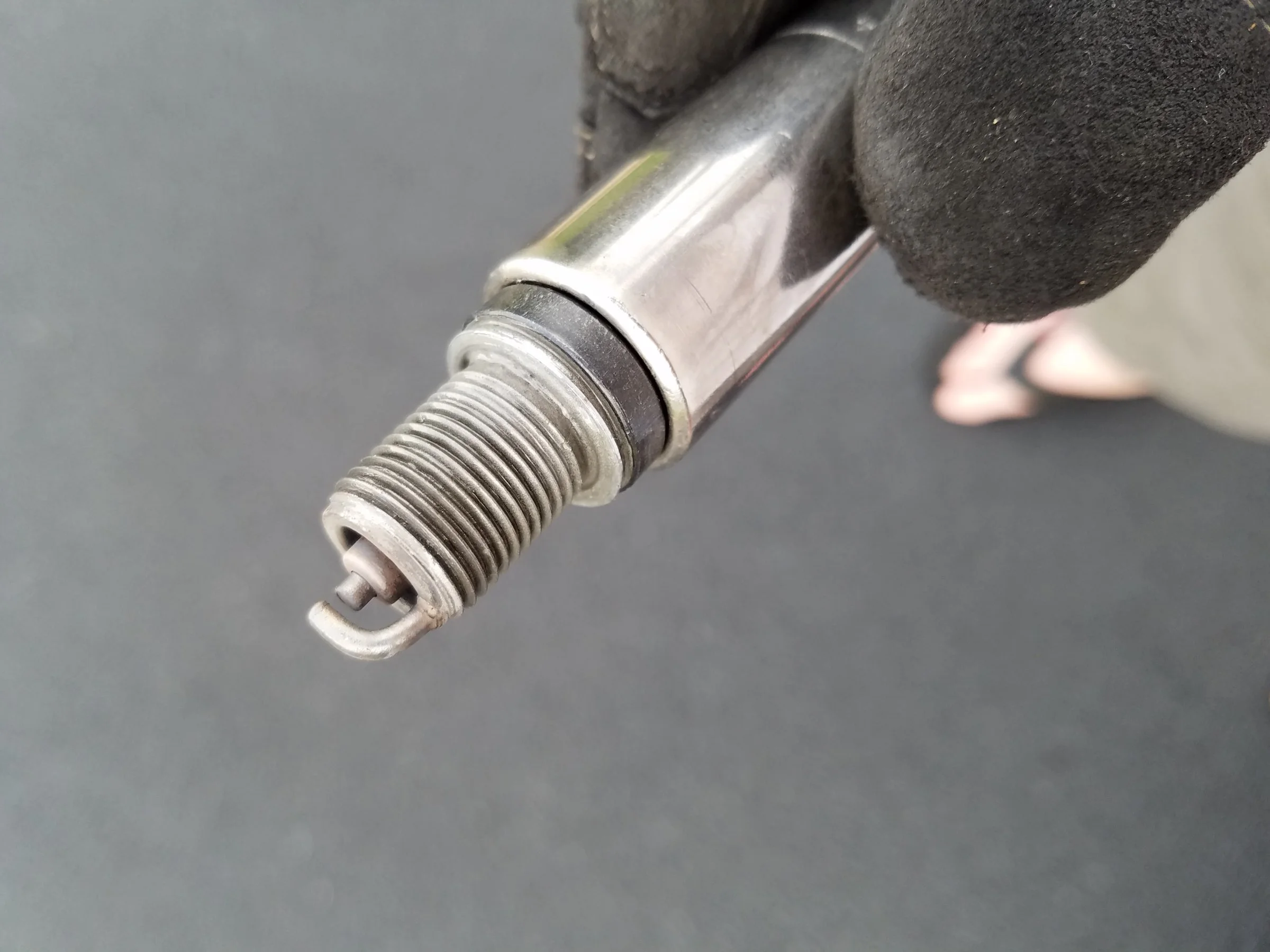

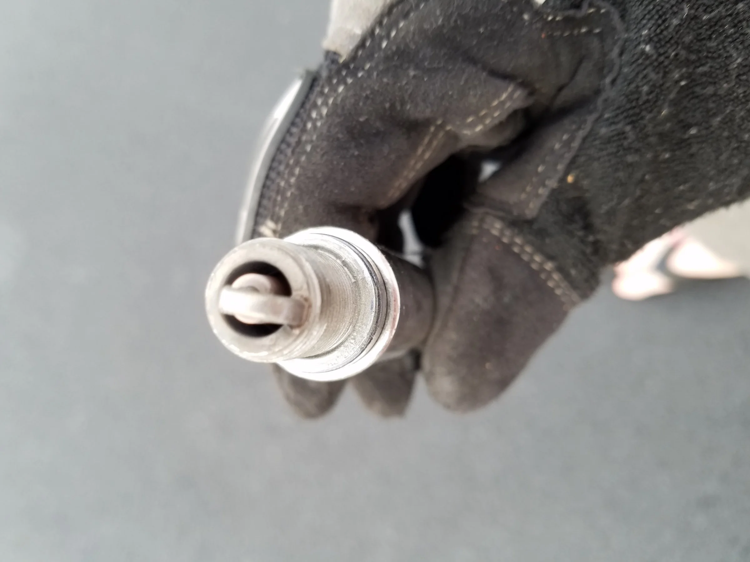

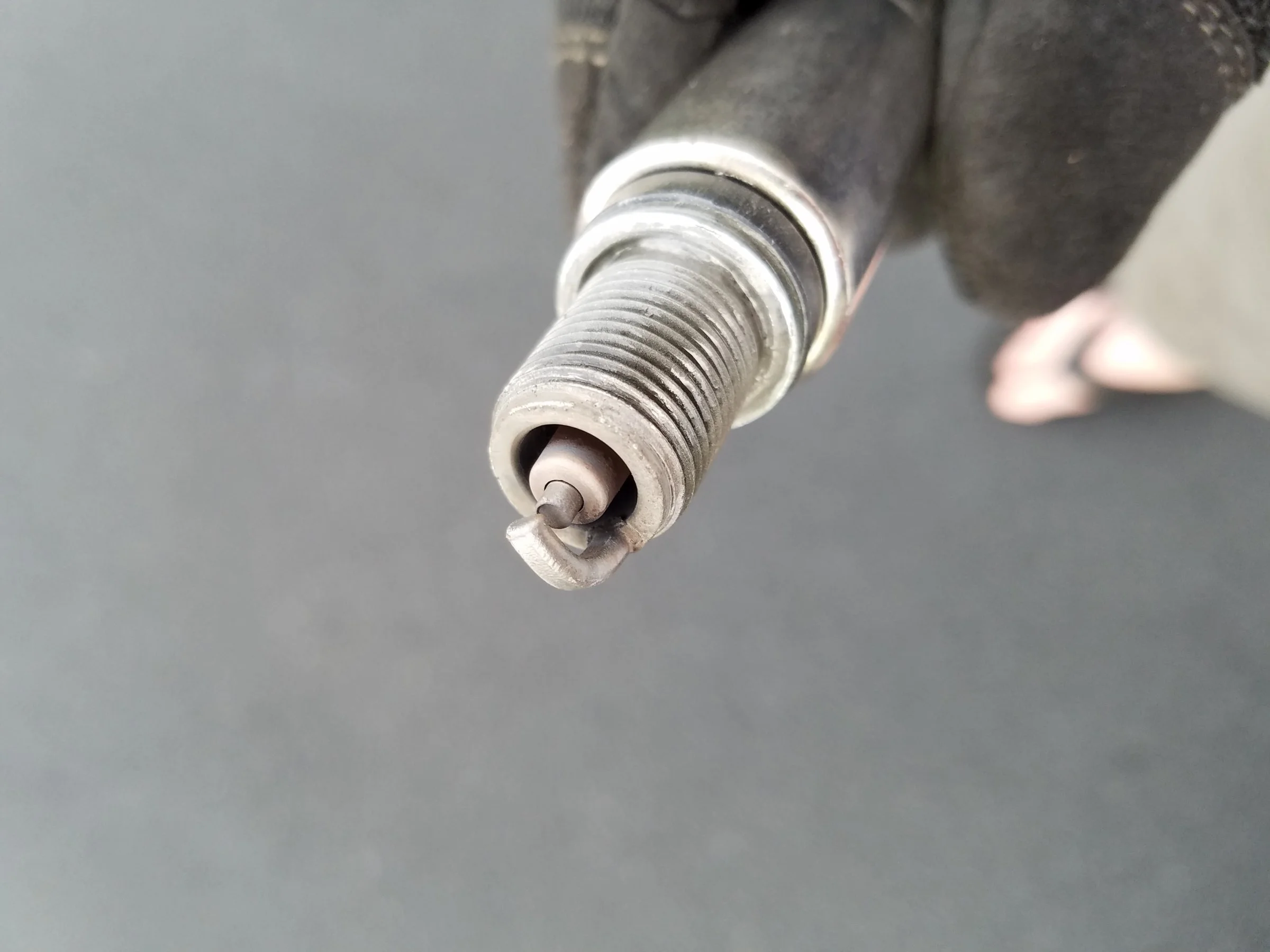

In went a 50 shot and I pulled 4 degrees of timing, back to 10 initial. Also had some race fuel still mixed in, so probably not necessary. I left the autolite 3924's in that I normally run. I have no idea if what I did is a no no, or acceptable, but I cleaned the number 5 plug with carb cleaner and a wire brush, in an attempt to clean it up before I sprayed it.
This is what it looked like with the car cut off about 2-3 seconds out of the throttle.
Can you tell anything at all from this plug? I suspect that my cleaning methods are not acceptable. I do have fresh plugs for Friday.
