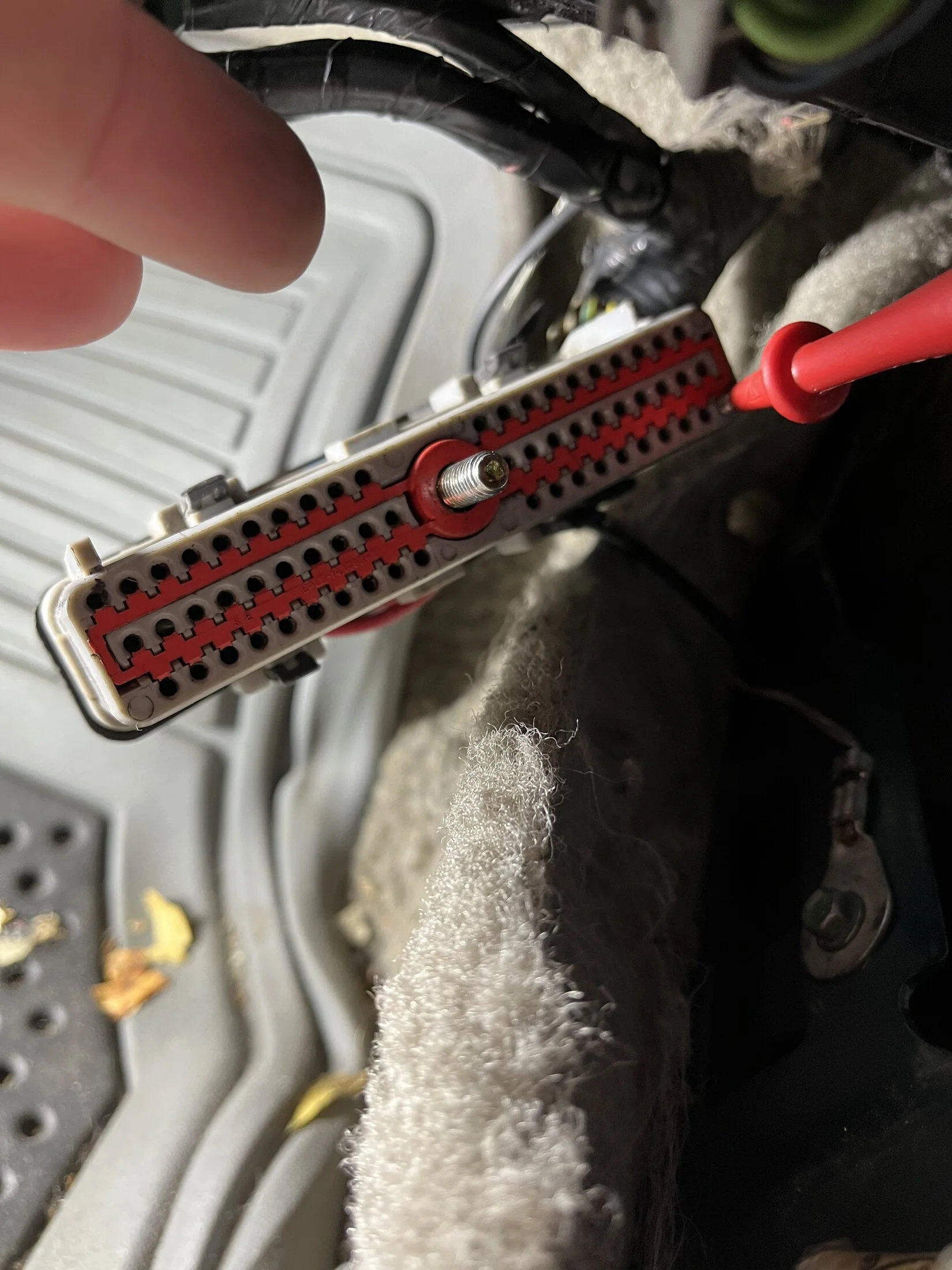

Decided I would pull the codes to make sure non were there. Got 11, 10, and 15c.
Is this the correct place to check for constant 12V?
if so, what else can I check to confirm my kam is shot?
Will having the ecu out clear codes? or do i have to do the hooked up, pull ground and turn on headlights thing?
