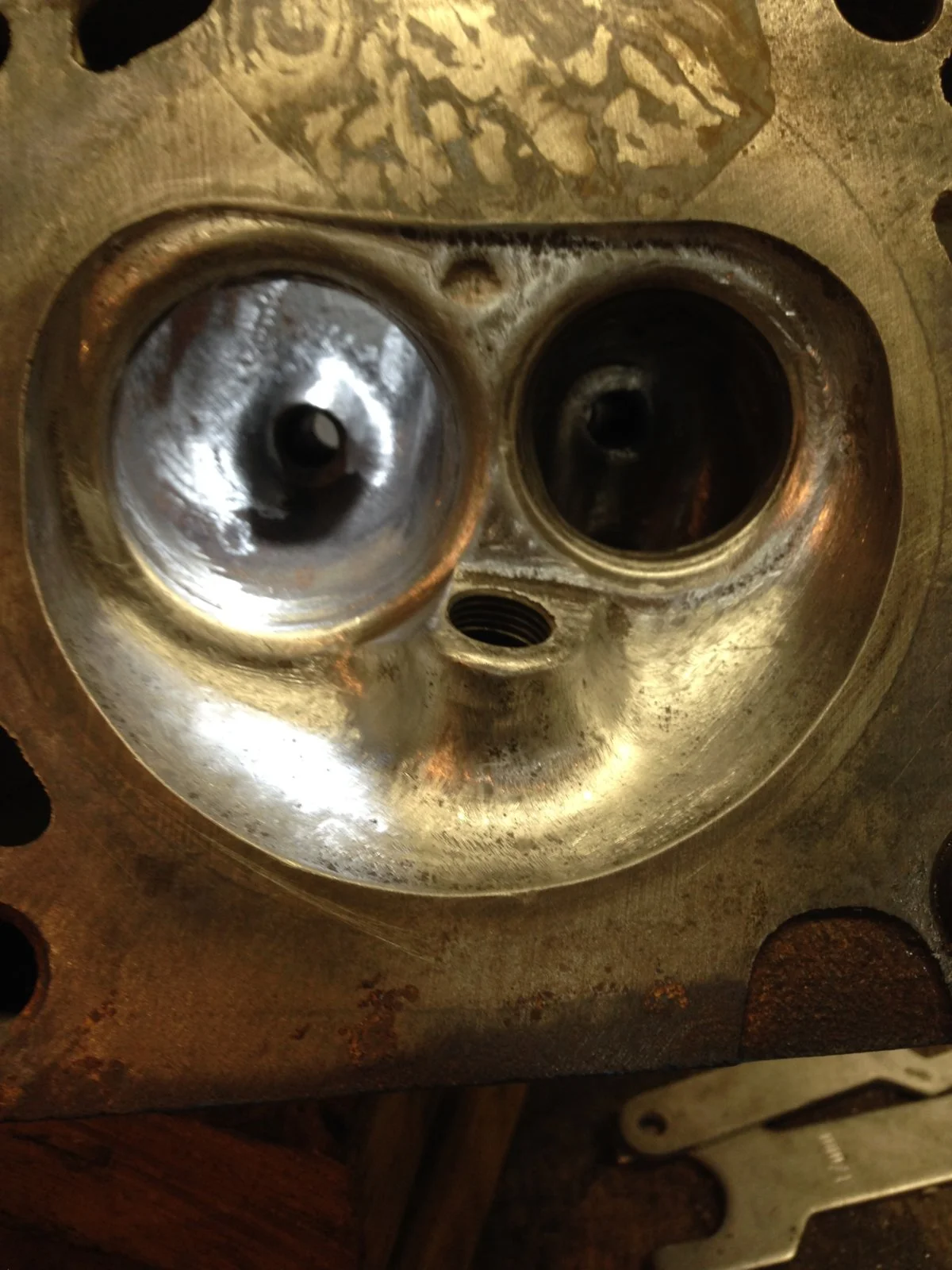

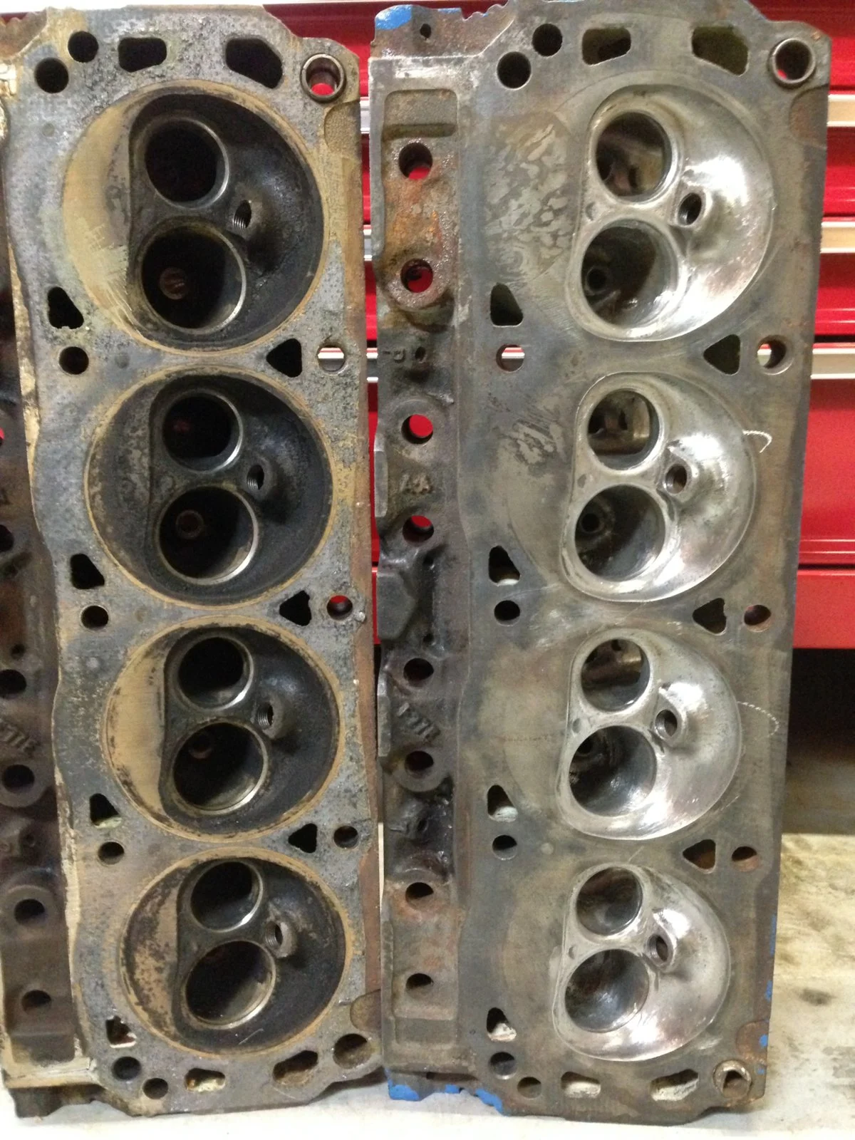

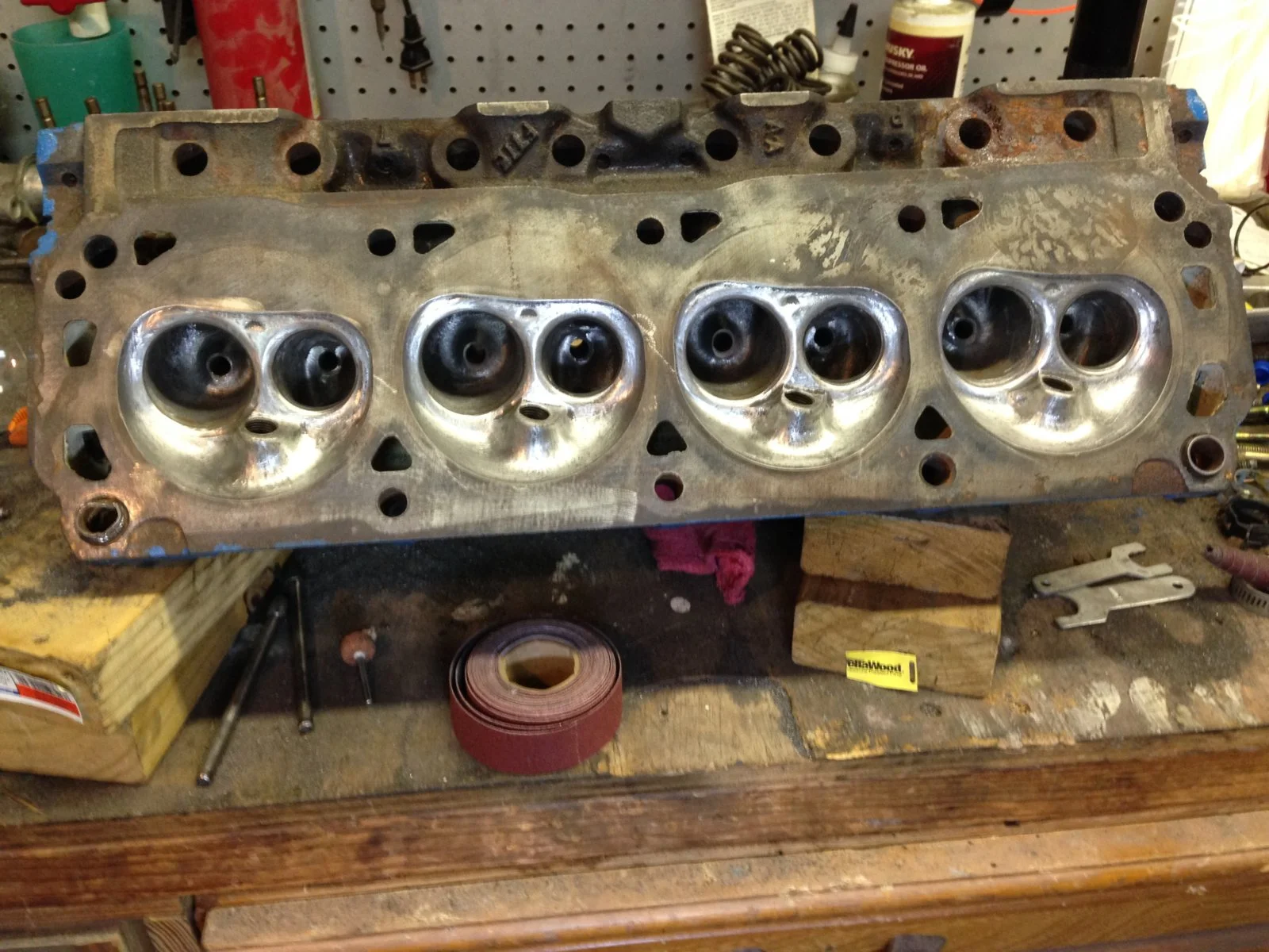

Your solution is about where I landed, although haven’t tried it yet. Reports say it’s good for 12 cfm. That’s a lot for not a lot of effort!
Epoxy is definitely a bust.
Check out http://www.diyporting.com/ before doing anything else. There is some very interesting information on porting GT40 heads.
I’ve read, re read, and studied those pages many, many times. There is a lot of good DIY porting info out there and that is among the best!
Another good thread is on Corral. Tinman did some work on a set of GT40s and they worked better than a lot of aftermarket aluminum heads.
I studied it a long while a year or so ago and went to work on a set of P heads. Flow tests showed and average of 18% improvement over stock. Was it worth the effort? No. But it was fun to learn. I ruined a head in the process and cut it apart to learn what was inside.
