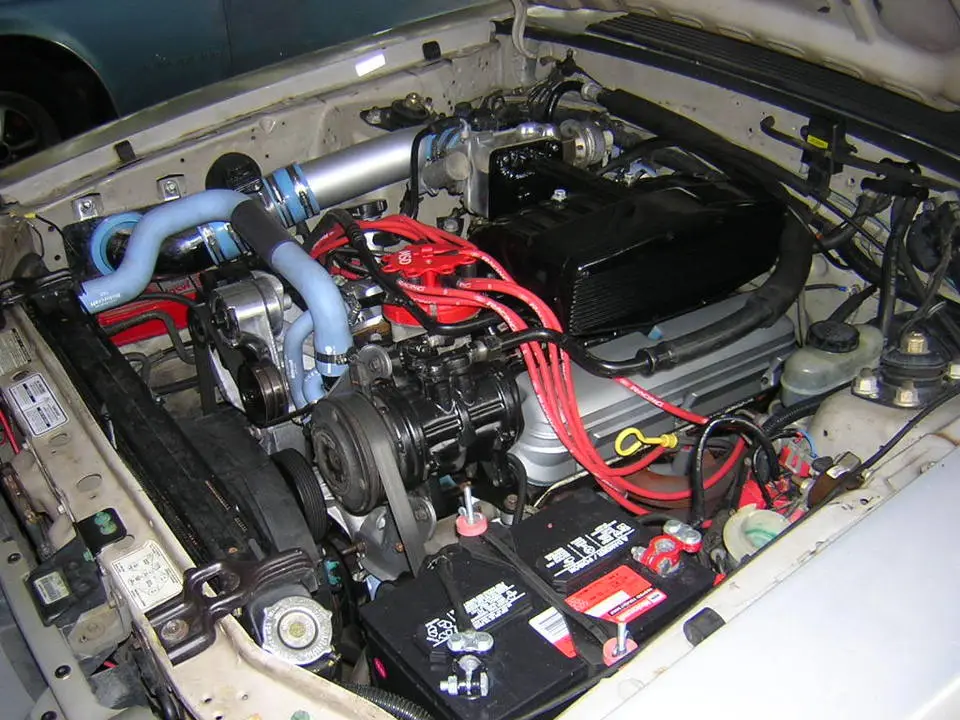

I have the typhoon intake and like it very much. Out of the box it fit perfect and i had no problems. Now its ported and i'm putting 468hp to the wheels on the juice.
Holy moly that thing looks awesome. I plan on having the intake port patched and cleaned up a bit. Machine work is cheap for me since my bud owns a high performance shop. I think im gonna go with the Typhoon since i plan on adding serious mods later.

Thanks for the compliment but thats not even in show form. I just happened to snap a shot after putting on new headers. Oh and its a daily driver.
