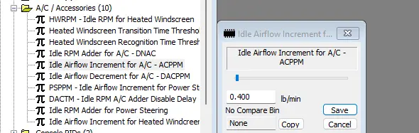

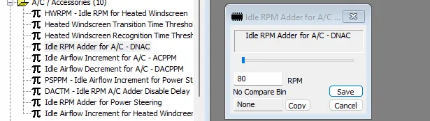

If the AC is causing a surge, the system is failing to adapt. Not sure how you tune that out.
Do i know the answer? No, likely a great question for the late Jrichker.
In the stock tune there are several options, but none are accessible without a QH or some type of chip.
"Idle RPM adder for A/C - DNAC" I use this one and add 80RPMs
You can also add additional idle airflow with "Idle Airflow Increment for A/C - ACPPM"
