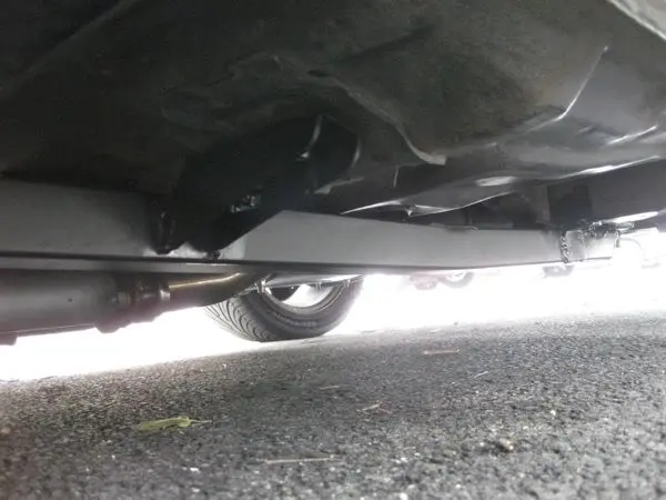

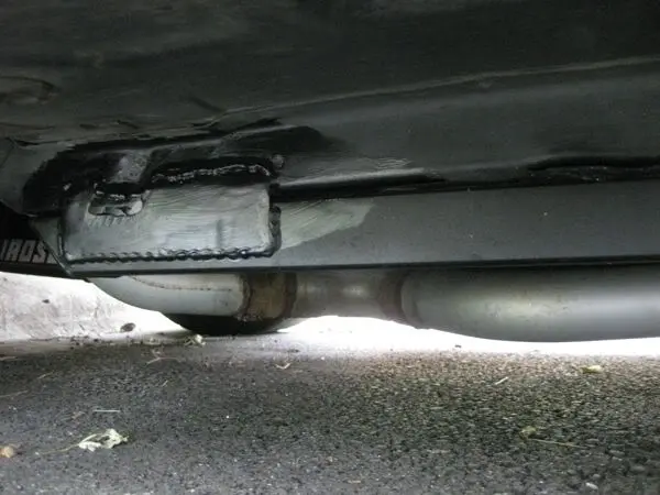

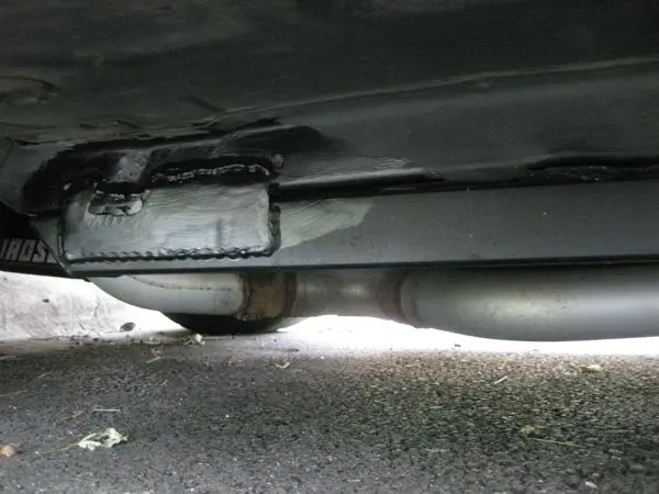

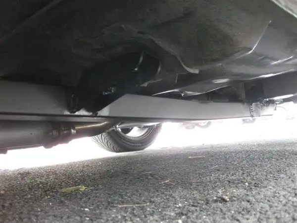

Finally got something a little "bigger" than the little ticky tack stuff. I had a friend weld in my SFC's over a weekend. He owed me a favor so it was free. Yeah!
These are Maximum Motorsports full length. I recommend them...definitely feel a difference. One thing I would've done differently was paint/undercoat the bottom side of the frame rails that the SFC's cover up. I don't think I can get to it anymore. I might be able to get a thin brush in there or I'll just leave it.

Nice car and really like what you've done.:nice: Just got the MM's myself going to weld them in a couple weeks. Thanks for the tip about painting b4:D
Yeah, I'm kinda kicking myself for not thinking ahead but the good thing is that my undercarriage is pretty clean and I don't drive in snow or rain. Good luck! To be honest if I were to do it again I'd just bring it to a place LOL. It was just a long 2 days on our backs and lots and lots of grinding and welding. I'm just glad it's done :)

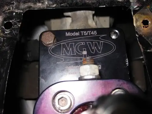

July 17, 2011 - short shifter

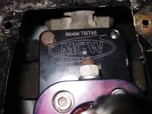

Installed a MGW short shifter...
...with the silver racing handle.
B/c of the short silver racing handle is shorter, it smooshes down the leather shift boot a bit. Still works great though. I highly recommend this shifter!

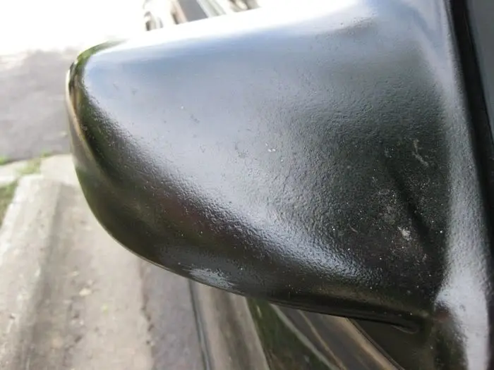

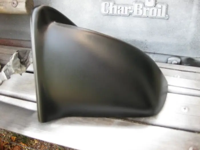

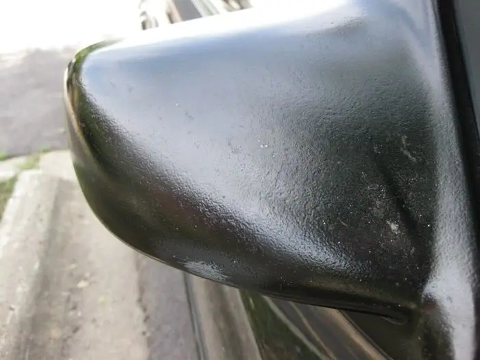

July 18, 2011 - Passenger side view mirror

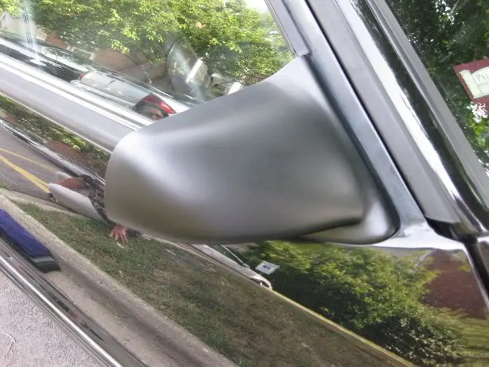

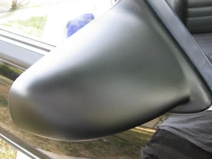

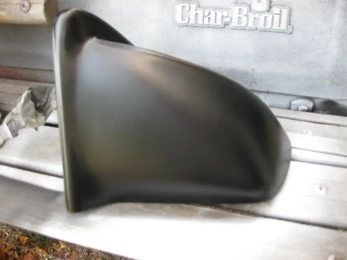

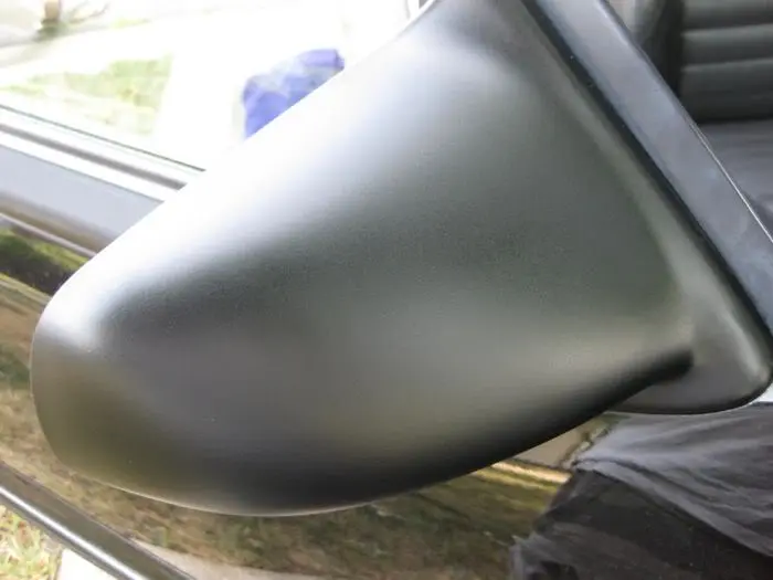

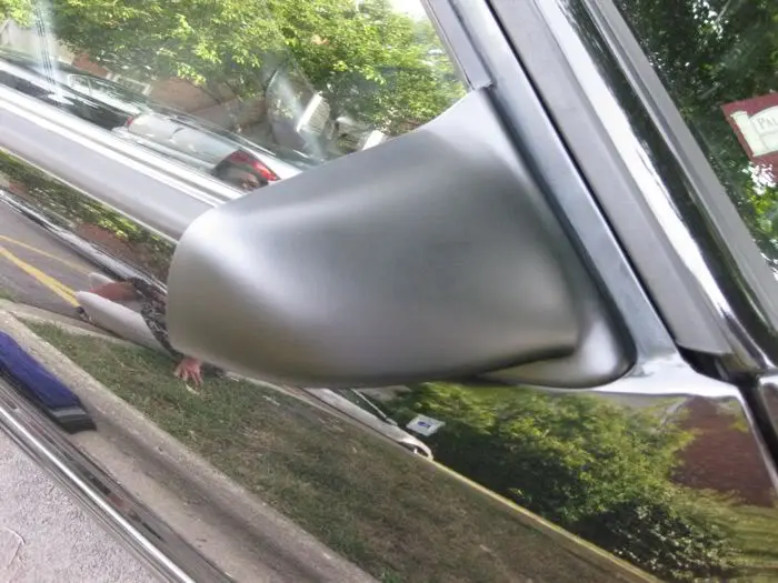

I've been wanting to fix this for a long, long time but once again it's a little bit of a challenge when I don't have a garage. But I took advantage of this particular HOT summer day in Chicago with absolutely no wind haha.
Here's a shot before:
Sanded it down, primed with plastic primer then more light sanding:
Then hit it with some trim paint (a couple coats):
End result:
I don't know what it is but I love these simple small projects. You start with something all jacked up....but with a little time and effort it looks a whole lot better!

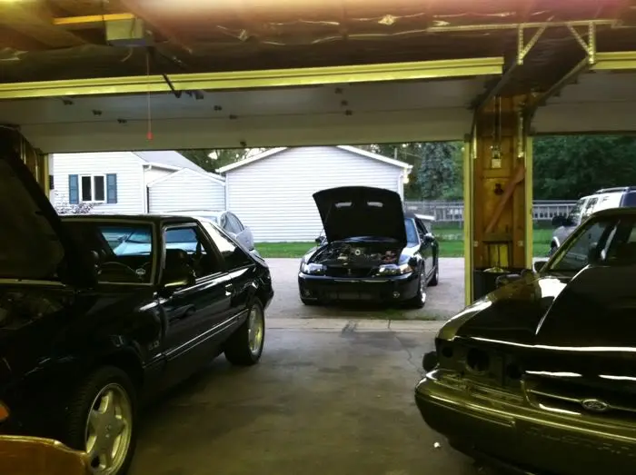

July 29, 2011 - it's in the garage!

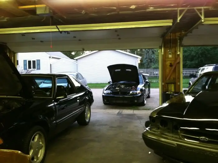

Finally on 7/29 I got my car in my friend's garage. We had to delay a little while b/c he had so many things going on. His notch is on the right and the 03 Cobra is his dad's in the way back.
Even though we got it in the garage we didn't do anything LOL. We just went over all my parts and realized that we were missing a few things here and there. Basically laying out "our plan". Here's the basics of what we're doing...

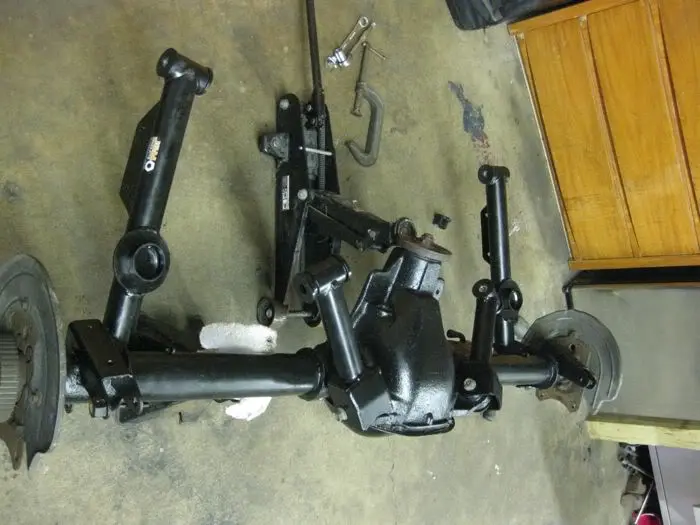

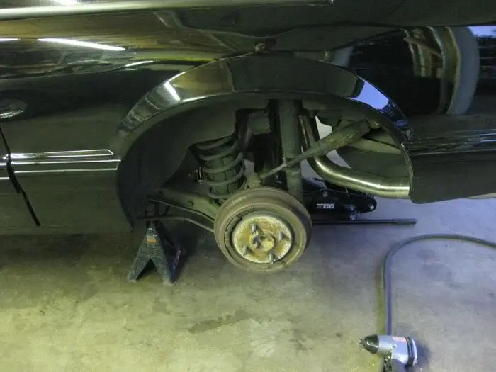

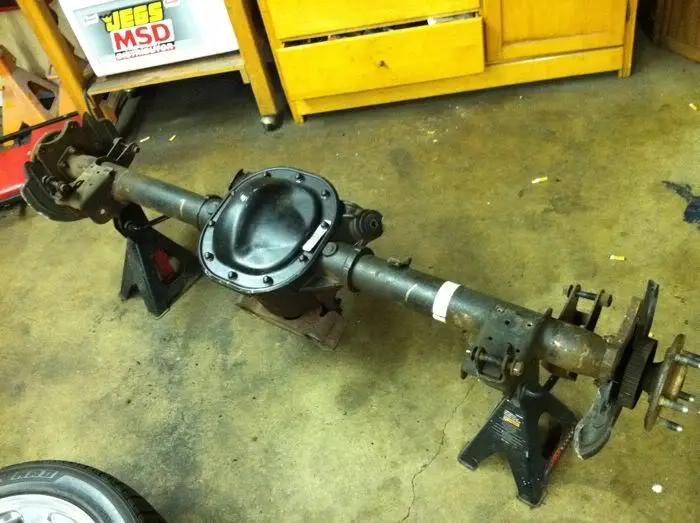

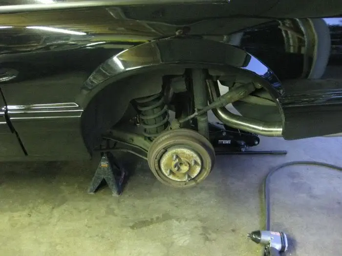

August 5, 2011 - Starting w/ the rear!

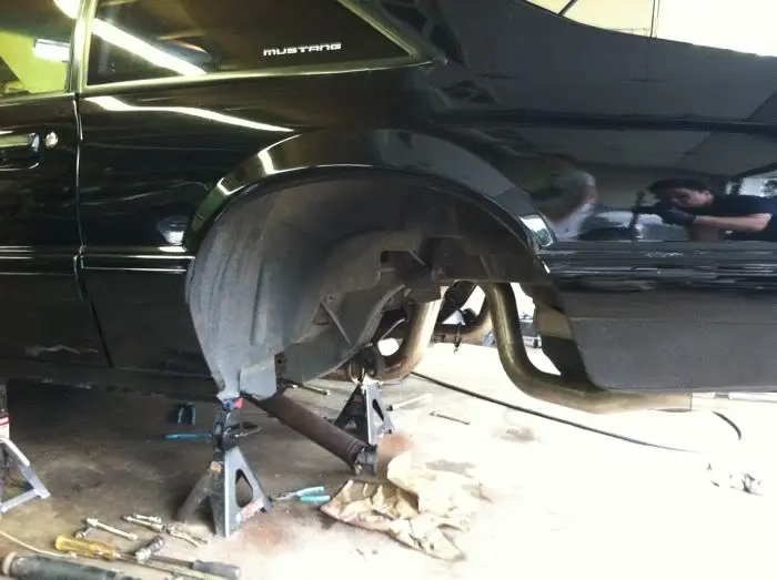

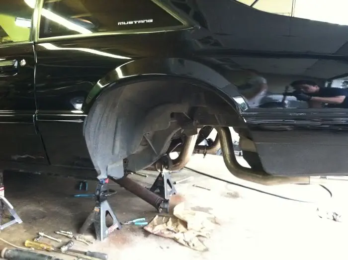

Up on jacks ready for action...

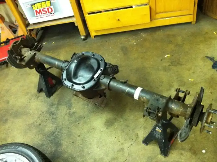

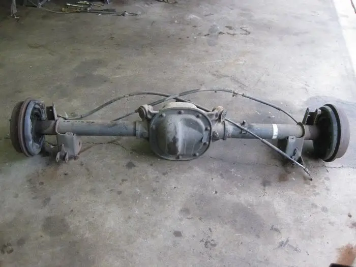

It definitely took a lot of banging and yanking but we got the whole rear end out. The lower control arm bolt near the torque box probably took us the most time.

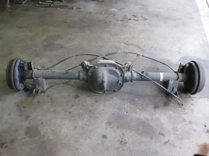

Here's the rear end out. Not bad..still pretty clean for a '93. Sold it to a friend of mine. One word for this thing: HEAVY.

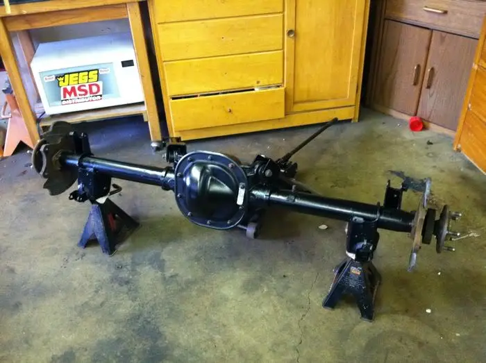

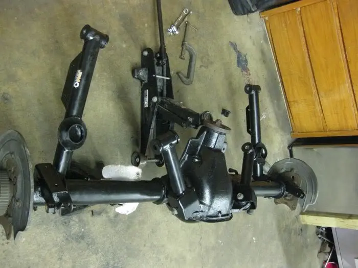

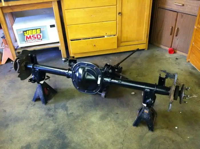

Here's the new rear end out of a 95 Cobra.
The new rear end was pretty clean but I figured I'd do a little sanding and hit it Chassis Saver. Looks a little better to me :nice:

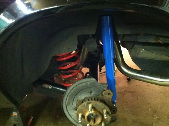

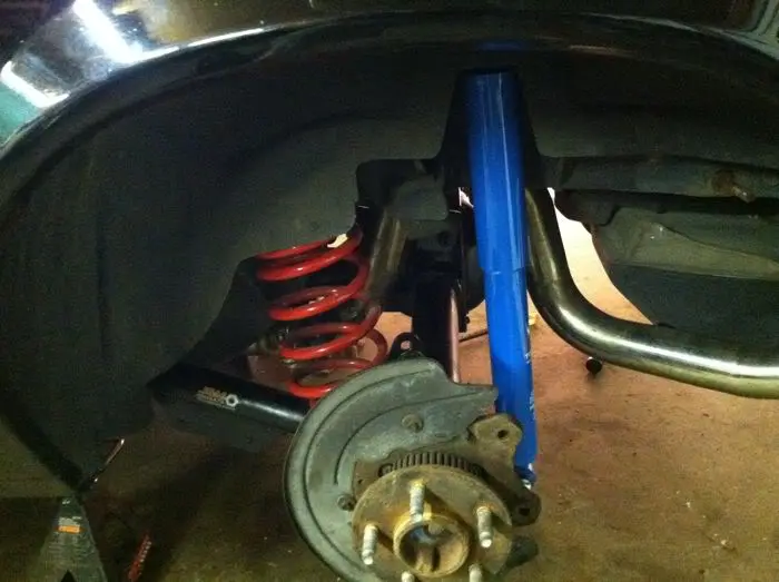

Here's the new rear end ready to get bolted in w/ J&M upper and lower control arms...
And it's in!!!
Also installed Tokico shocks and H&R Race Springs. Not sure how I like how it's sits but for now they will stay. I won't know for sure until I get the fronts done. For now I'm going to hang onto my stock springs.

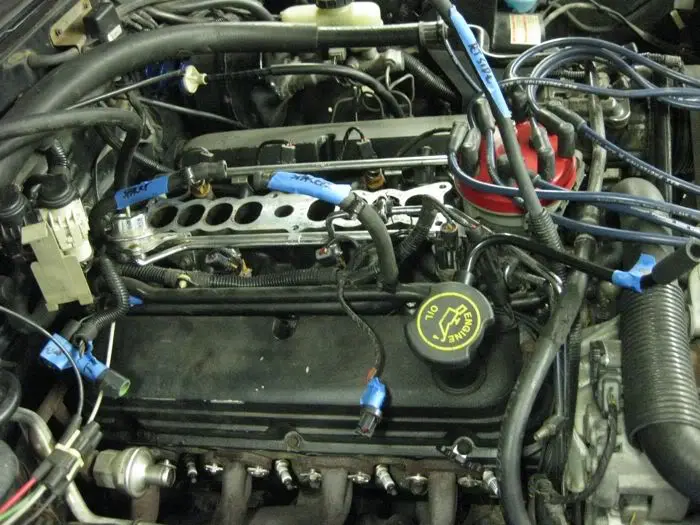

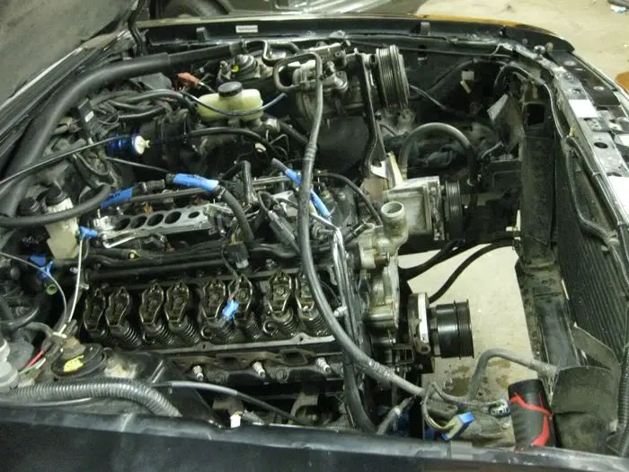

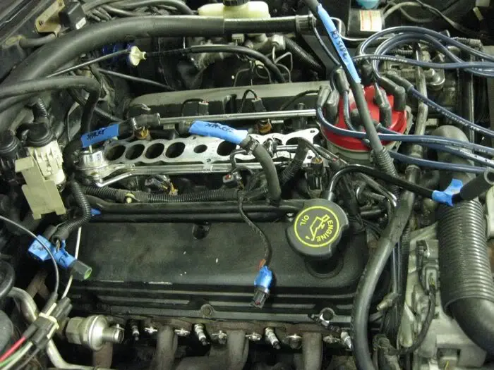

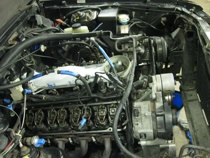

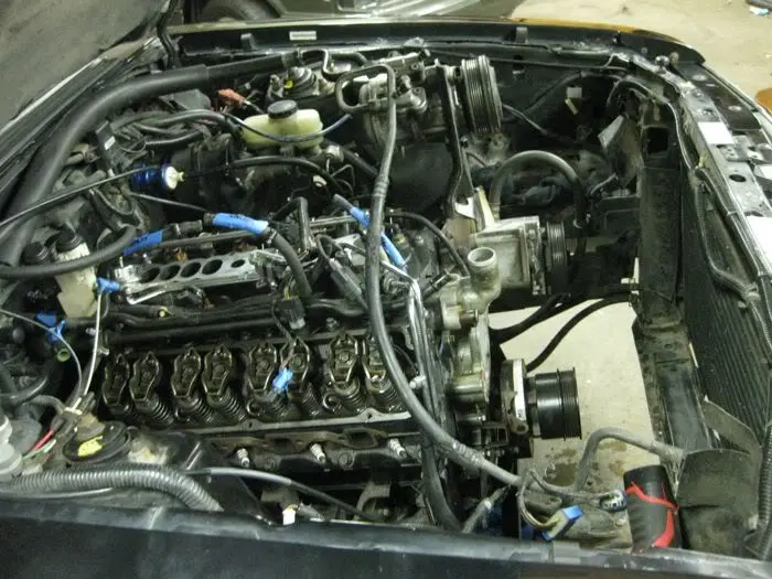

August - engine bay

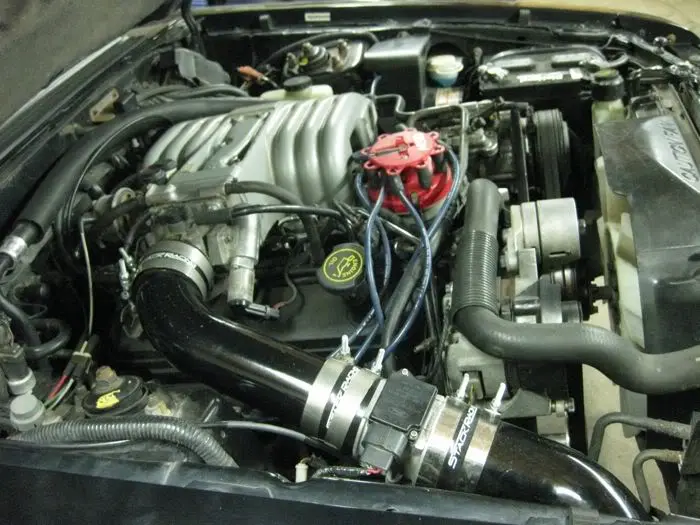

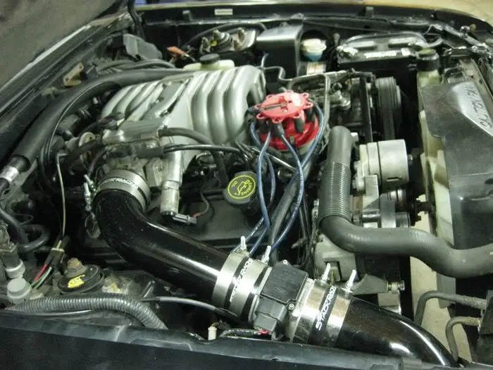

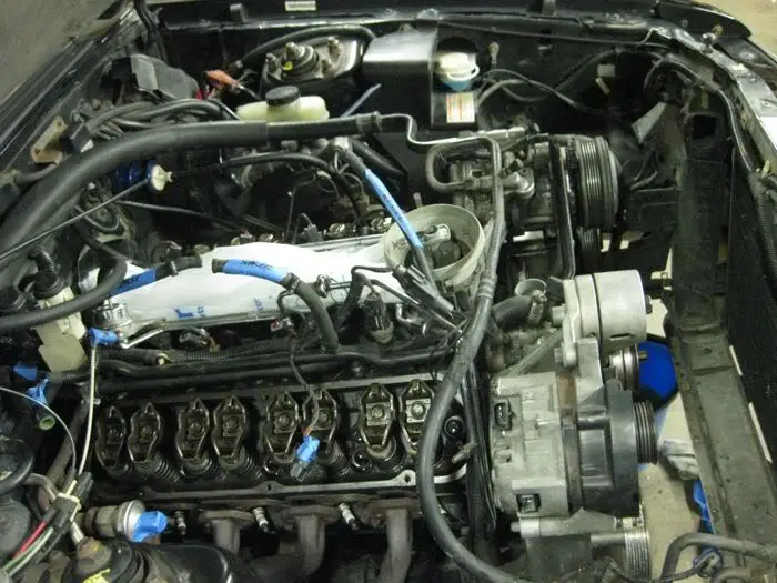

August 12, 2011 - Started to get busy in the engine bay! Here's a pic before:
Removed upper intake, spacer, TB, etc....
Got some more off...
And here's the latest...LOOK AT ALL THAT ROOM HAHA!
I'm FINALLY up to par on my progress. Everything going forward will be somewhat up to date!
