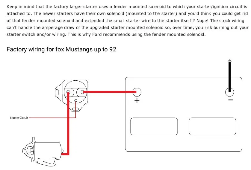

Curious to see pics of anyone does this. This is on my list to do but haven't done it yet.
Obviously pre-92 guys can't do this unless you have swapped to the mini starter setup

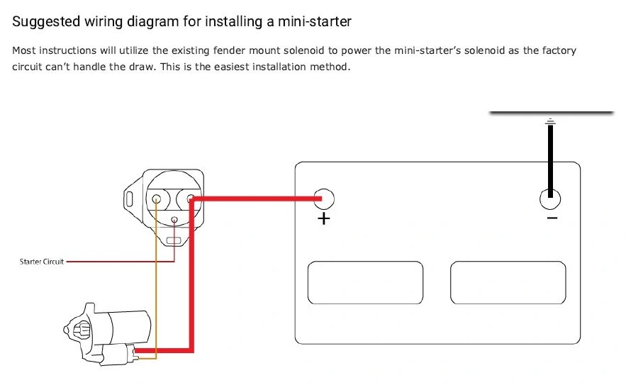

You can run something like this, and mount it on the other side of the fender if you want (although you'd need to jack car up and pull wheel to access when you need to)
At that point, you can activate the starter with a simplyl relay.

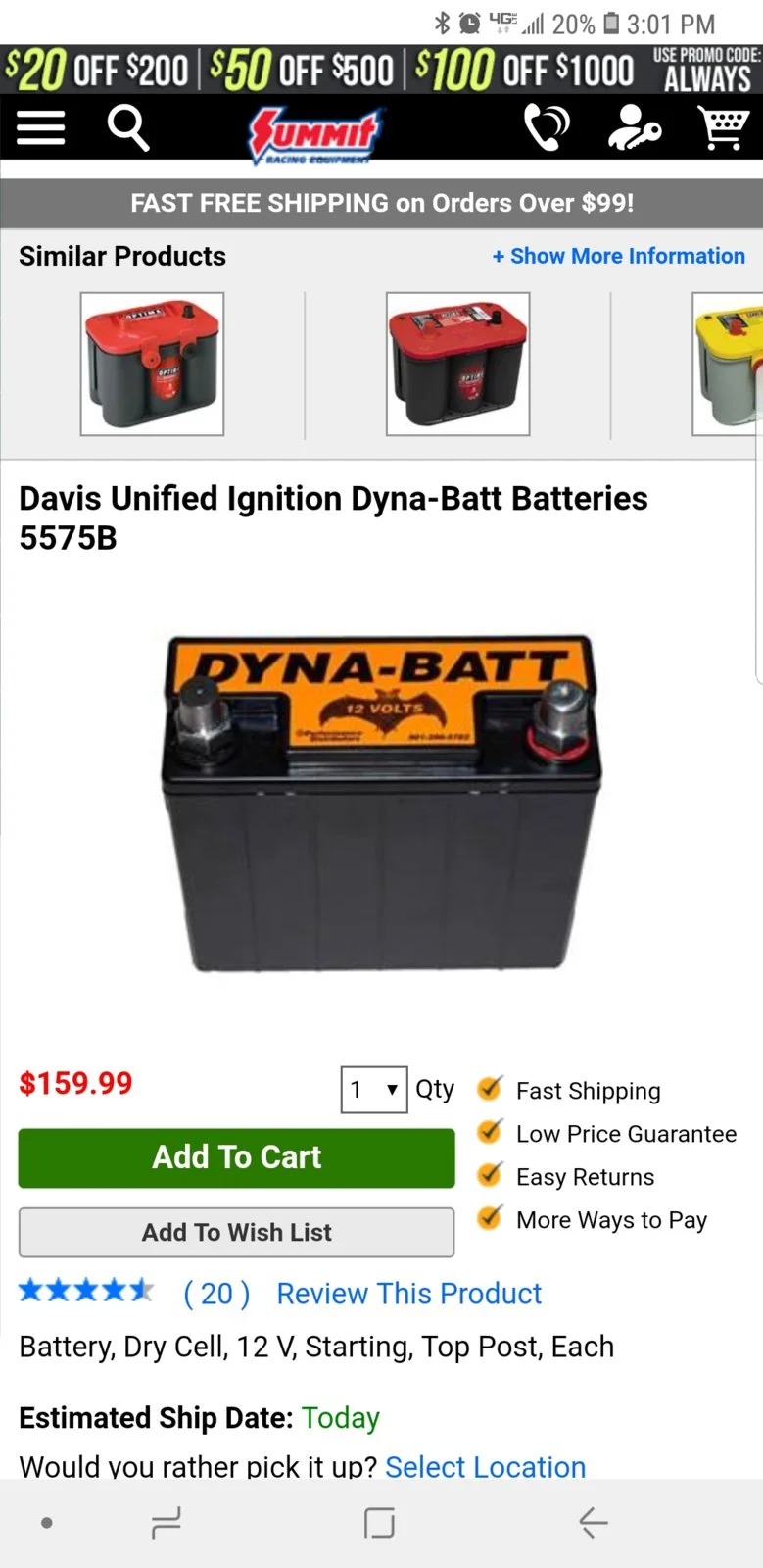

I always wanted to see someone custom mount one of these batteries under the hood of a fox. It's really small but powerful...about 1/2 to 1/3 the size of our batteries. You could make a nice painted bracket and mount it closer to the fender apron....or behind the fender...

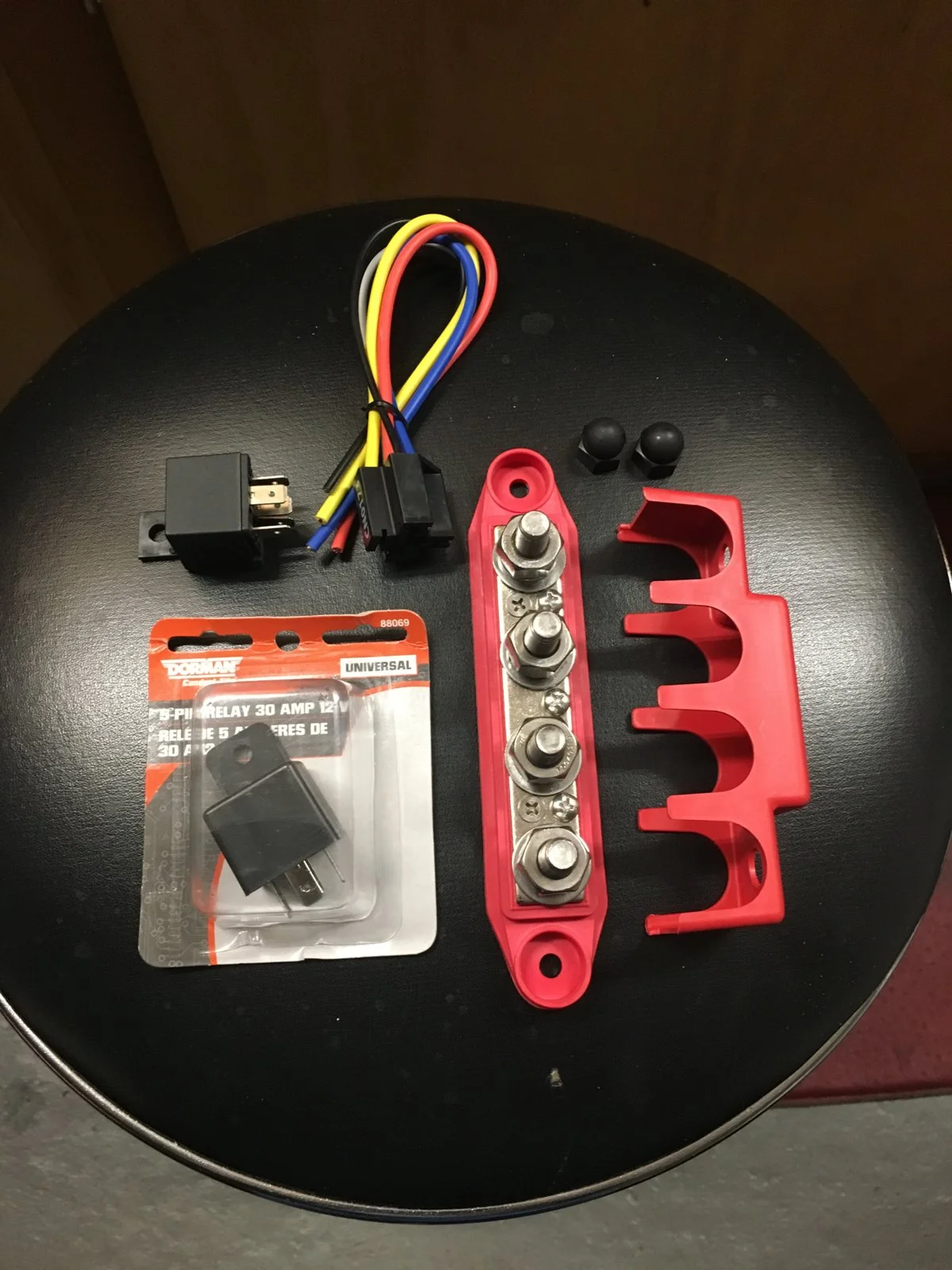

I did mine . Its in my inner fender now . I haven’t fired the car yet but it’s wired as you described .Curious to see pics of anyone does this. This is on my list to do but haven't done it yet.
Think this guy that noobz toldI always wanted to see someone custom mount one of these batteries under the hood of a fox. It's really small but powerful...about 1/2 to 1/3 the size of our batteries. You could make a nice painted bracket and mount it closer to the fender apron....or behind the fender...

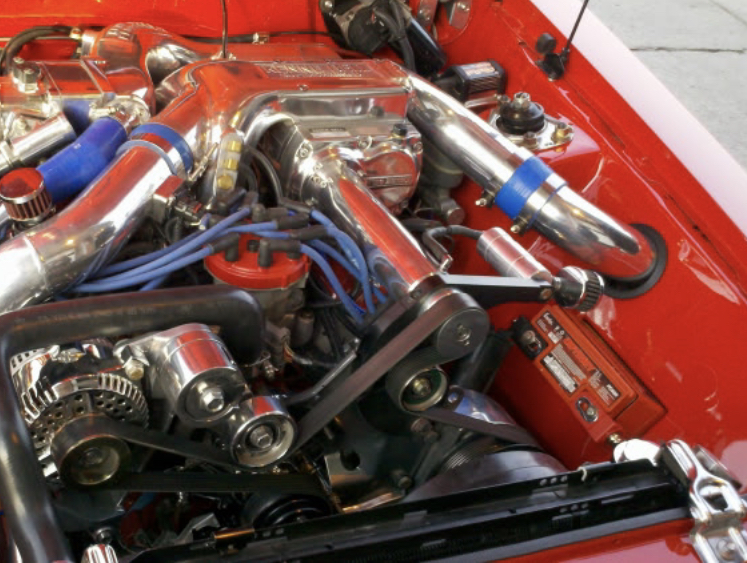

This possiblySeems I remember a magazine writeup on a custom that took one of those batteries, lay'd it on the side and recessed it into the fender well, only the top exposed the top where the posts are.
