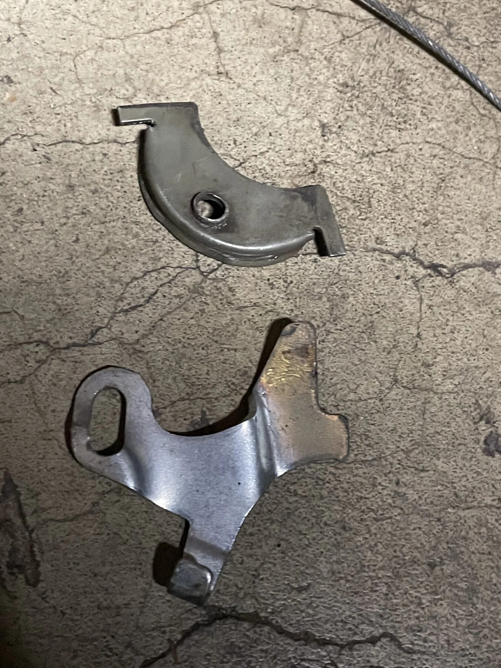

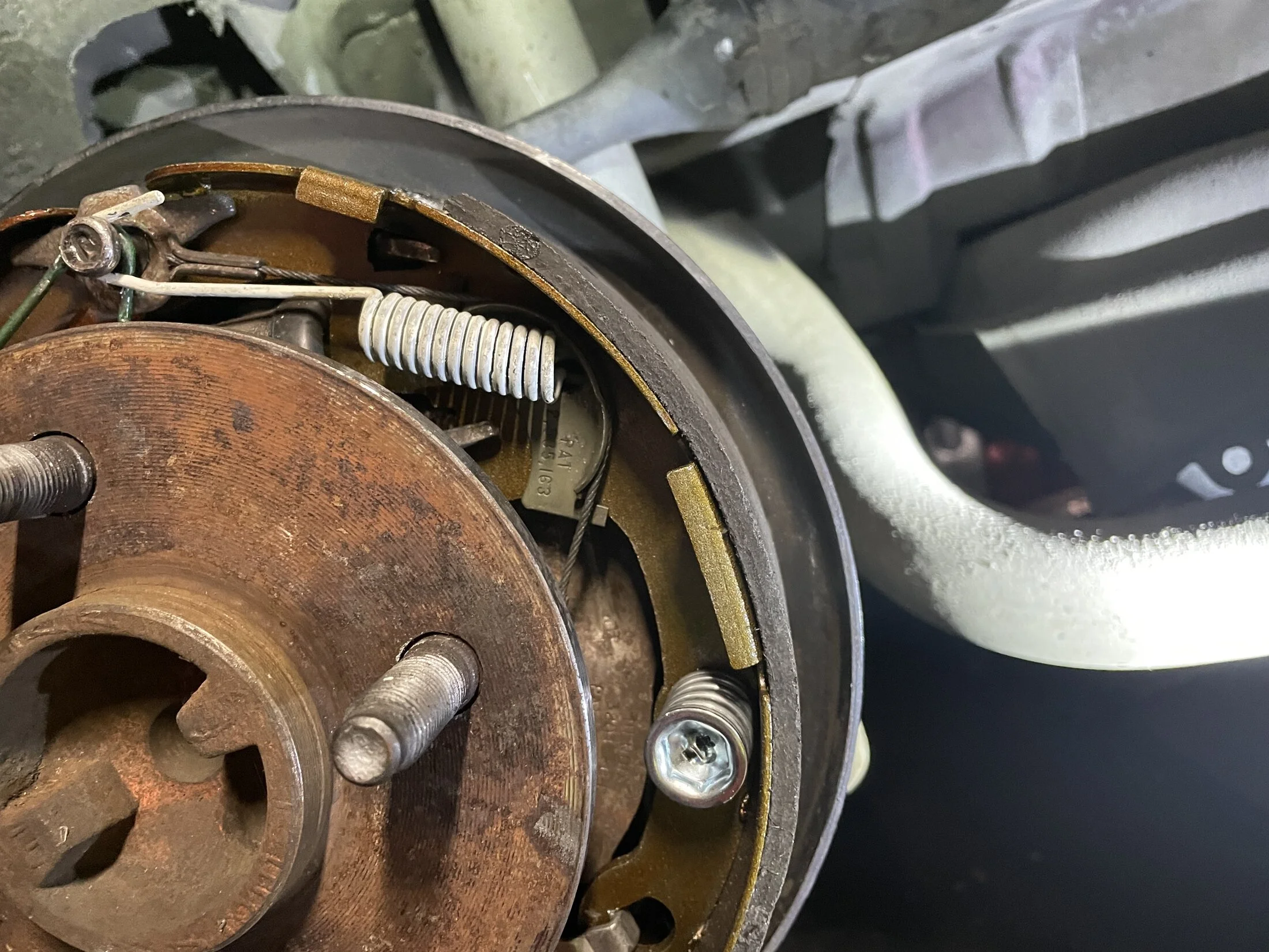

Here you go. The lower plate does not look so good now that you mention it.

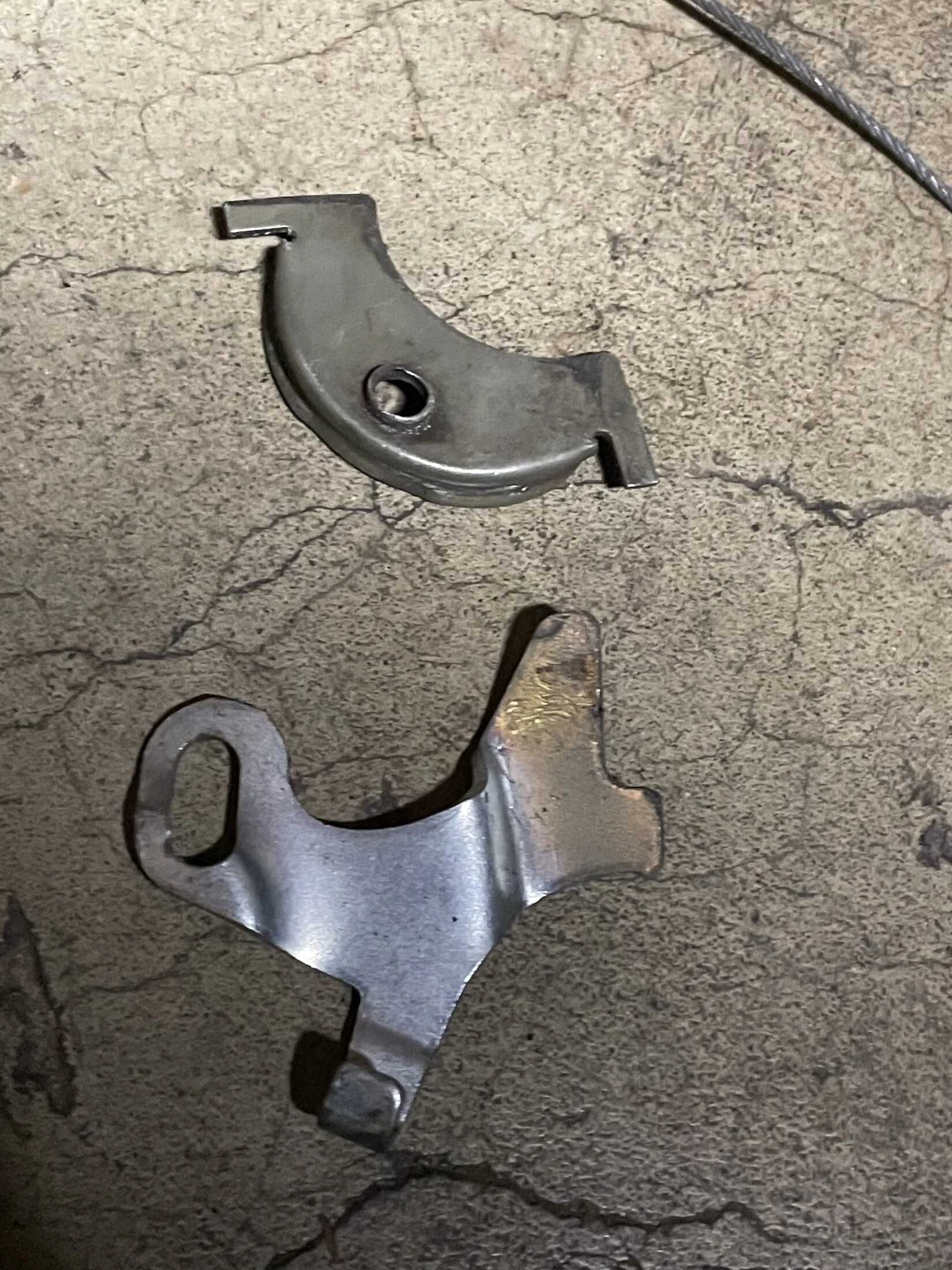

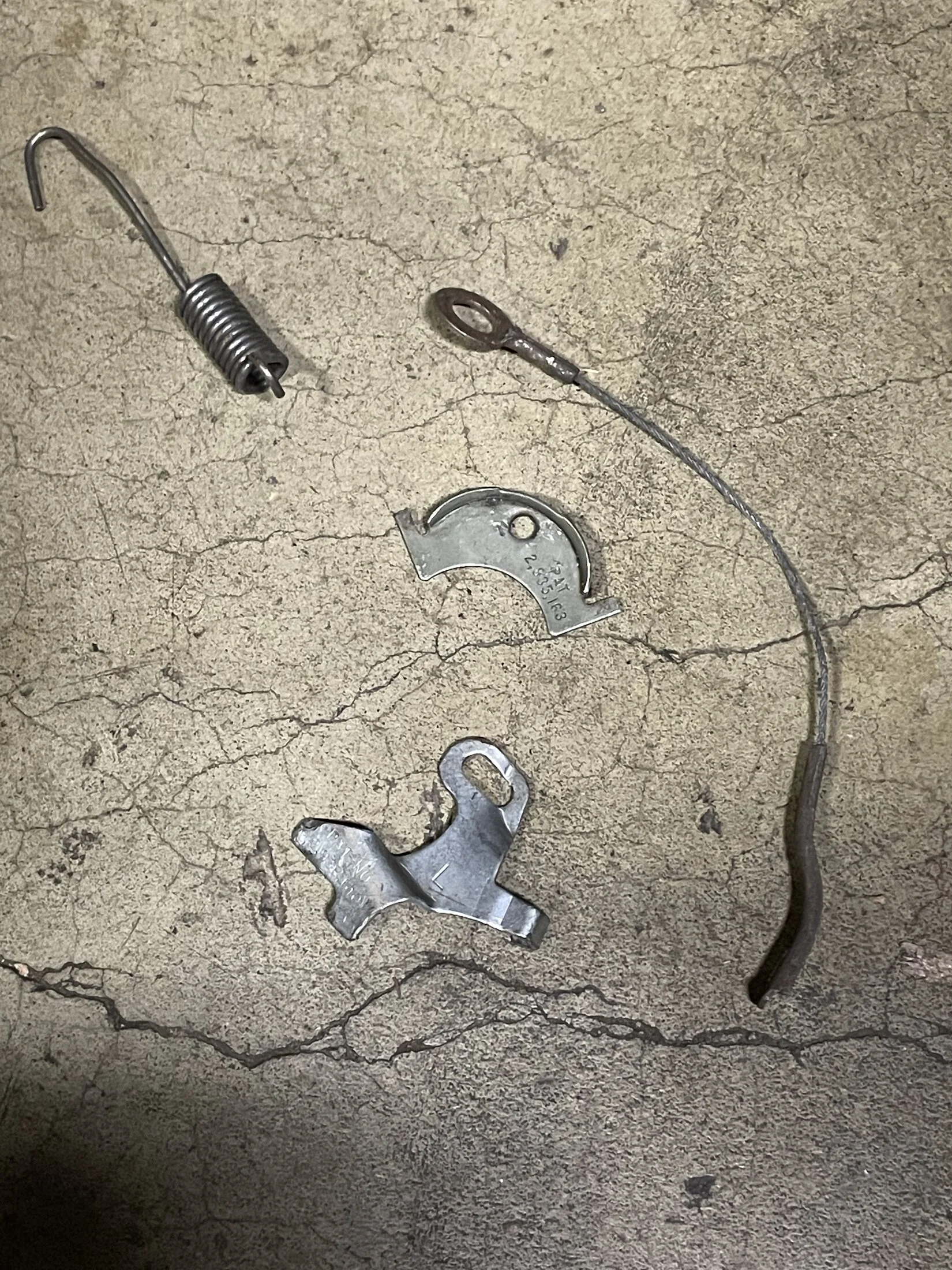

Here you go. Adjust does not look do great now that you mention it.

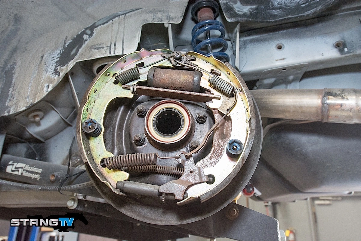

This is how it’s all supposed to go together.
Do you know how to adjust them once the drum is on? At about 5:00 in this video:
Good info on assembly in the video as well.
Apologies man. I never know what people’s skill set is so I tend to error on the safe side.
Anything hitting the heads one wheel lugs on the back side of the axle flange?
No worries. All good. I appreciate your input. I mean it :nice: No nothing poking through on the axle flange. I almost want to get another set of shoes just because? This thing is weird. Braking is no different though. Just the clicking.

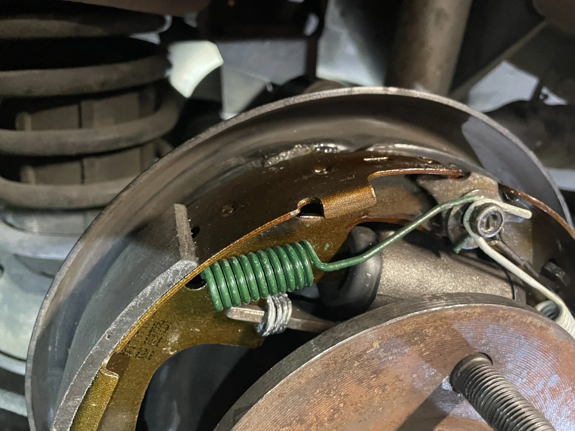

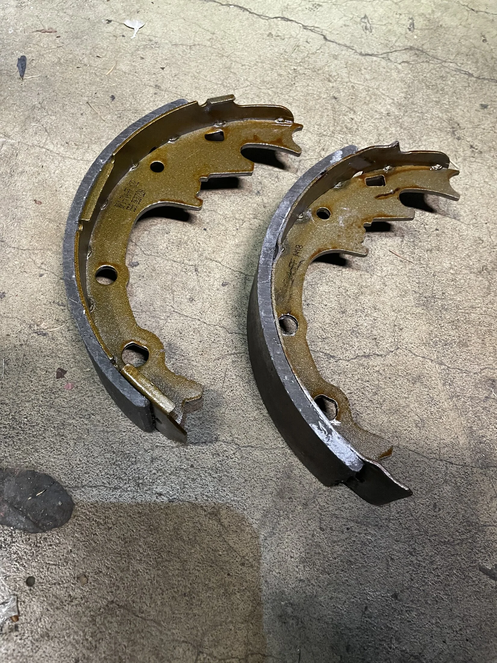

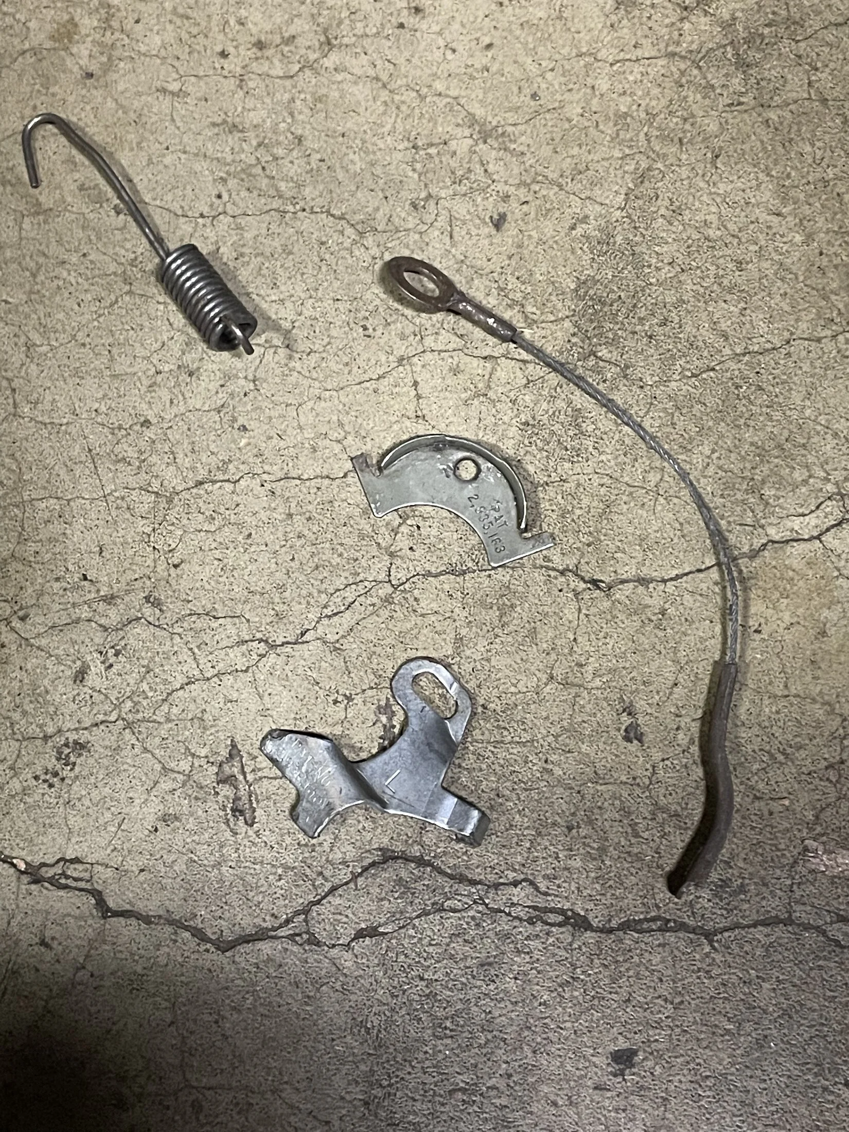

New shoes came today. Two things I noticed. New shoes have some ears to ride on the backing plate. Second, the pads are thinner right out of the box than what I took out. Weird because they are both reybestos. New is on the left. The one I took out is on the right.
I will put it together later this afternoon and hopefully drive it to work tomorrow.

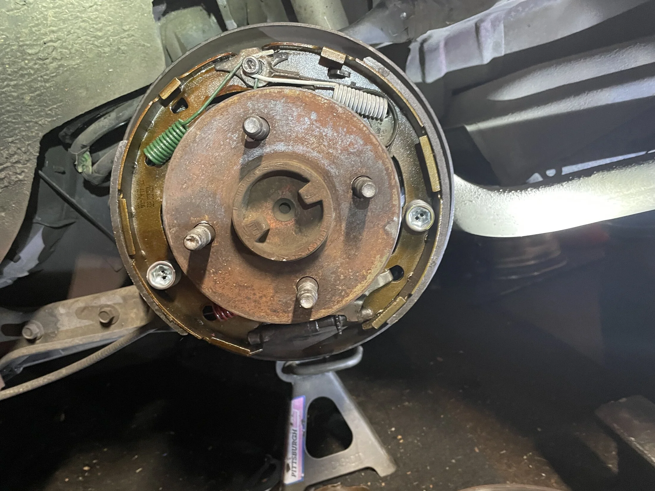

I put it back together. Got the car back on the ground but then it started to snow so I didn’t move cars to go for a test drive. Not sure it it will be gone by tomorrow:cautious:

So the snow thawed out enough today that I could go for a quick rip without worrying about getting stuck. I am happy to report no more annoying clicking.
Now I’m debating if I should change the other side out just for piece of mind.:chin

I'm glad you got to the bottom of that clicking issue. I'd do the other side just because the replacement shoe design looks so much better than the previous " new " shoes.
Ok I’ll change it when it warms up a bit.
