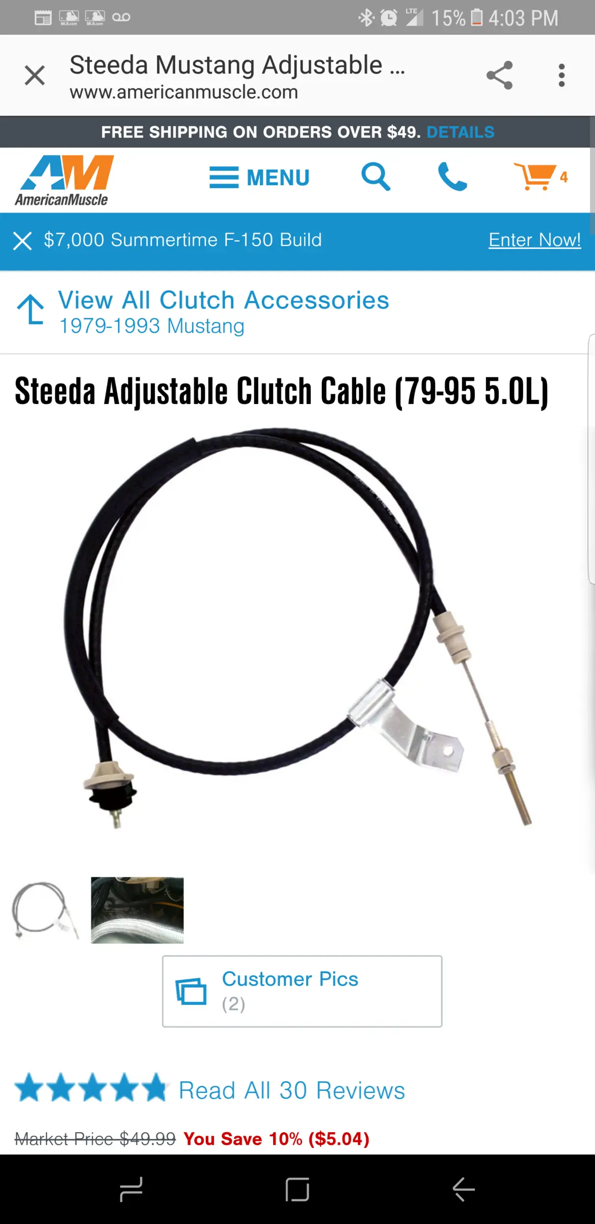

Even this one:
with how it it is coiled, should slide freely.

Also disconnect the cable and poor some motor oil down the tube until it comes out the other end then move the cable back and forth a little. The cable will now stay lubed. I've done this for years on many cars and have had zero issues with the el cheapo autozone clutch cables and even had the steeda adjustable that you pictured.

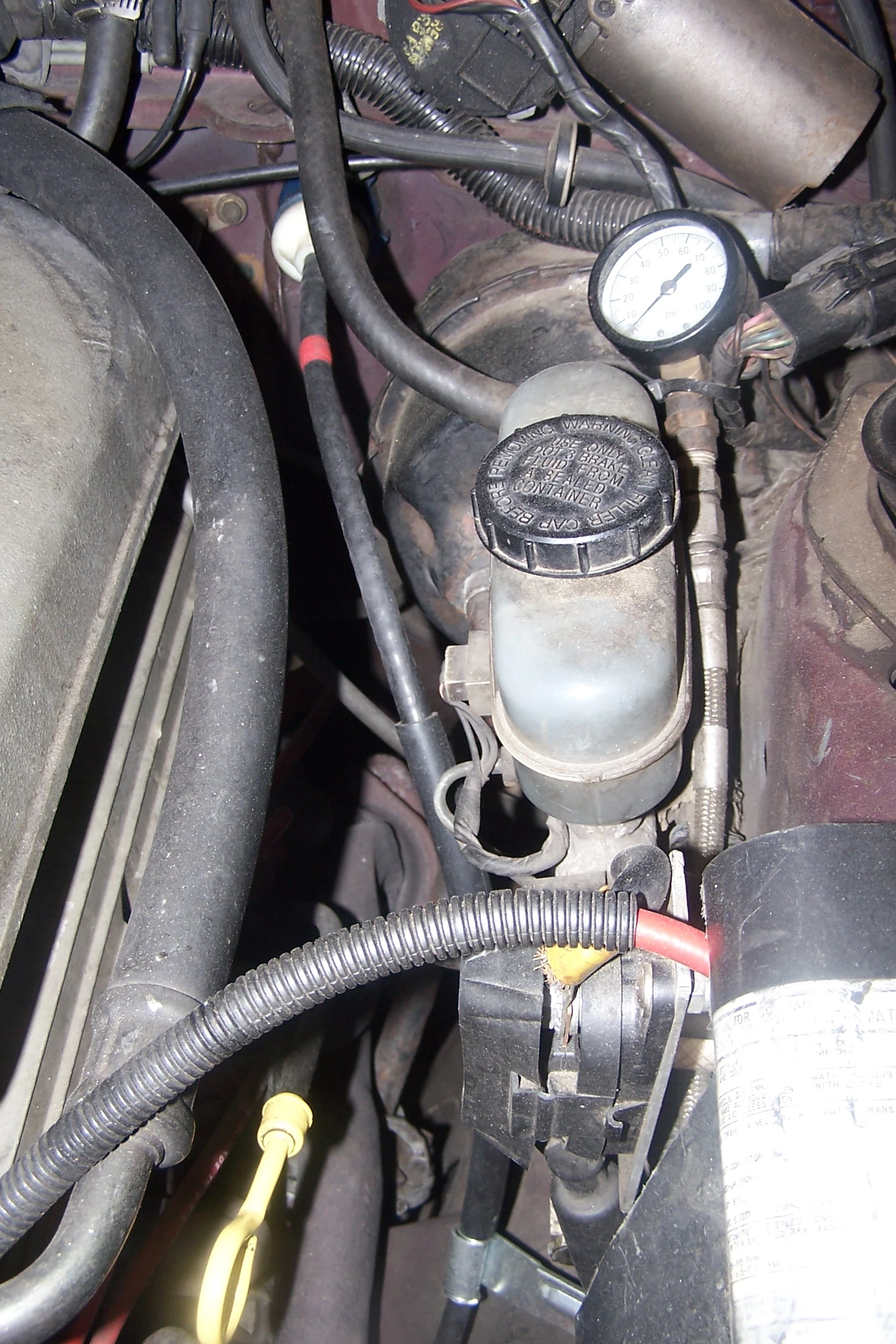

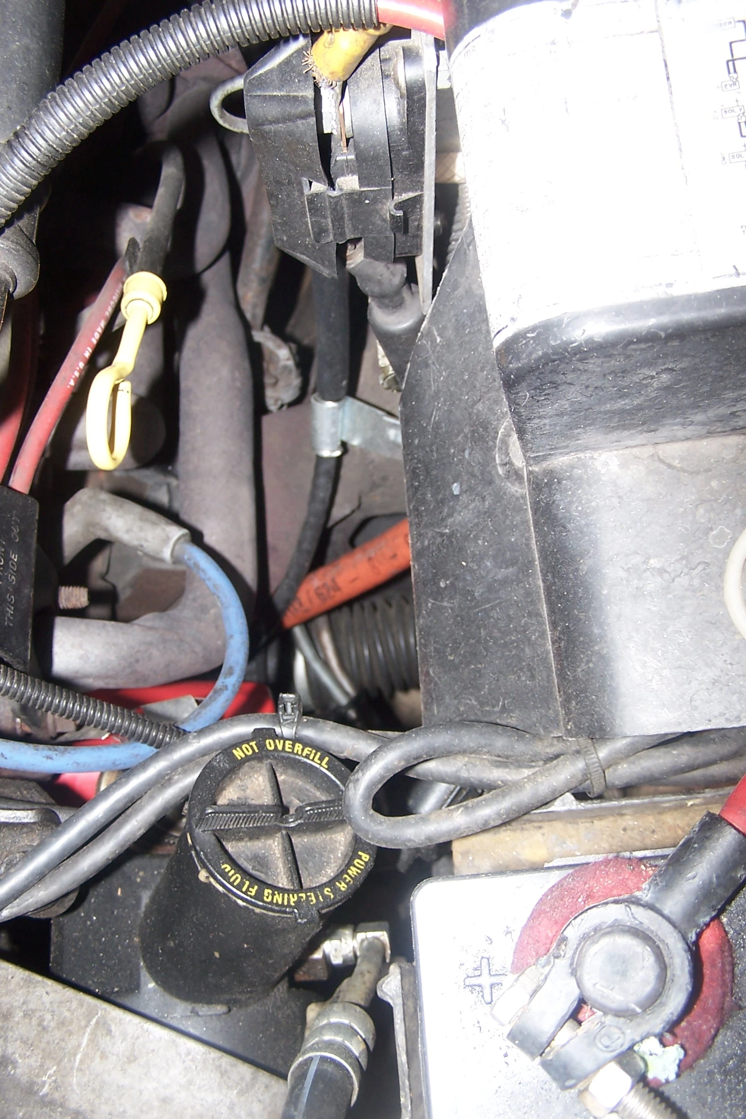

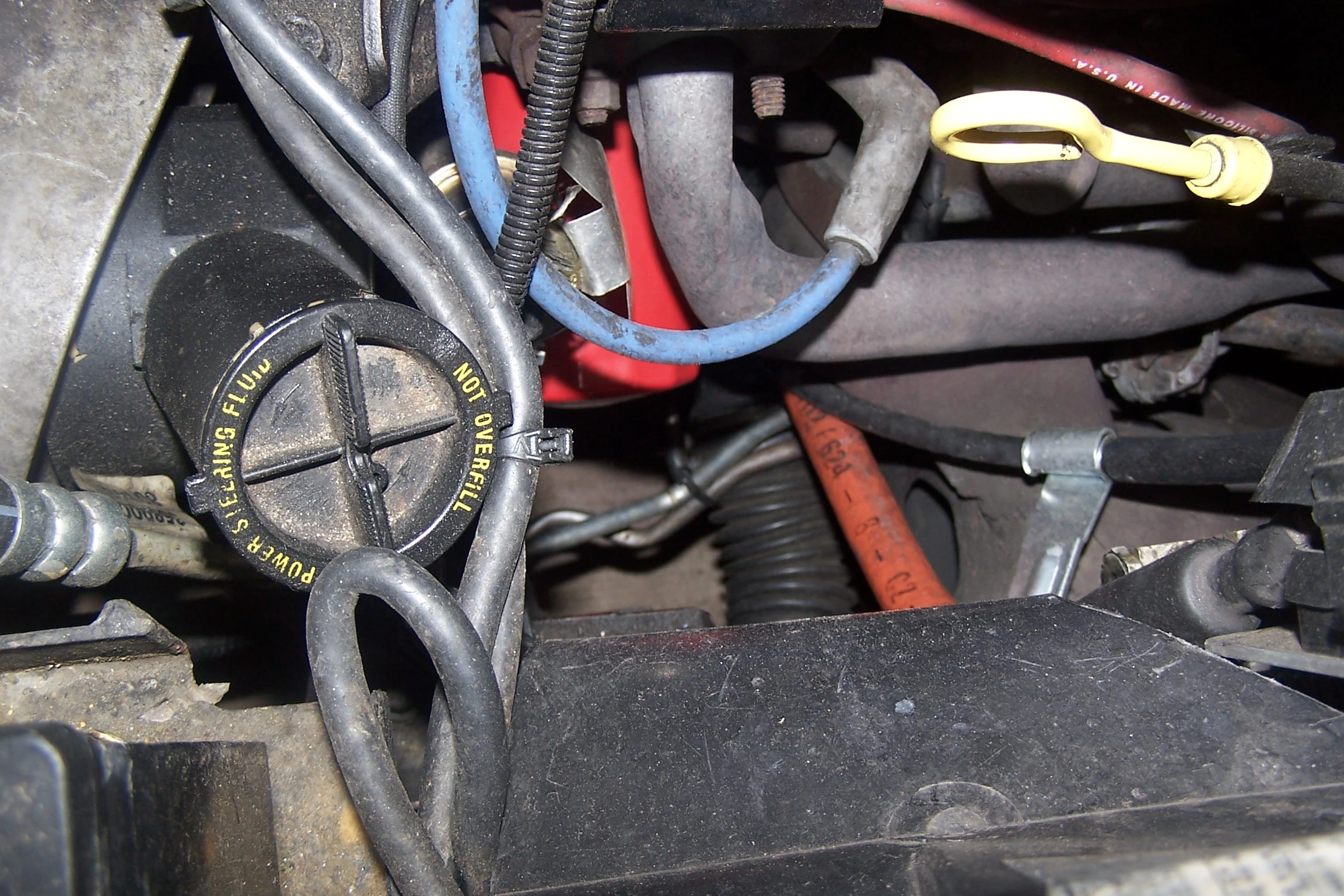

It should look like one of these ...
@demetri e
What make or model clutch quadrant do you have?
Clutch Cable Routing
