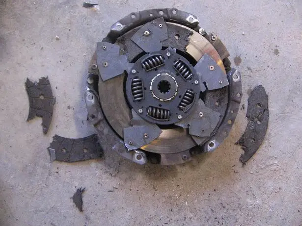

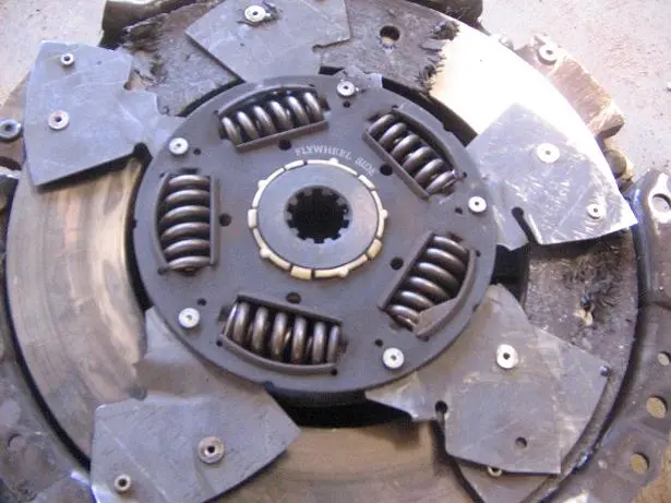

I bought a 2.1 Fidanza clutch and intalled it along with a Fidanza aluminum flywheel I had. Mine chattered a little, but nothing major. After being in the car about 6 months.........
The results are in the attached pics.
I was at the track, made a run, then came back into the pits and parked. Everything was fine. Decided to move the car over by a buddy's. Goosed it a little in 1st gear and BOOM..... all hell broke loose. Looed like the rivets for the friction material decided to stop doing their job.

It could be the springs in the disc hub that are bad. Or it could possibly have something to do with the rivets in the friction material.
Thats crazy, I am having it taken out of the car tomorrow and will take pictures and post them up of the damage. But that is unbelievable, hope it didn't damage your car at all.
Sucks that your clutch is not doing the best. Hope your clutch doesn't look like Adrocks'. (sorry adrock, that sucks). I was on the side to wait it out but I've never seen the car or experienced what you are experiencing. Looks like it is time for you to go clutch shopping.
Update
So the pressure plate was only working on one half meaning the clutch was only getting pressed into the flywheel on half of the clutch face. It torched the flywheel and the shop did not recommended me reusing the flywheel.
