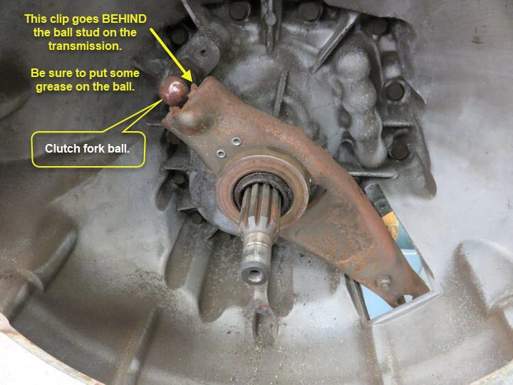

Can anyone please show me a pic of what a properly installed clutch fork and throwing bearing look like without the clutch cable seated in the fork.

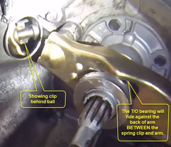

This is basically how the Ford's are installed. Sometimes easier to put the TO on the arm and then assemble it to the trans, then slide the arm back at an angle if possible to then clip the ball spring. Be patient.
