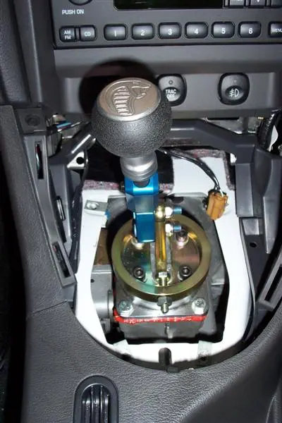

Sounds to me like you have the Blue MGW adjustable handle, not the full MGW shifter and handle. The MGW shifter was originally released with two different slip on handles, a red and blue (long & short throw). Eventually MGW did away with the two different types and went with a single orange handle.
Seems like you have a setup like my current one. I have a Pro 5.0 base with an MGW adjustable handle. This blue adjustable handle is made to replace the handle on other aftermarket shifters.
Check this pic:
You need to look at the base plate of the shifter and see if it's stock (no markings) or if it's a Pro-5.0, or Tri-ax, UPR, etc... The MGW base is anodized black and engraved with the MGW logo I believe.

yeah when i first had it it was the blue handle with the stock shift assembly.
now he says its a mgw unit with the orange handle. i can feel the handle and shaft through the shifter boot, so im pretty sure its whatever he says it is.
if i get a chance ill look at it later tonight.
yup its a MGW with the orange handle.
