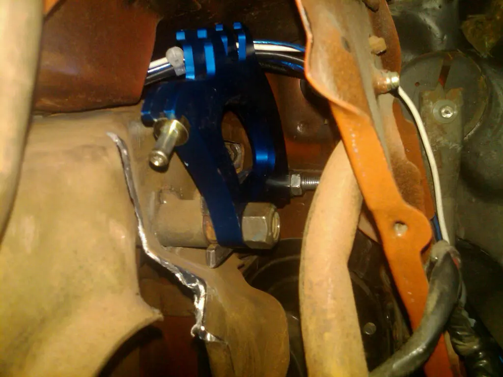

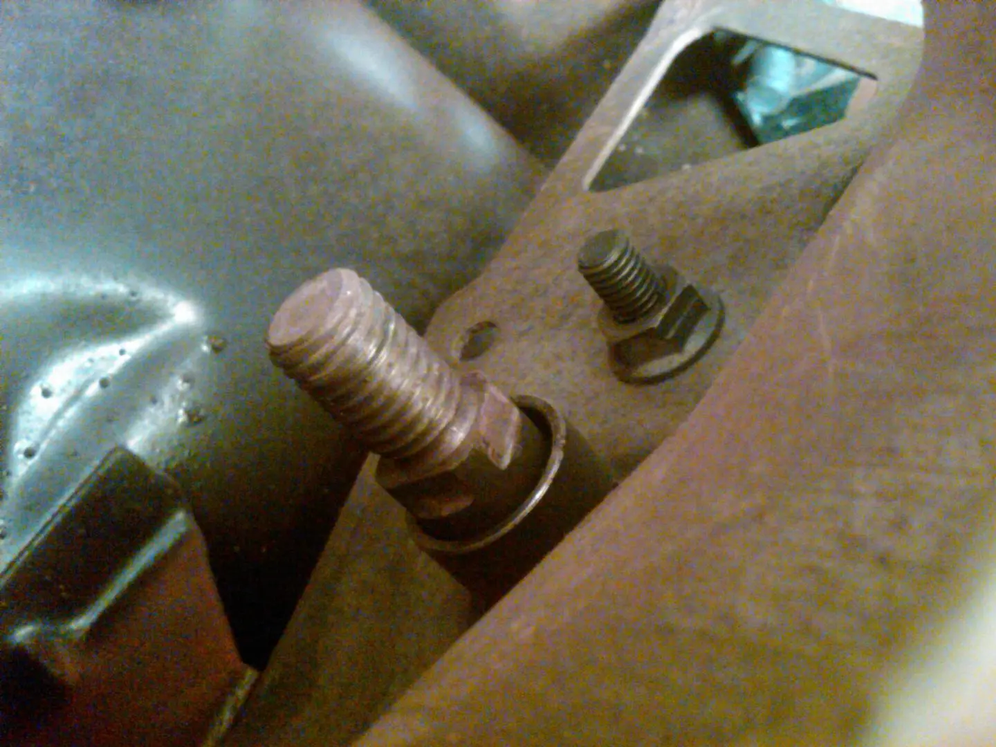

Ok well that lever isn't there. Here is the end where the quadrant should go. It looks like they took it off. God these people should not have been working on cars. How can I fix this? I'm about 2 seconds away from pulling the motor and tranny buying a 87-93 rolling chassis and taking the 80 down to work and crushing it.
What is that lever called? Please help as you have already helped alot and I thank you.

Thats odd..kinda looks like just the pedal is missing. My nut on there came loose and cause me alot of stress (in my mind) till I figured out it was just a loose nut. If that is the factory pedal assembly, the early ones are different from the 87-93 ones. They are also a lil cheaper.The 79-81 uses a really different one and I don't think you can use the aftermarket quadrant on it. You can use a Fairmont, Capri (don't take parts off of those though..I'm saving those cars) and others. I'd do a 87-93 part.

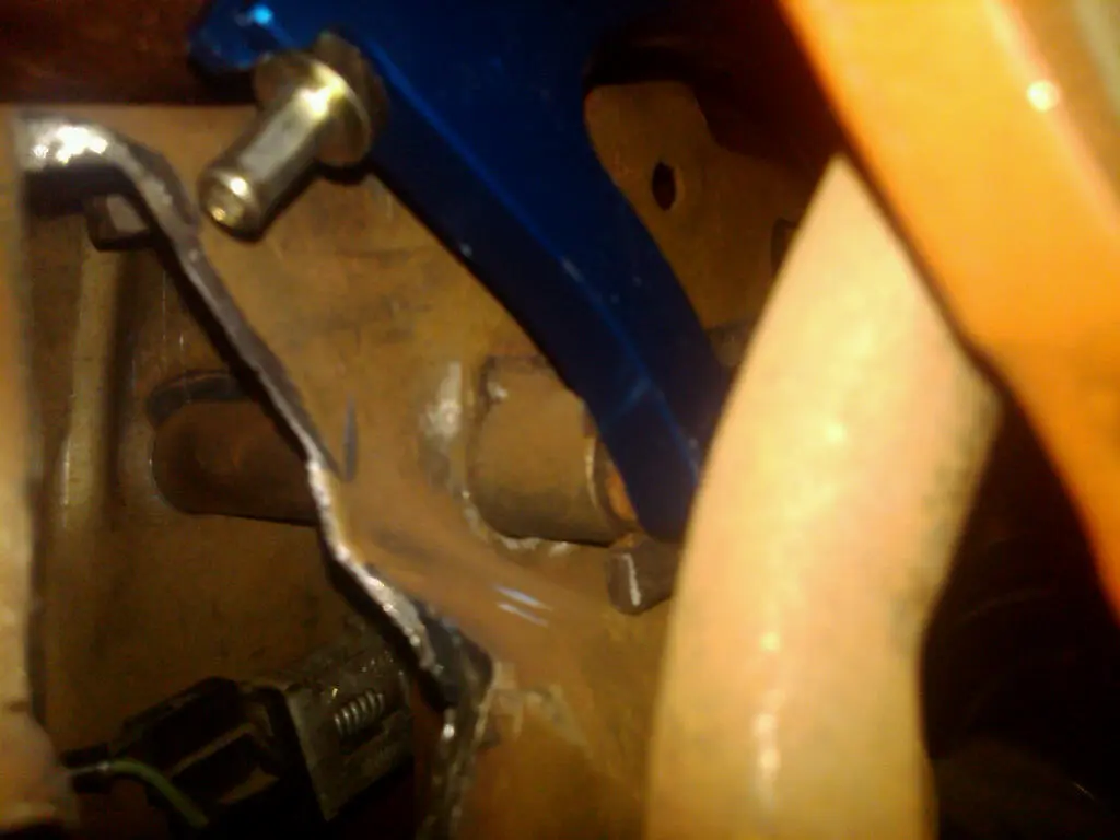

Ok here's what I got. It will work for now till I get the right pedal box. I had to cut a chunk out of the box so the quad can turn at its full.
I should have took pics before I put it back in but didn't think of it.
