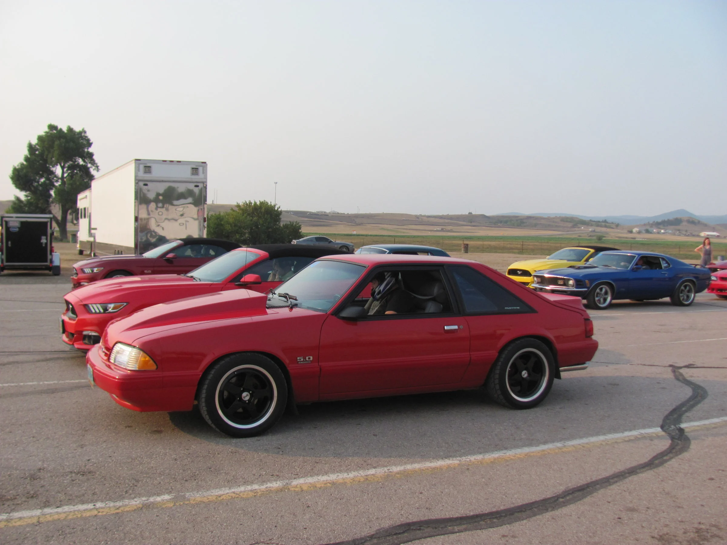

Need some clutch recommendations for my '89 Hatch. Car has a 306 with a Vortech V3 putting out 10psi. Never been dynoed, but guessing about 400rwhp. Used mainly for street and cruising and maybe 1 or two times a year at the track. I'd like to stick with what LMR sells. Something that's very streetable but will hold up when occasionally having some fun.
