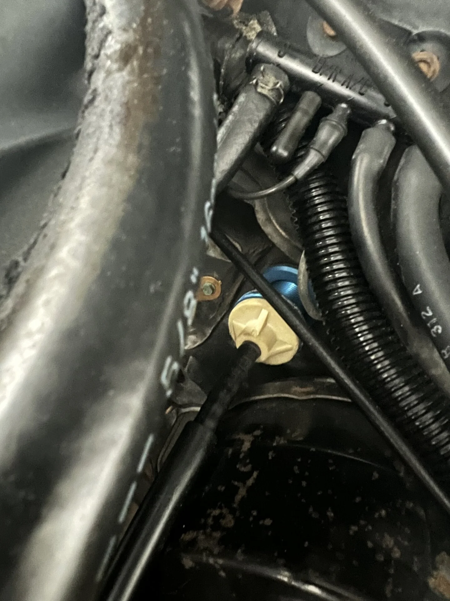

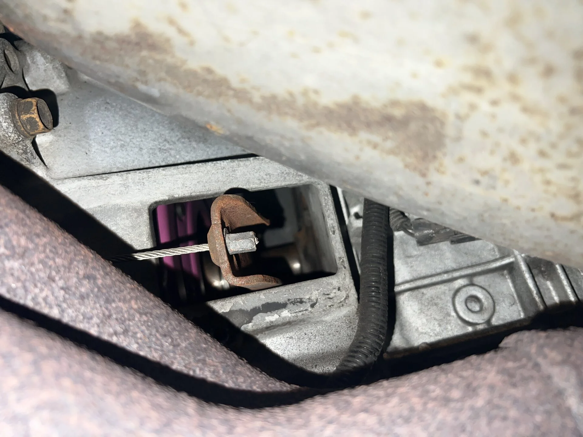

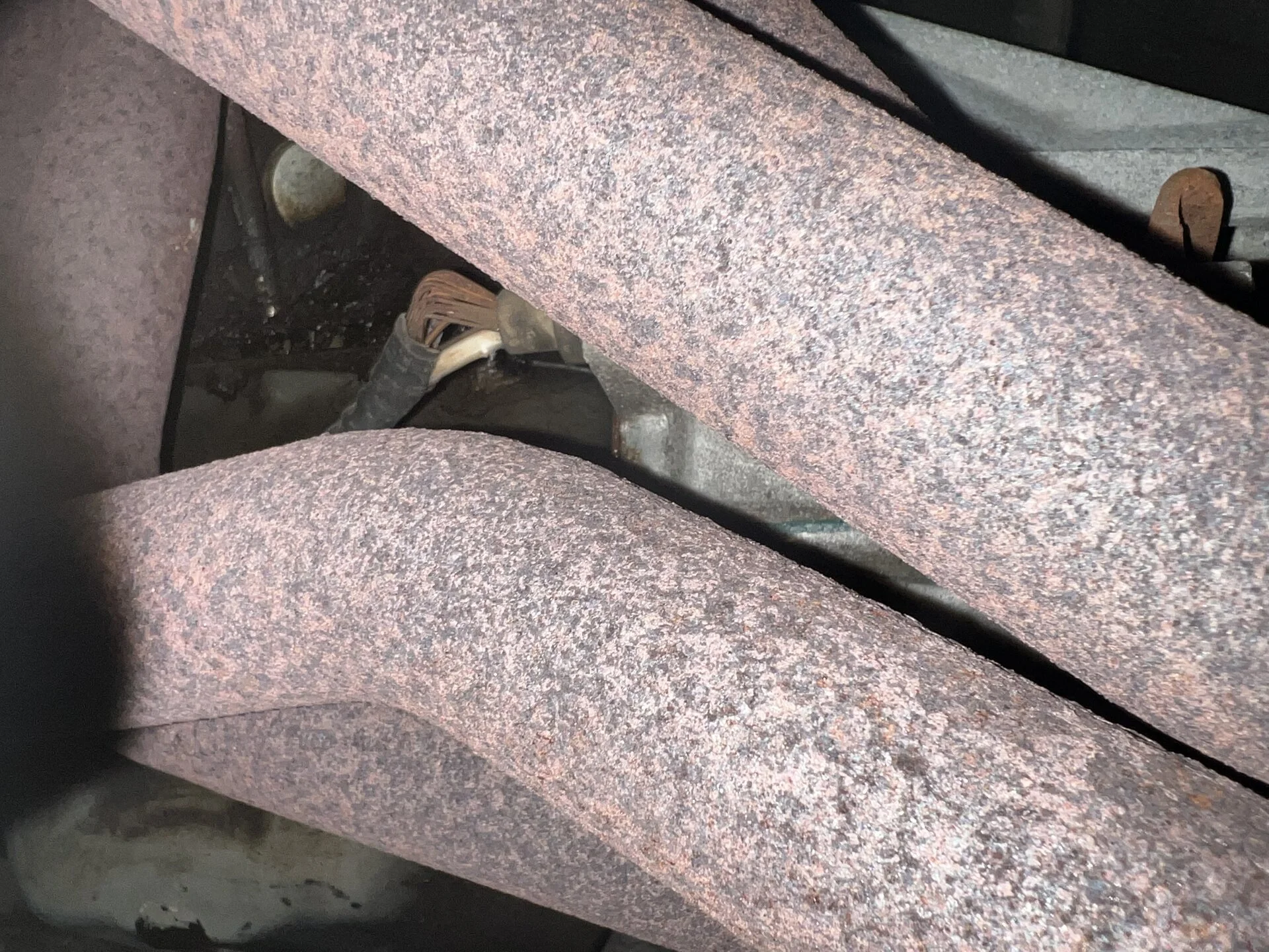

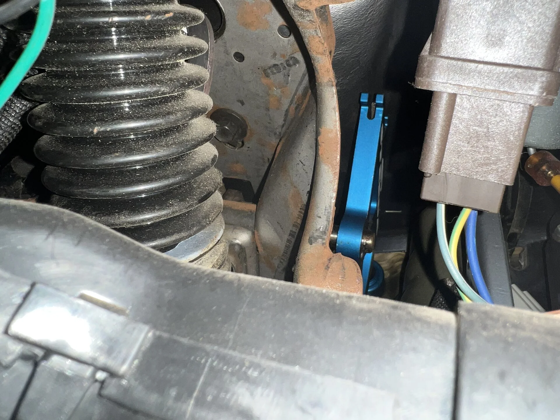

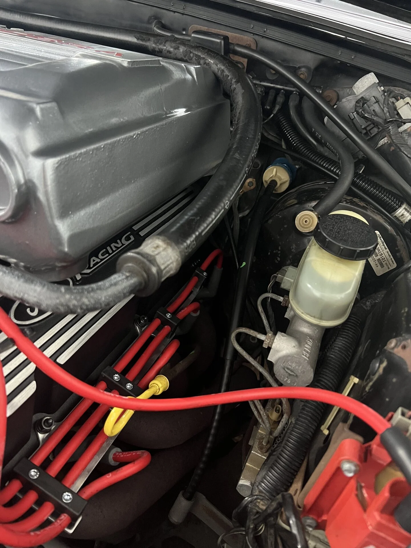

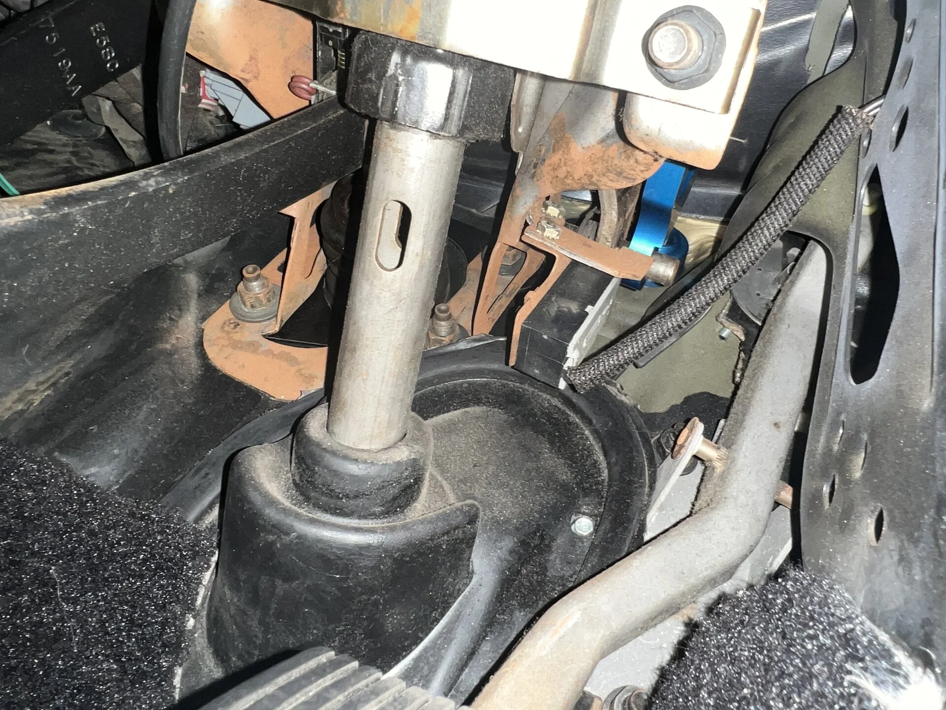

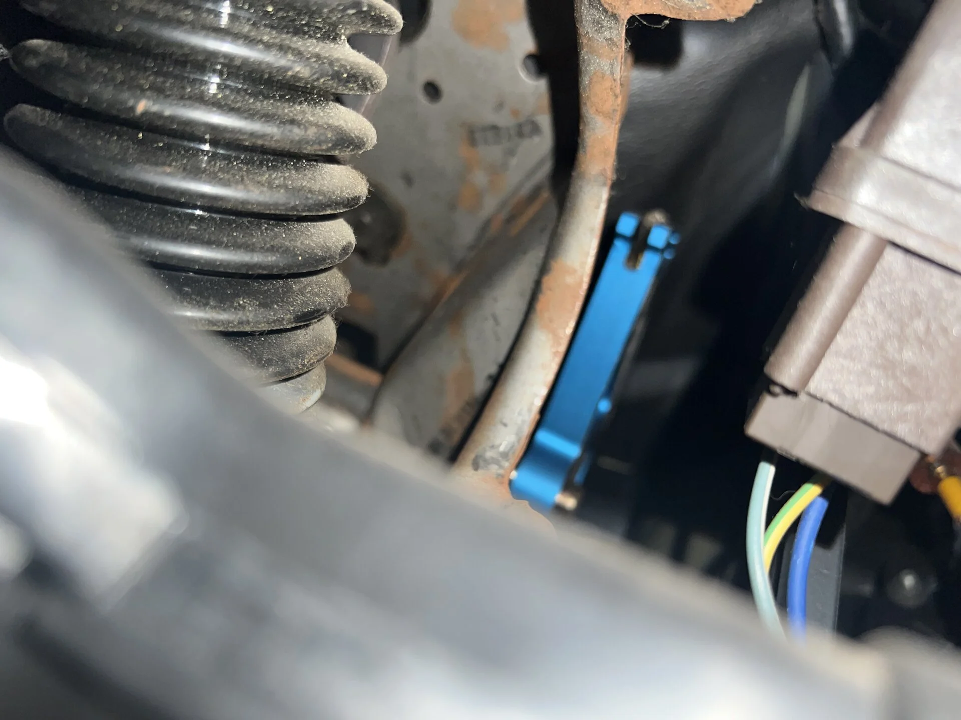

What other information would be helpful? I just bought the car and the previous owner wasn’t the one who modded it so I don’t know much about what has been done to the clutch system. As stated before it has a steeda quadrant and firewall adjuster. I’ll post pics of everything. BTW Thanks for the help everyone.

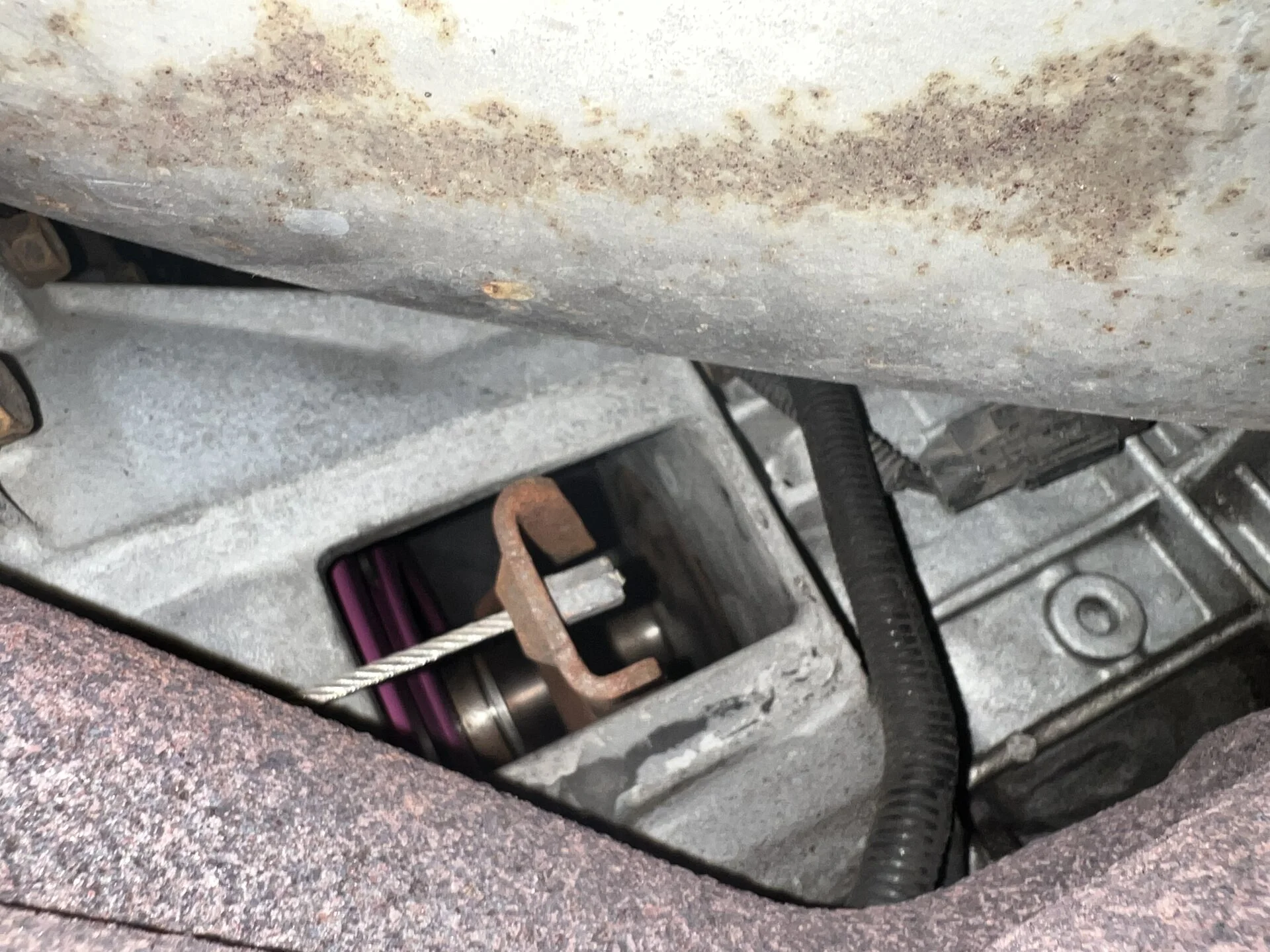

I think I found the issue I was taking more pictures and check out how the cable looks where it attaches to the trans.
